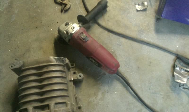

Somehow I was an inch off on my measurement on the length of the case. Which means the bypass valve isn't going to line up by about 1.5-1.75". I have an idea though.
I just about got the sides trimmed down enough to squeeze it into my bay and check things out, but then my angle grinder gave out on me. You can see the smoke.
I am so close, yet its the little things I need to clearance now. I've had it in and out at least a dozen times.

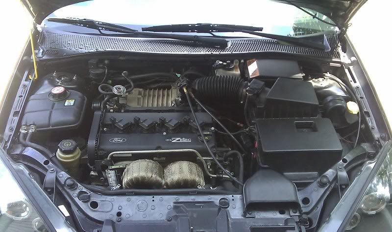

Well I got her in and hooked up minus the bypass valve. I blocked it off and started it. I had to keep revving it to keep it in boost without the bypass. And it sounded bad. I knew the coupler was bad, but not this bad. Looks like its gonna need a rebuild before attempting to run it and no time before FF.
Best run from today. Still on all seasons.
I still dig this thing :icon_thumby: I do have to ask, how much of a pain is it to work on? It looks like everything is mighty cramped in there, but you seem to swap things around without giving it much thought. Are the photos just decieiving on how cramped it is in that engine bay? Or?
I can pull the blower off and reinstall in 30 minutes. But I literally have to lay on the motor to do it.

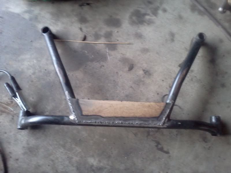

Added a gusset while it was out.
