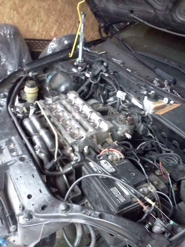

Took forever, but I finally got all the buckets in spec. At this point I can't even read my own writing.
Fresh coat of paint
Since the head is assembled, I decided to see how much clearance I have. With a crushed Zetec head gasket, I have about 45-50 degrees of rotation before the valve hits the piston. But I will be using an SVT HG for now.
Yeah I have a couple lol.
Got her all together and she turns over, but no fire. Going to have to investigate that next week.
