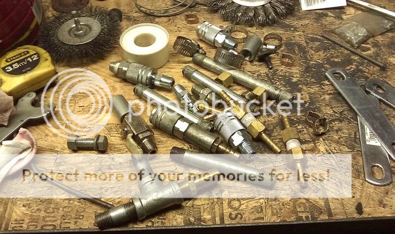

I couldnt find one at lowes home depot etc i went to a pump store like water pumps etc they sold pressure switches for 23 bucks. Told the guy what i was doin he said water or air it dont matter has the same pressure. He told me know to tune it so it turns off at 85 and back on at 65. Im gonna bump it to 100 soon as i get my tank mounted underneath.
What are you goin to use for an oiler? Some people i know who done the same say just squirt a few drops in the inlet if you dont have an oiler. they been doin it for years
I didnt find a cut off, but I found a regulator at Lowes. Planning on dropping some tool oil in the inlet side.

Idealy if you have access to a mill or know someone that is, is to have the back of the block that bolts onto the air pump, machined flat and have two holes tapped so you can just run some 1/4 or 3/8's brake line to your tank or cutoff switch. Then it looks more pro and functions more pro and takes up way less room.

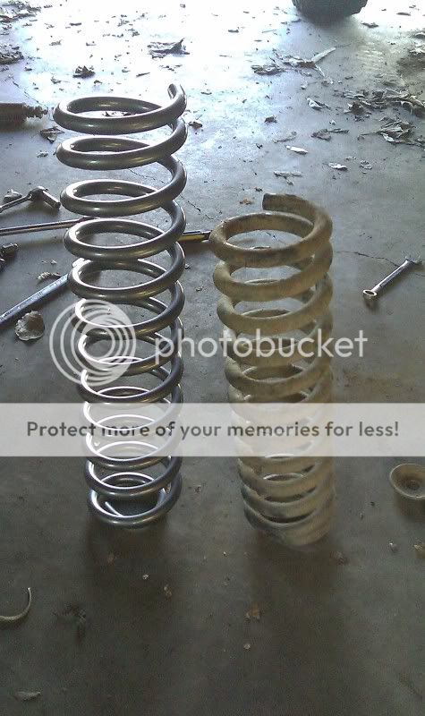

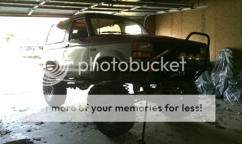

XJ coils in. I ended up cutting a little more off than I wanted to, but I finally got it back to the right height with some washers. Now my shocks are not only shot, but are also my limiting factor.
This is with the shock fully compressed. Still has more to go, but its already much better than before.
