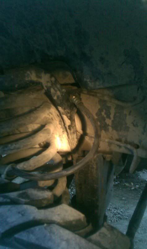

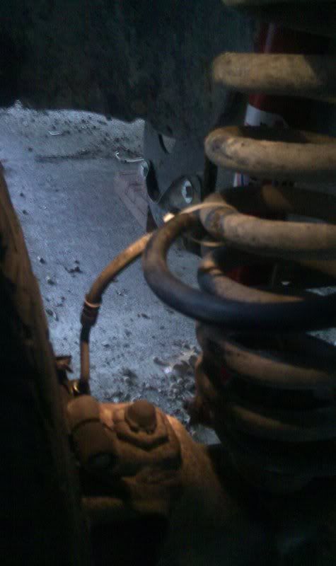

do you have any pictures of the extended brake lines you got from autozone? id like to see them.
I will shoot one with my phone and load it later.
sounds good man. thanks. good luck with the build.
Here is the passenger brake line.

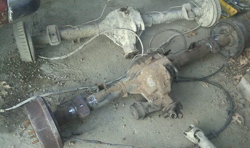

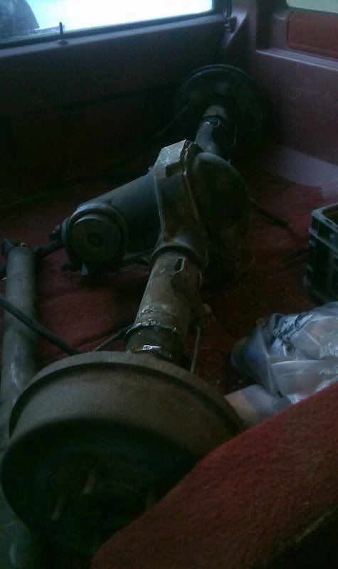

8.8 in and almost ready to drive. Ran into some driveshaft problems. I am hoping I don't have to have a new one made.
Both axles together.
