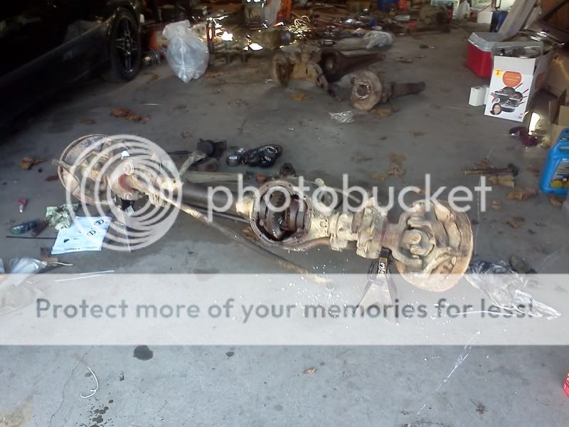

For those of you who don't have me on FB, I have joined the dark side.....

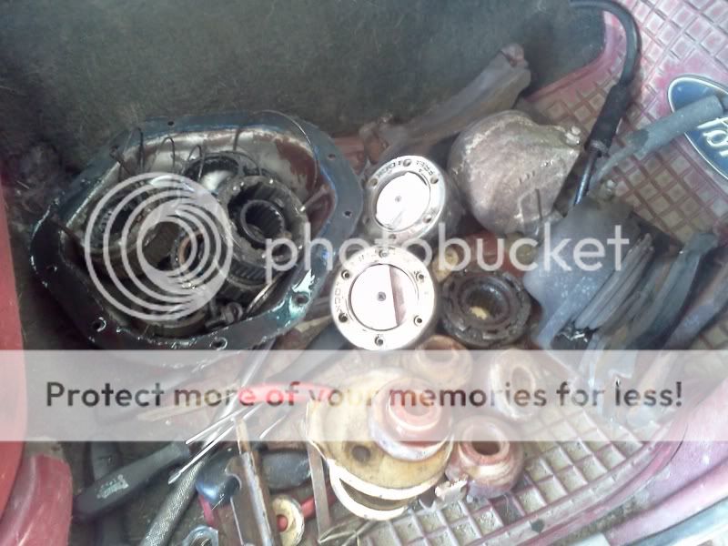

Brakes, diff cover, manual lockouts, and Energy Suspension bushings.

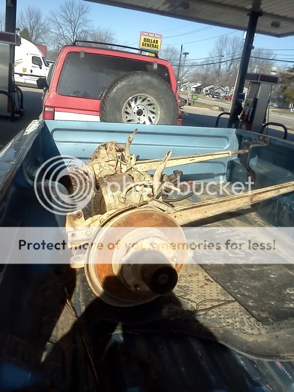

Now let me do some explaining. I went for some 44 parts to do the outers and came across this. Walked by it, but then I got curious about the gearing. A little counting and some division and wouldn't you know it, 4.56s. So there it began. and a few hours and $200 later I got this thing in my trailer.
If it wasn't for the gearing, I wouldn't have even bothered, but I figured for a little more than I was gonna pay to do the 44 outers, why not.
Hahaha. So you did get it. I knew it wouldn't take long for you to SAS it.
But like he said, if it wasnt for the gears, it wouldnt have happened. I will say that is a nice find and worth the $200.
So are you keeping her FW or going to narrow her? If narrow then your rear is good and only needs a set of adaptors to fit 5.5x5.
Think I'm gonna leave it and get some spacers for the rear.
