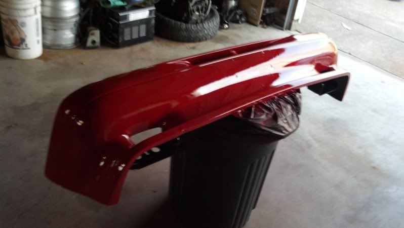

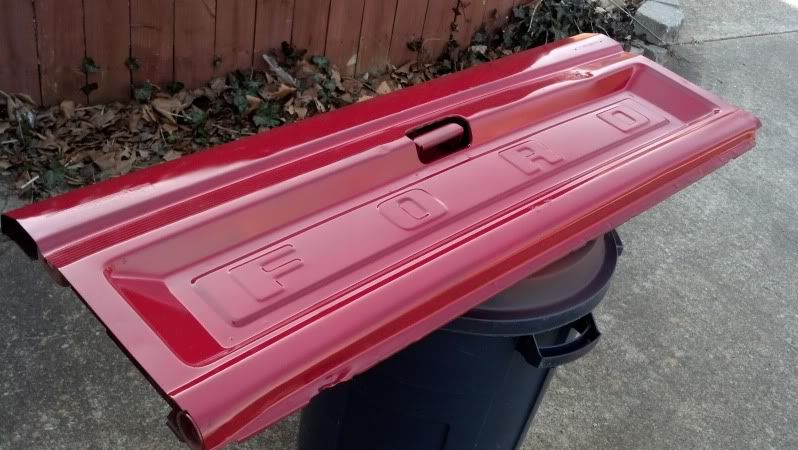

Did some painting today.
disciplerocks's 91 Ranger build thread
Looks like it came out nice...i need to get on mine lol

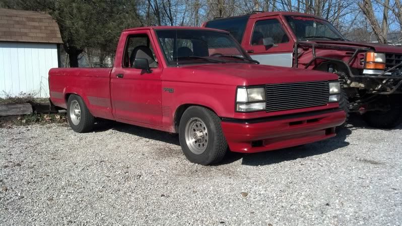

One next to B2.

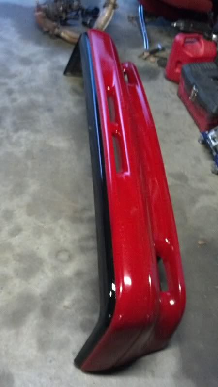

And one after installing bumper.
Looks great.
