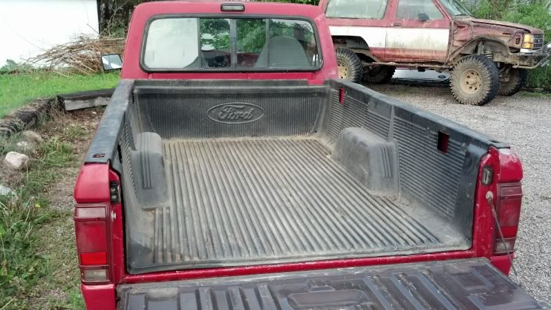

Finally found a long bed liner.
Those rot the bottoms of the beds out, hooks the moisture under them.
Sent from my rooted SPH-D710 using Tapatalk 2
Look what i found under my new rangers bed liner. i though the squeak i was getting, was from the tool box. Nooope
Thanks to any and all city/state governments for using salt on our roads in winter. And whoever designed these.
Drop in bed liners are good for some things. They do protect the metal from impact much better than a spray in liner.
I have had a drop in liner in mine since it was new. I need to take it out and look soon. I have to admit that I am fairly scared about what I will find.
