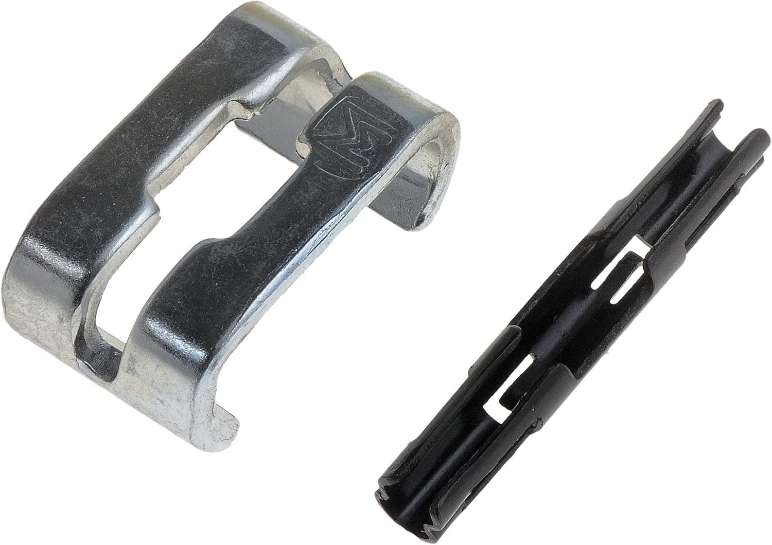

i  can probably reuse the rears, if i can get them out intact. its the intermediates that are truly screwed. and the strange connector adapter between the front and intermediates, havent seen anything that looks similar in the rock auto parts so far. unless it comes with, but isn't shown..
are there any other vehicles that run the same ebrake cable hardware as the 10-11' rear disc rangers?
Are you talking about the piece that looks like the black clip in the picture below. The piece that the front and intermediate cable ends clip into? If you order an OE Ford intermediate cable, I think it comes with that piece. Pictures of intermediate cables on the RockAuto site look like they come with it too. The one in the set pictured (Dorman 21126) might fit and work, but you'd have to try it and see.

nah i was wrong in my terminology, its a piece between the intermediate and rear inners. the piece that joins the 2 into 1.
