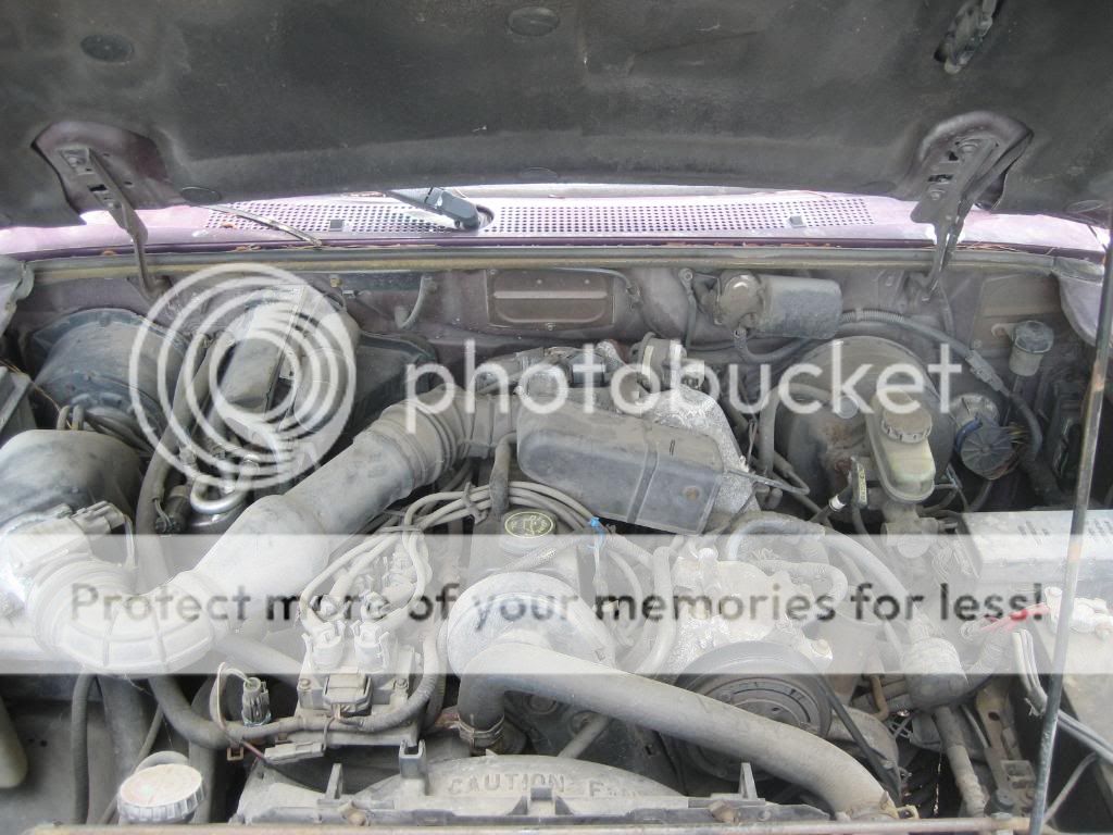

Since it was a nice day today, and my truck's engine was FILTHY, I decided to give it a shot. I unfortunately did not take any before pics, but let me assure you, all of the black plastics were easily mistaken for brown. Look at the underside of my hood in these pics, it should give you a clue as to what I was working with.
Since my engine was so dirty, I did this twice. About 90% of the cleaning was done the first time. Since I had the time, I wanted to see what kind of results I could get. The second time, I used some brushes (new paint brush, tooth brush) and a rag to get into the small spaces and get the built up gunk off. While I was waiting the second time, I busted out the vacuum cleaner and did some much needed cleaning of my interior.

Just got some today gonna clean my engine bay saturdat will try and post pics before and after.
Before:
After:
