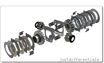

Limited Slip: AKA Posi, Positrac, Positraction, Positivetraction (all of which are GM terms for their brand of l/s) tracloc/traction lock (ford's brand) or anti spin (mopar) these usually use a series of clutches, that does not allow the 2 wheels to spin at different speeds, until there is a difference of a set amount of torque, on my mustang i believe it was 13lbs. upside: far superior traction over the open differential, as you have all drive wheels turning, so you will have double the traction. allows the wheels to spin at different speeds when driving on the road (for going around corners) downsides: clutches wear out, and eventually it will loose it's grab, and act like an open diff. not a full locker, and can cause 1 tire to not have power if the difference in traction between the wheels is great (ice on 1 tire, pavement on another)
the s shaped spring is designed to put pressure on the clutch disks

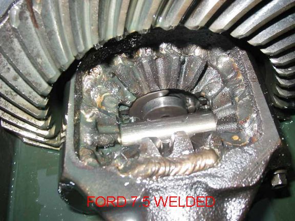

Lincoln Locker: very similar to the spool, in all of it's abilities and performances, although, it is a home made spool, made out of an open differential, by welding the spider gears together to not allow them to turn, and let 1 wheel spin. upsides: all of the same as the spool. Cheaper than a spool (not by a considerable amount) downsides: all of the same as the spool, plus has a larger likely hood of breaking, due to the parts weakening due to welding in the diff. if the weld were to break off, due to poor penetration, it causes slag to be in the fluid which works as an abrasive and can destroy meshing gears. Typically stock open differentials are not designed to handle the same torque put through the axles as an aftermarket spool, so is more susceptible to failure
