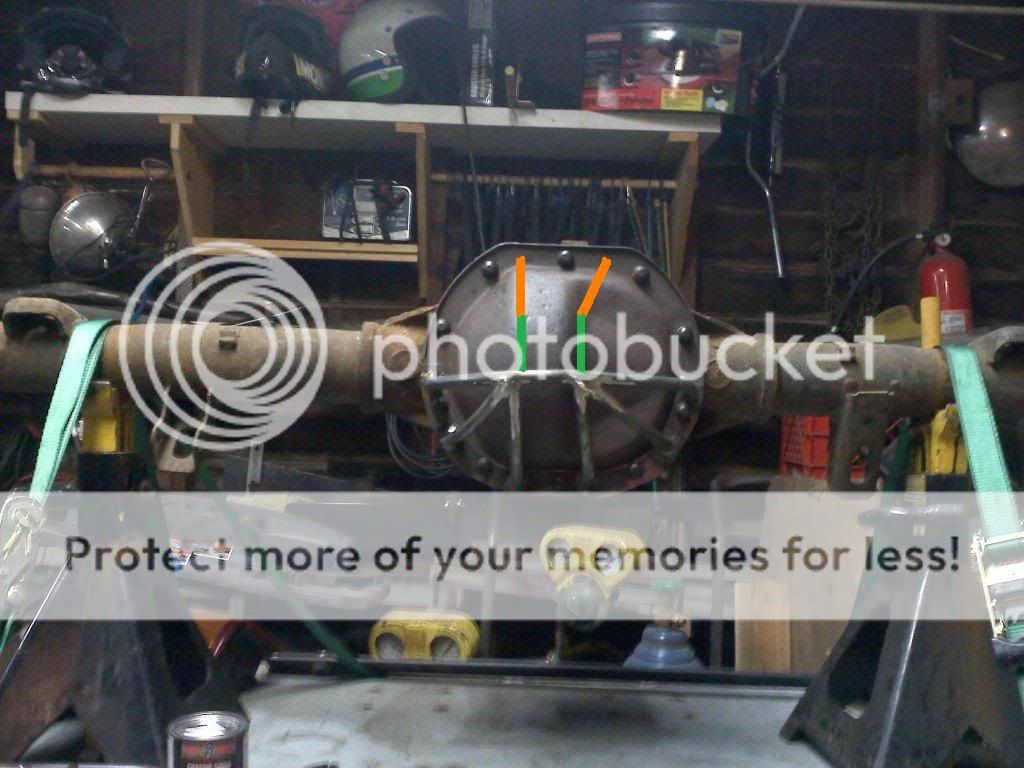

last night i made up a bash guard for my new axle so im just posting it up here for feed back. let me know if you see something i should change before it makes it to the paint stage!

More for aesthetics than anything else, add some horizontal bars [follow the outside edge] to make it look somewhat like a spider web. Maybe use some 5/16" bar that's curved slightly.

thats what i was thinking, at least between the two vertical ones on either side of the ring gear. this was all brought on by me almost backing into a rock while trying to hook up to a trailer. that was when i had just rebuilt the axle that is currently in the truck so i wasnt about to take it back out to build one so now that im building another axle i figured i might as well make one this time.

The only thing I'd do is put 2 more bars from the top to the cage to brace it. Since, if you were to smash straight down onto a rock, the force could bend up the flange surface(s) where the bars are welded. Then it would cause diff leakage.:sad:

Something like this would help out a bunch.
well the rods are welded to a plate that bolts on over top of the cover, i had to cut the lip on the cover in the middle and then pound the lower portion of the flange out flat so that the guard could bolt over top of the cover. did i make that confusing enough?
What you're saying is the guard is separate from the cover. That should work to prevent what Iron Ranger was worried about.
Oh ya, I didn't see that part! :icon_twisted: It looked like it was welded right to the diff cover.
No, no. Never mind what I said. Your system will work perfectly! :icon_thumby:
