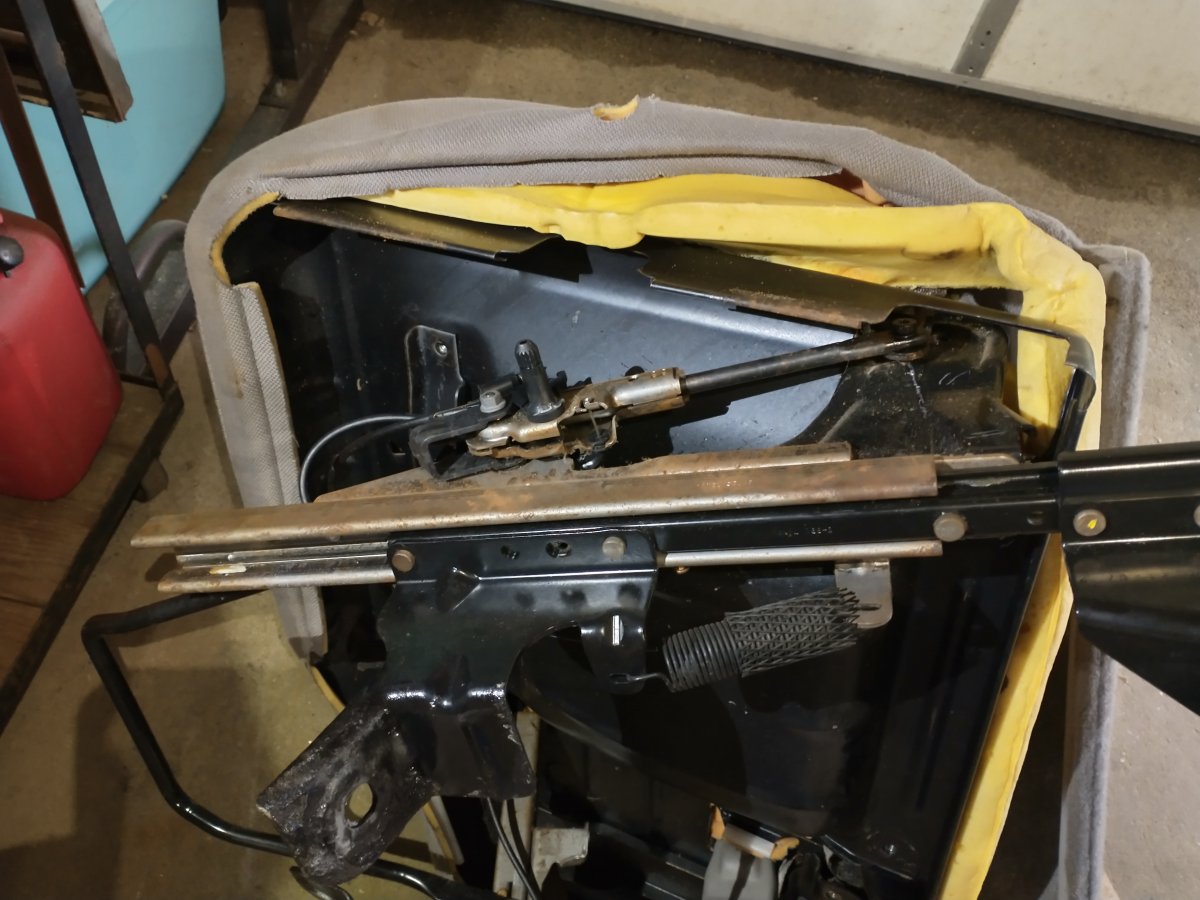

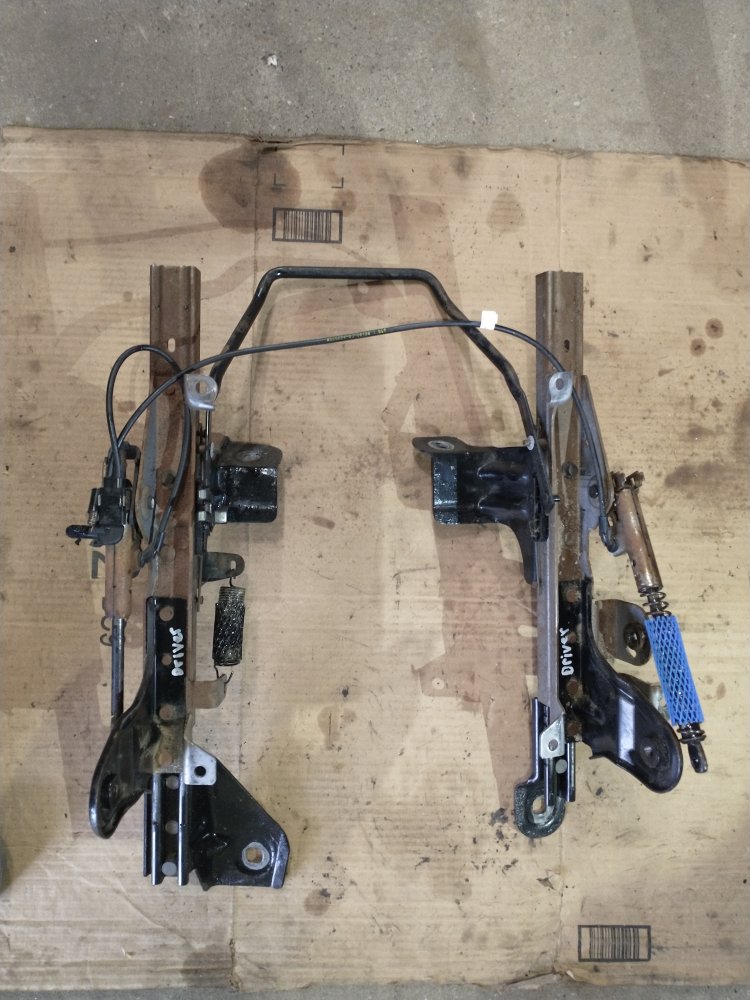

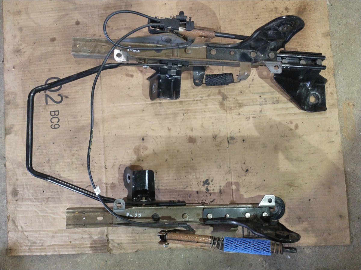

I'd like to do a seat swap in my 1998 standard cab Ranger, and I read that I need to use 93-97 seat tracks because the seats can be unbolted (while the 98+ seats are fixed to the tracks). However I recently removed my 1998 seats and found that they are also bolted to the tracks (not fixed/riveted), and I was able to unbolt them from the assemblies.
Can I use my 1998 seat tracks for a seat swap, or do I still need to find 93-97 seat tracks because of other differences (size, dimensions, etc) compared to the 98+ seat tracks? Thanks

The seat back reclining mechanism is part of the 1998 seat tracks (see pics). Do the 93-97 seat tracks also have the reclining mechanism as part of the seat tracks, and if not, would having this in my 98 tracks cause a problem when trying to do a seat swap from an Explorer, Mustang, etc.?
The reclining mechanism is part of the seat on 97 and older trucks and NOT part of the tracks like on yours.
