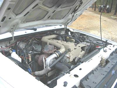

as you can see, there arent really any space savings to be had. the 4BT is a hog:
Diesel Ranger
not to mention the added weight.
more info here:
http://www.therangerstation.com/galleries/Explorers/DieselExplorer.htm
hmm...i see 7 more inches of unused space in that pic...with a radiator under the core it wouldbe a bit more roomy, a 3.3 would look tiny in there.
