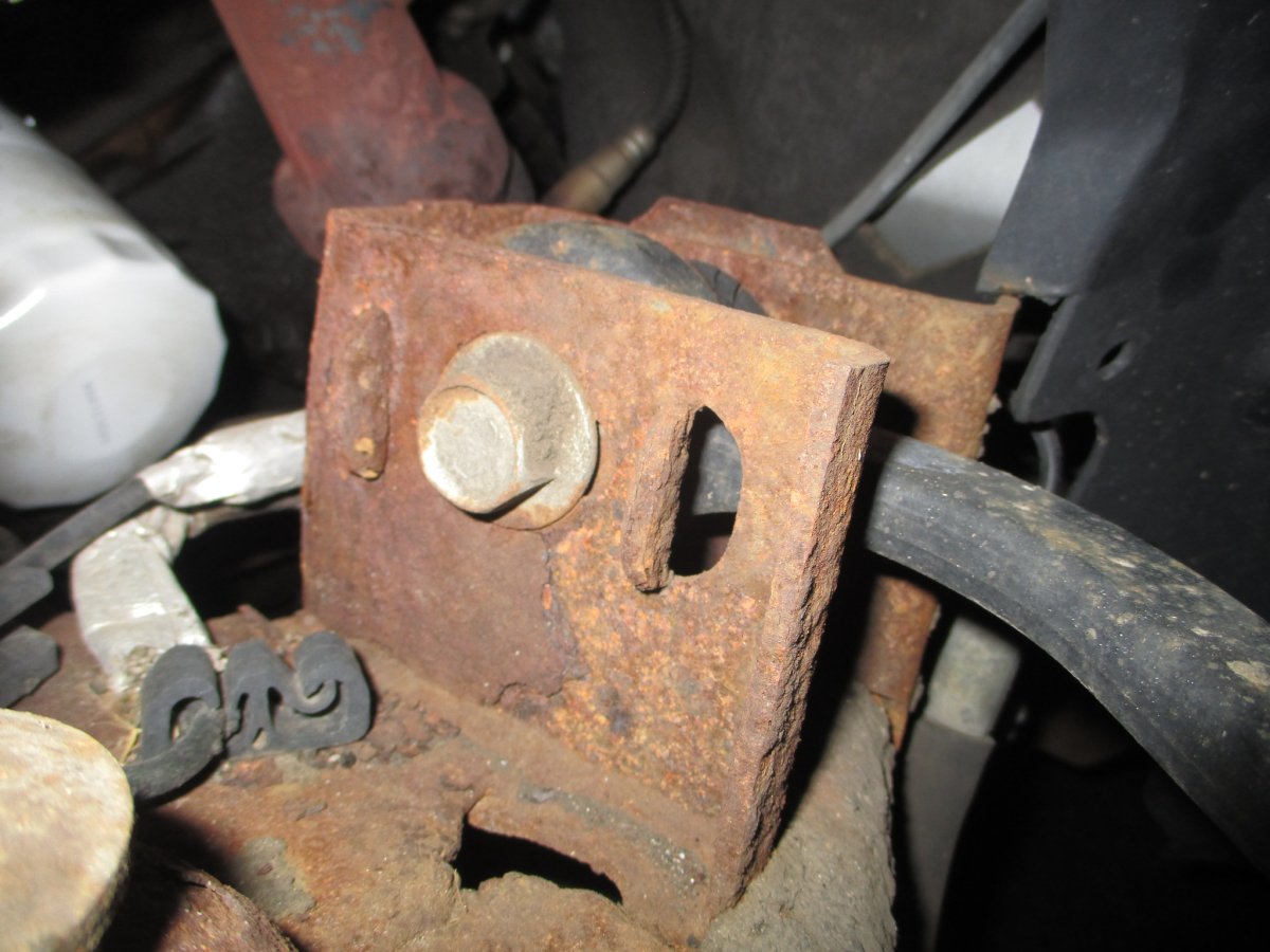

Other front side is OK, no wobble, but has the same situation with camber bolts possibly missing those round tab things. Neither control arm looks new'ish so maybe it wasn't removed/replaced.
I watched like 10 youtube videos on changing a Ranger control arm but they all have more complicated camber bolts, I still don't understand camber bolts but hopefully mine is 'Fixed' and it doesn't matter, if so, why even bother with the other styles? Only a couple videos have something similar with fixed bolts with no adjustable round discs/washers or anything to line up or pre-mark location, but not exactly what I have. Maybe I haven't seen the exact same because the 3.0 liter 6 cylinder is rare.
I only have a bolt head on one side, the other side with the nut has a flat disc which locks into position between two tabs on the mount.

one of my Rangers came with the square camber "adjuster plates" from the factory.
there is a whole set of them with the holes displaced more in each different one.
those plates don't adjust the camber, they lock it in.
when the truck was manufactured the camber was set, then the plate that fit was installed to lock it.
yes the bolts should be tightened with the weight on them.
there are no moving parts at the bushing, it's the flexing of the rubber that allows the arm to swing.
so you want it "centered" to where it will deflect equally up or down.
they can be tightened with the wheels on, remove the rubber flap if you have to.
I'm not sure I would trust the pic from AZ, I suspect the washers are off-set to facilitate adjusting.
I've used both round-offset and oval-offset camber adjuster kits. when you turn them opposite they also adjust caster.
and that torn boot is for your steering. it is the one that turns the gearbox when you turn the steering wheel. the boot probably was just to keep dirt off the joint.

Thanks for the replies, seems I should just reinstall the same square locking plates and then take it for an alignment.
