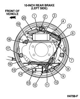

I did my brakes this weekend and everything except the drivers side parking brake wire is fine, I think. Because the truck was bought used and probably had brake jobs y the previous owner, I'd like to make sure that putting it back the way I found it was the correct thing to do. I'd like to compare it to the actual ford diagram. 2004 Ford Ranger XLT 4.0. Would anyone have or know where to get this?
I did mine on my 04 w/ 10" brake axle about a month ago. Hope this helps
