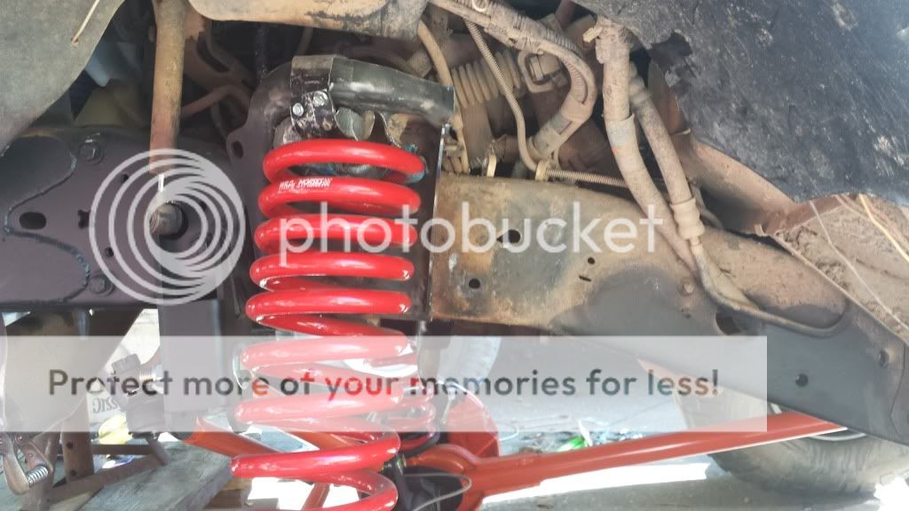

I believe it is at least a couple inches further forward than stock. I tried to go further, but steering and clearances wouldn't allow me much further, and I am quickly running out of time for massaging..
Did you modify your coil buckets for the fullsize coils? I recall someone else having the same issues maybe swap over to a bolt on bucket from bronco graveyard for those springs
I did modify them a bit, but it probably would have been a better idea to just swap to a different bucket altogether...

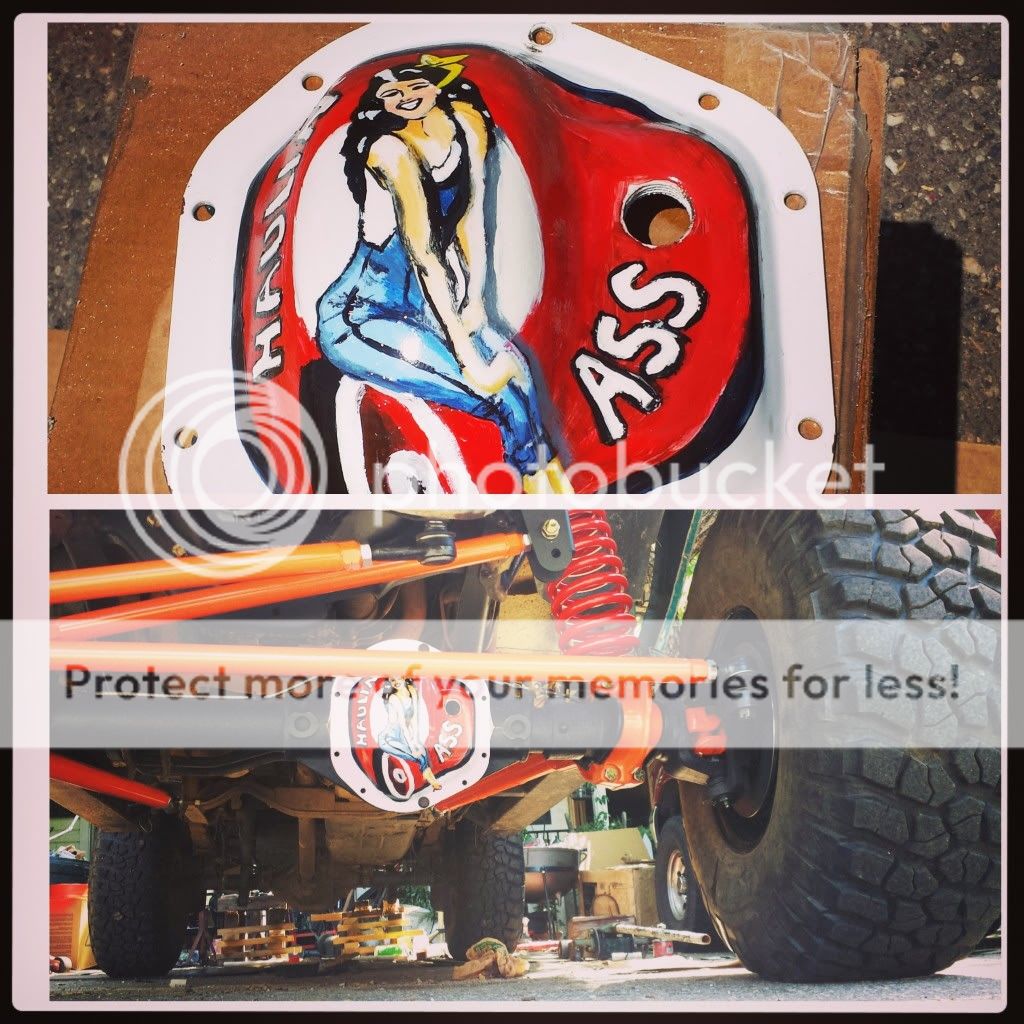

One of my friends offered to paint my front diff cover, and I think it turned out sweet

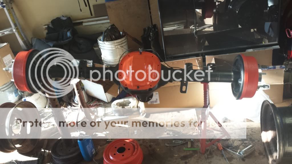

Modified my rear diff cover and finished up a bunch on my rear axle (new brakes, new brake line and brake cylinder, etc)

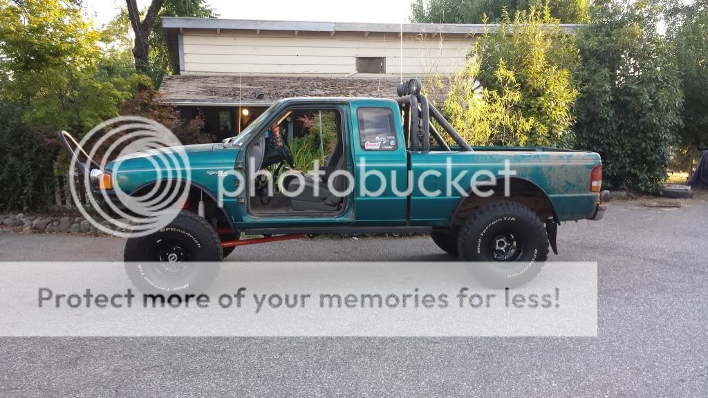

Then got it smogged

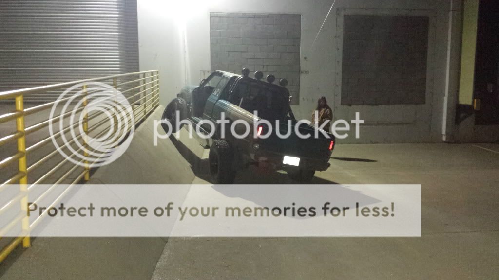

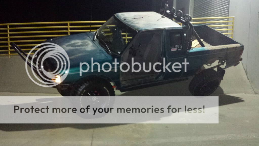

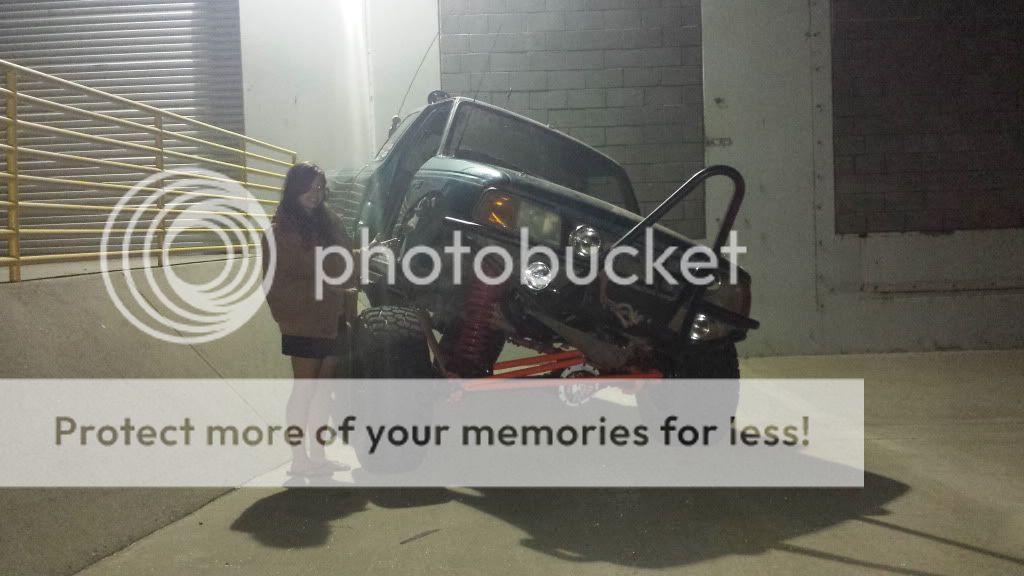

Then took it and flexed it out a bit
dhkonrad's 93 ford ranger

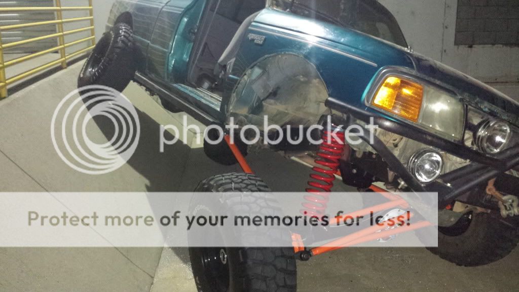

Doesn't flex out very much with front tire in the air, because the explorer springs don't flex for much, but rear tire in the air did allow it to flex easier.

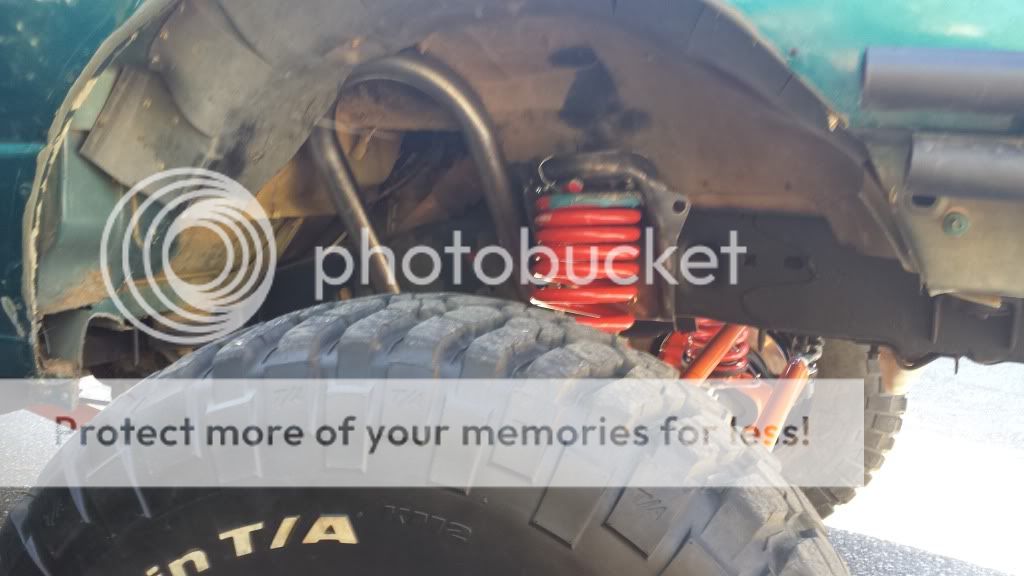

it stuffs the tires pretty good as well. I think more fender trimming may be needed

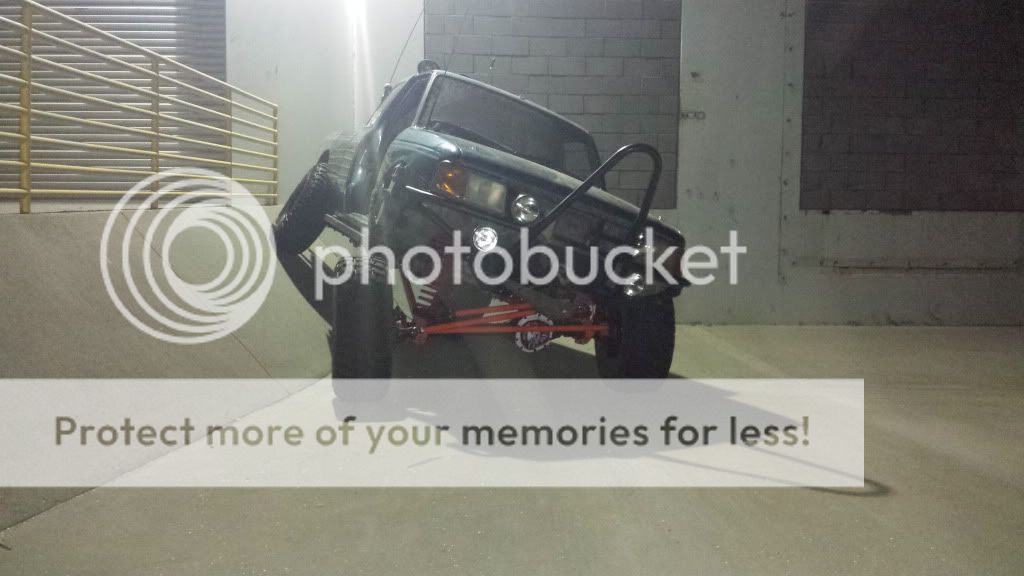

A little perspective for flex

The coil did pop out of the lower bucket right at that moment though:
I think that a little bending of the inner part of the bucket will fix that however, so I'm not super worried about it.

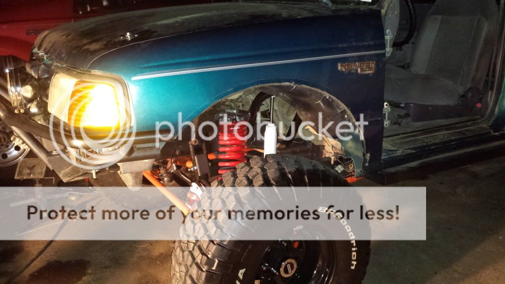

Started cutting up my coil buckets, and doing some major inner fender trimming so I can clear some shock hoops
Cut up passenger bucket as well

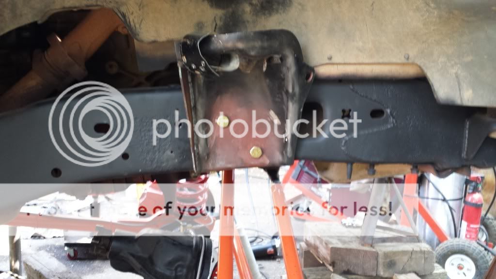

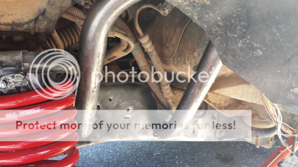

Welded up drivers link mount
Im kinda thinking about doing another pass between the frame and it, but I had the heat turned up pretty good and I'm pretty sure my pentetration was pretty good so ill probably just leave it for now.
Your frame needs to be boxed there, and a crossmember wouldn't hurt.
Otherwise that mount will just roll the bottom of your frame up.

You need to box you frame bra.
Its on the list to do, and I already have ideas in my mind for a crossmember, I just haven't gotten around to it because I leave for school on Wednesday, and I just need to get the truck streetable because it is my DD. I feel dumb cutting so many corners, but it is what it is I guess.

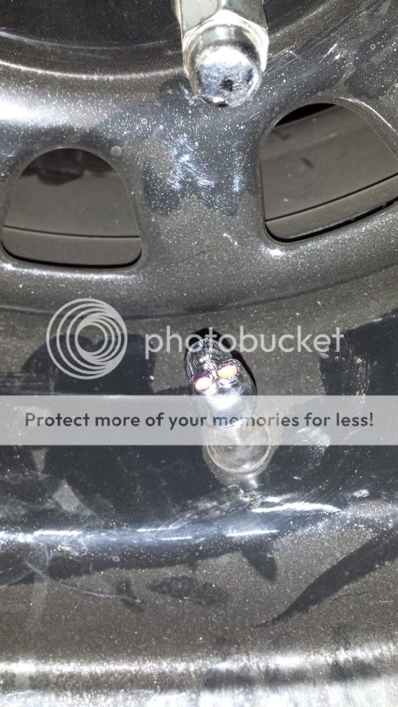

Also randomly got some sweet valve stem caps

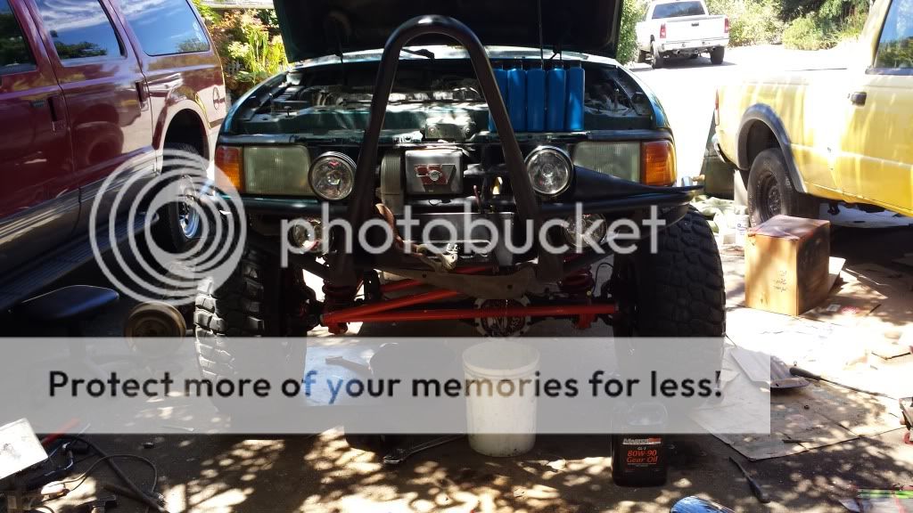

Changed my oil, changed coolant and bumped up my coolant mix in preparation for cold winters in Boise, Idaho, and filled my front diff up and locked the hubs to get the front broken in.

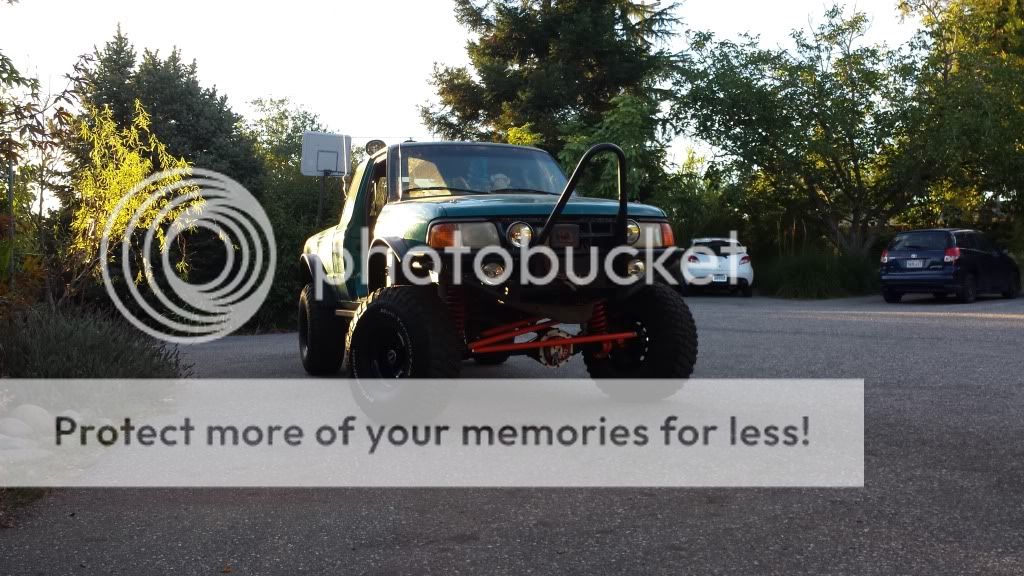

Then backed it out and took some pictures. If you have a phobia about lots of pictures scroll fast...
I feel almost giddy driving it around town. It is so much easier to drive than TTB, its rock solid going around corners because of the width, even with no sway bars front or rear, its just an utter blast to drive. I feel like I just got a new truck.
