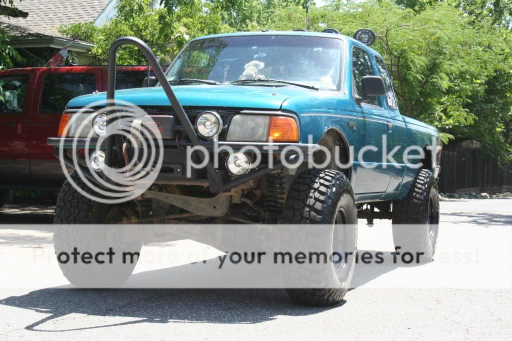

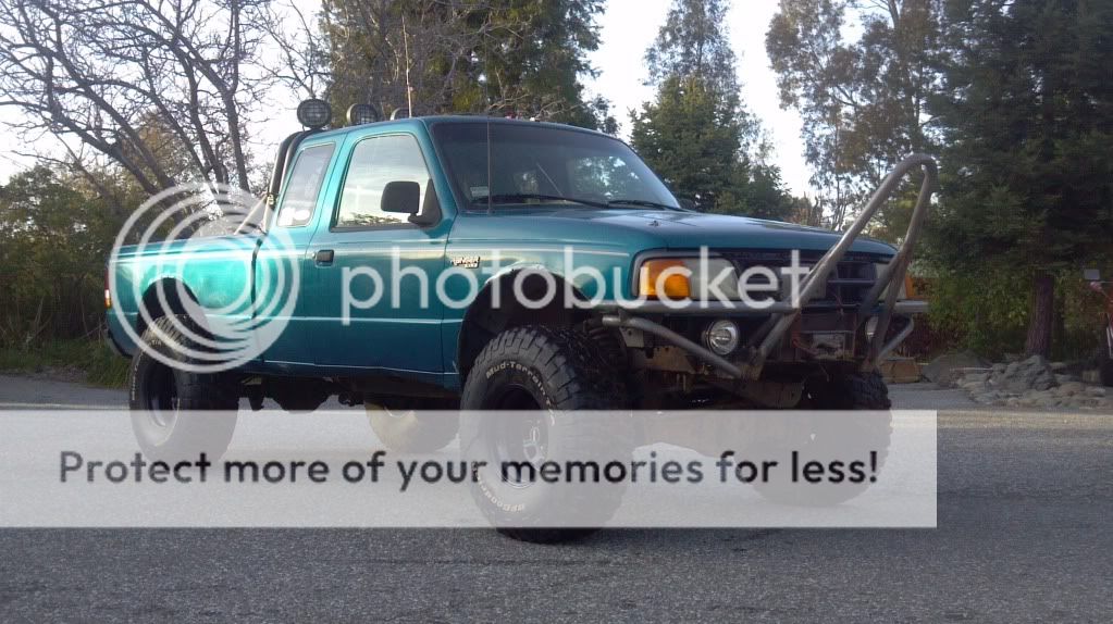

That stinger is huge!! Id never be able to rock that i wouldnt make the corners lol
I swear that pictures make it look bigger than in person, and it really doesn't obstruct your view from in the truck all that much, and it doesn't stick out from the front too bad. If anything I think it helps in parking lots because I can see EXACTLY how far out the front of my truck sticks out.

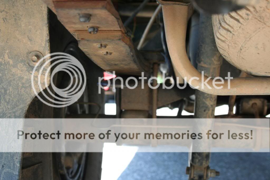

I also put some explorer leaves in the rear, so now I actually have some positive arch to them.

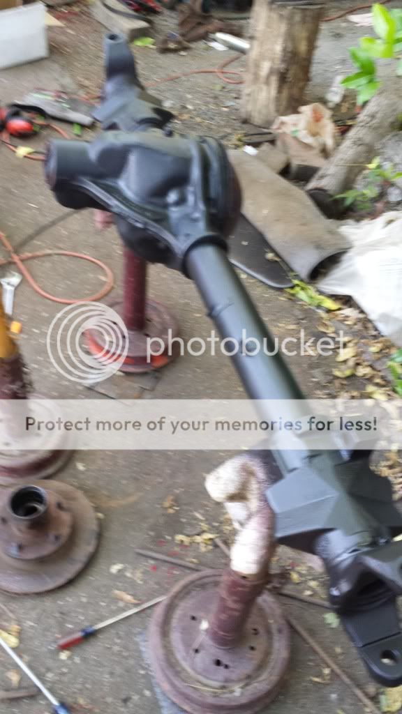

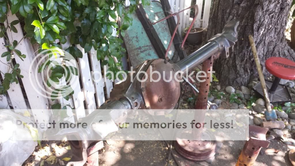

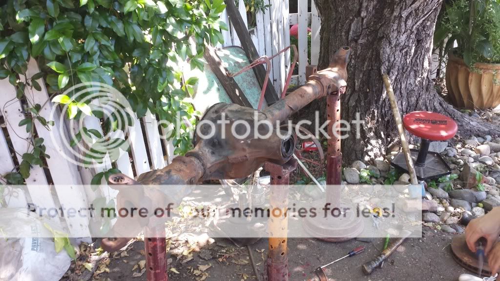

Got to work on my front axle.
Ordered some parts, and started cleaning up the D44
dhkonrad's 93 ford ranger

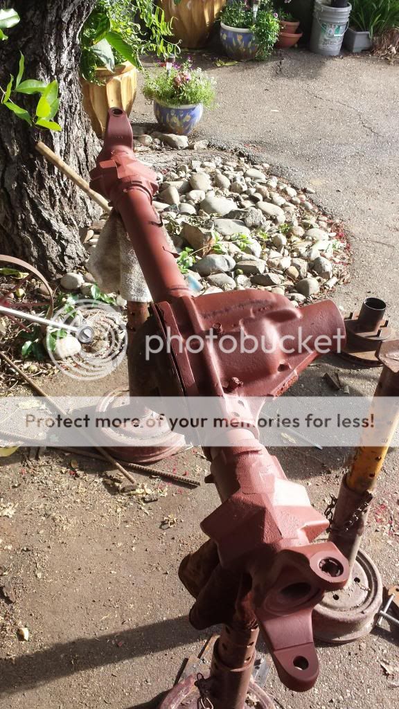

and got the housing primered
started also cleaning up miscellaneous parts and painting them

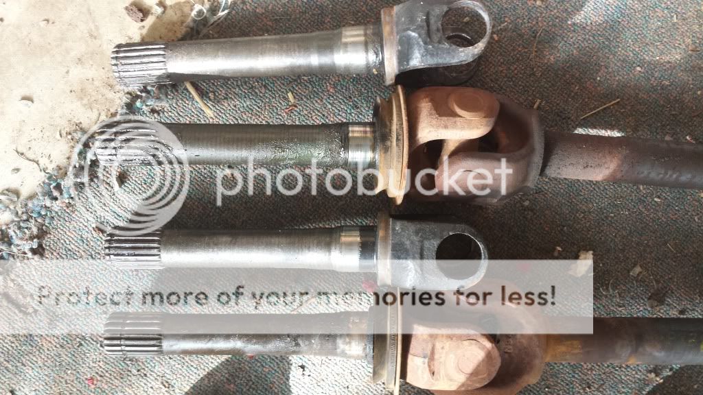

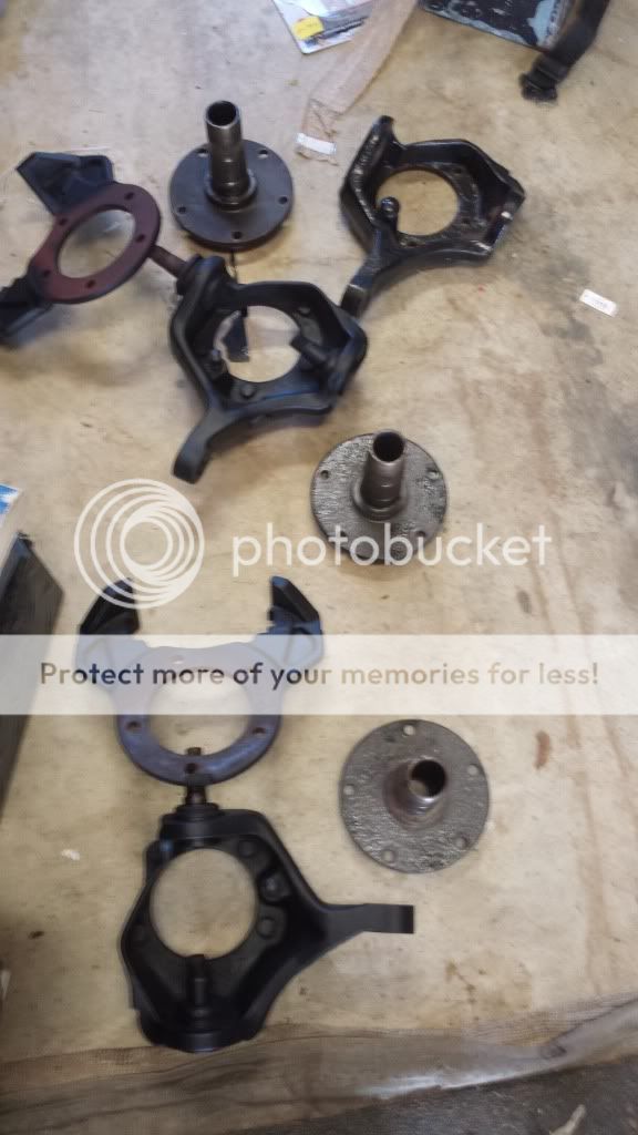

I also had a set up stub shafts from a 76/77 d44 and they are different length from the 78/79. I thought that was kind of interesting...

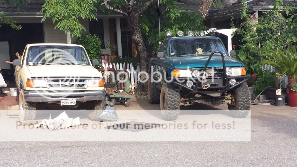

Also had a kind of before and after shot of sorts today, because I was working on another ranger
I continue to think of my truck as basically stock, which it kind of is, but it is fun to see it next to a completely stock Ranger.

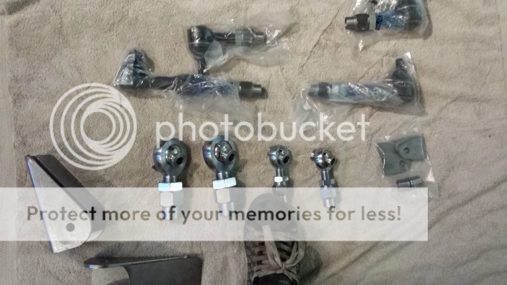

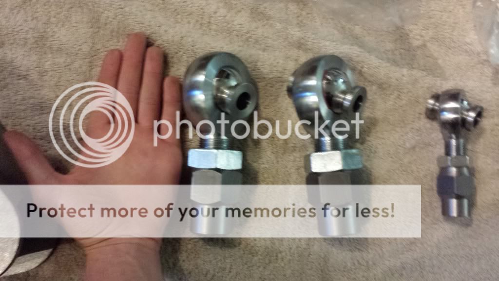

rod ends for radius arms and for tracbar
Radius arm rod ends are 1.25, tracbar is 3/4

(size 12 shoe shown for reference)

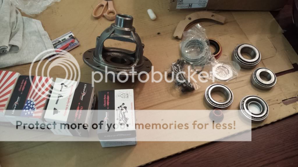

ball joints, master install kit for the rear, and 3.90 and up carrier for the d44.
Also got another coat of paint on the axle

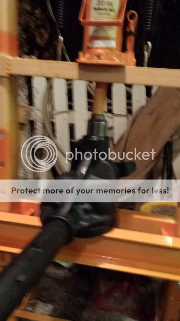

Couple random things I have been throwing around though. Should I weld up the axle tubes to the housing? I have seen a lot of people swear both ways, but would it hurt anything to weld it up while I am there?
SWEET! your stoked! What year axle is that? Whats going it the rear. I have a 60 but regret not getting a 14 bolt instead.
I know, I'm super pumped! It's a 78/79 d44. I considered my options for the rear, given that it would need to be 1/2 or smaller, and I settled for a 31 spline 8.8, and I'll run wheel adapters to match the 5.5 on 5 and the width. I figure if i havent broken a 28 spline 8.8 with 35s, why should I break a 31 spline...

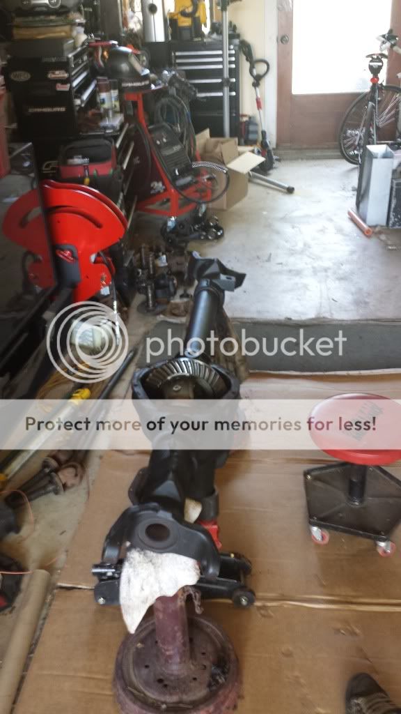

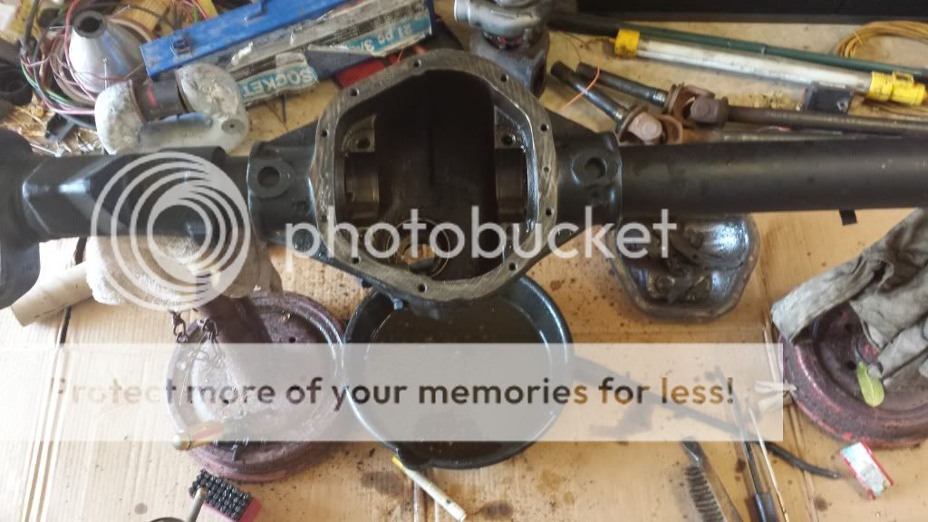

Got my replacement ball joint and finished installing those in the knuckles. Also cleaned out (kinda) my garage so I could start disassembling my d44, cleaning it, and then regearing.

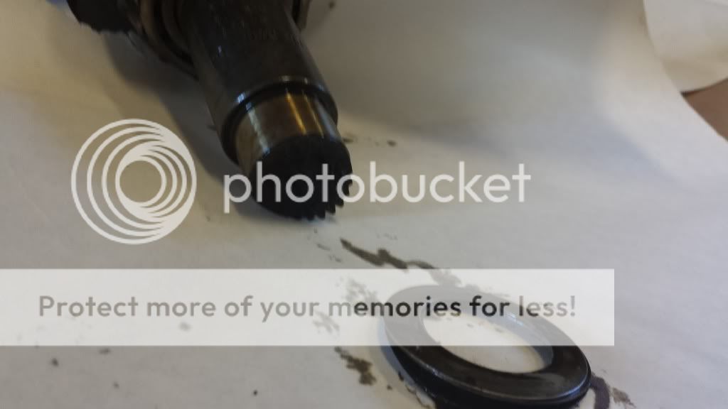

old pinion:
it worries me that it broke, because I feel that it could have broken because the housing was jacked up, or that it jacked the housing up when it broke. Either way the housing doesn't LOOK messed up, and there were no chipped teeth and both the ring gear and pinion teeth both look to be in good shape, but idk how much that means.

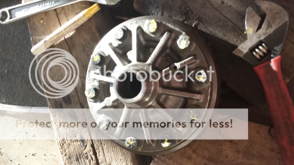

Also got the new ring bolted onto the new carrier and all torqued down

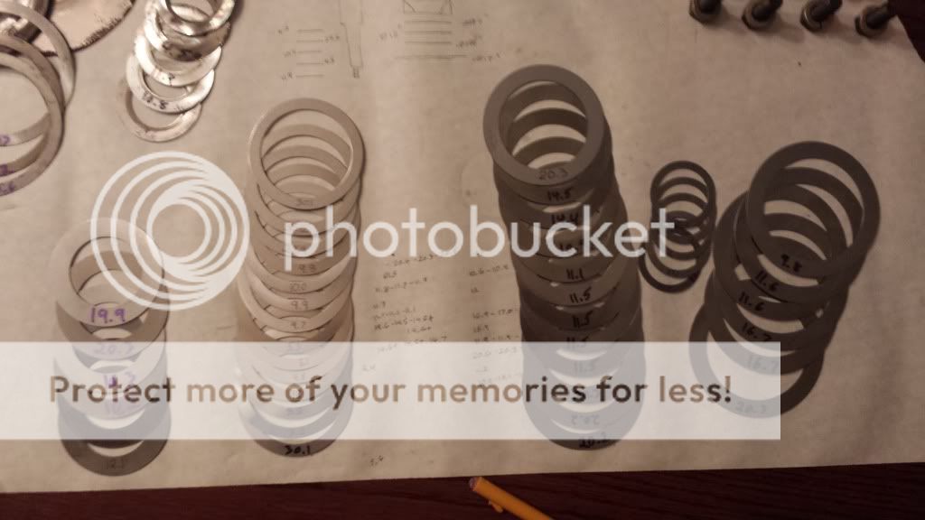

went thru and measured and labeled all the old and new shims to make setting up the gears easier

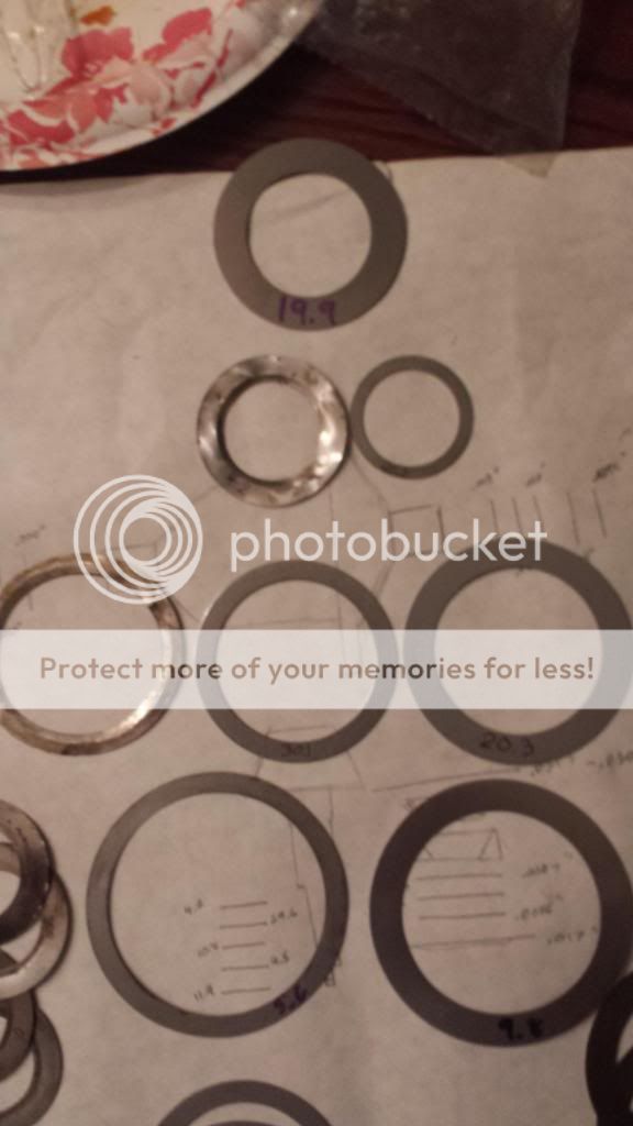

and thats when my trouble started. The master install kits I got seem to be rather lacking in the shim department; thankfully my carrier came with a plethera of carrier shims. Still leaves me kinda lacking in the pinion bearing preload and pinion depth shims. Is it a problem to reuse old ones? The new shims are also slightly different sizes than the old ones, but they seem to all be correct, except for one set of shims, that I have no idea what they are for
2nd from the top are pinion preload shims (against the outer pinion bearing-cone) with old on the left, new on the right
3rd from the top is the carrier shims with old on the left, one that came with the carrier in the middle, and on the right is one that came with the master install kit.
bottom is pinion depth bearings (goes between the housing and the inner pinion bearing-cup).
The ones on the top are the ones that I don't know where they go. In comparing them with all the bearings, housing, and old shims, they seem to be a perfect fit to go between the inner pinion bearing-cone and the head of the pinion. This would affect depth, but makes no sense to me because there is already a place to shim the depth of the pinion... I am very confused and they seem unnecessary, but I don't think they would send me shims that were unnecessary... or would they? :icon_confused: :dunno:

Needles to say I am more than slightly confused and any help would be greatly appreciated.

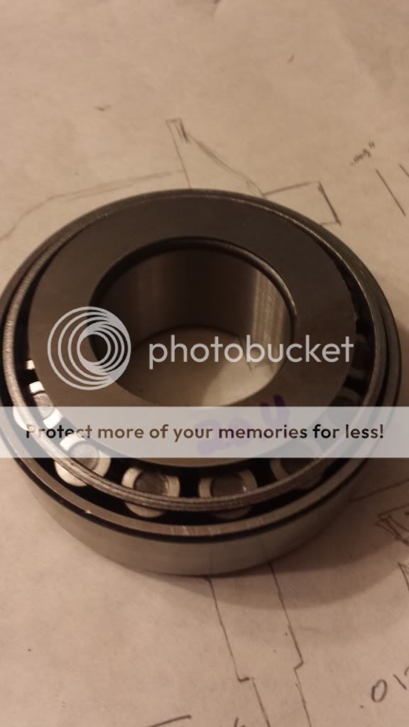

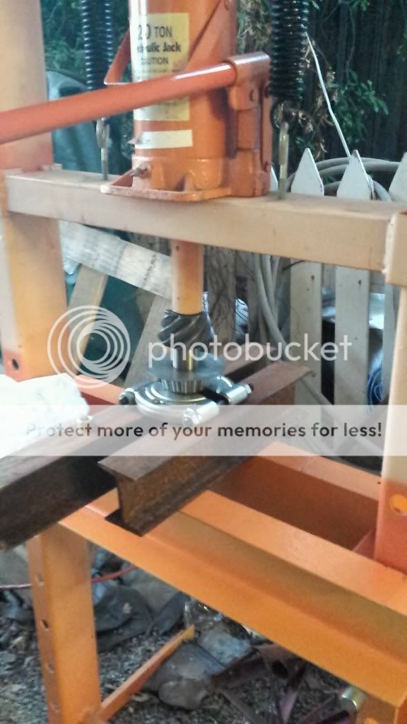

Started past the point of no return, pressing bearings and races in
(sorry for crappy cell phone pics)
first time I have ever used a press to install races. I have to say, felt much safer for the race than beating them in. I don't think Ill ever go back...

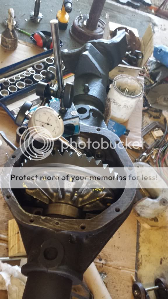

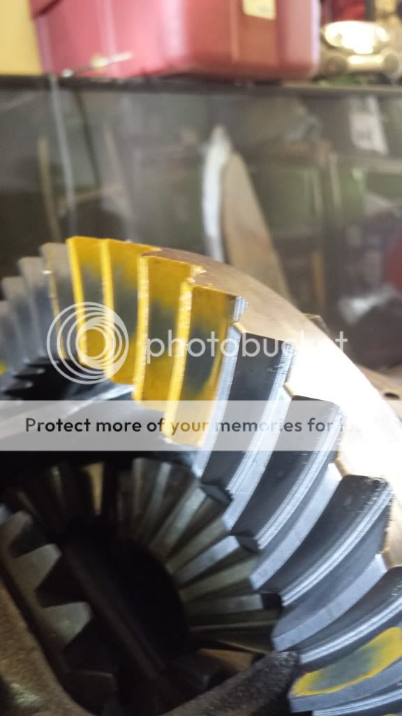

Also started on the setup of the gears
and pattern
Any thoughts on pattern? maybe the pinion needs to come in a little bit?
