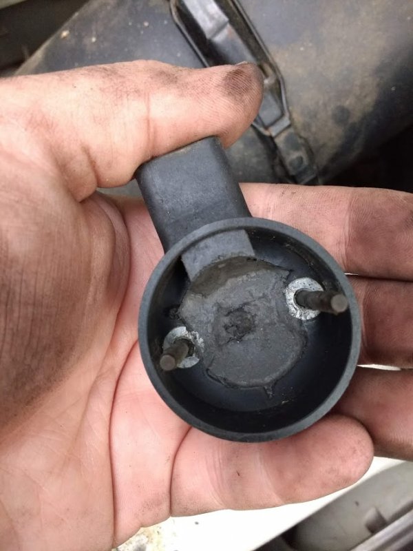

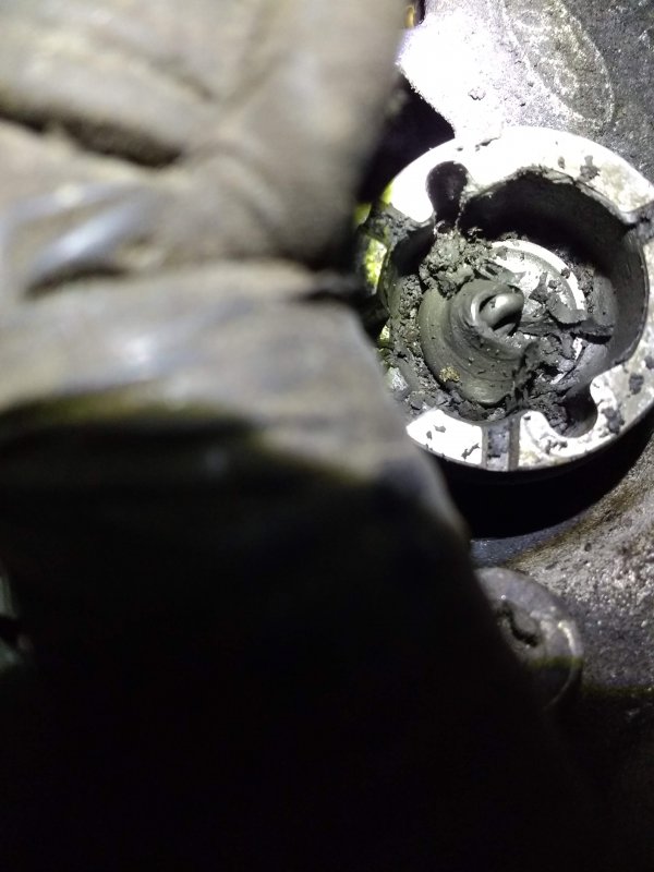

I recently purchased a non-running 1995 Ford Ranger XL with the 3.0 engine. After troubleshooting a fuel issue I managed to get my Ranger to run but was greeted with a check engine light and a P0340 code. When I pulled the camshaft position sensor I was greeted with the below sight. My initial online research indicates that failure of the syncronizer can lead to engine oil starvation. My question to everyone is given the below damage, how screwed am I, and how would I go about checking that my engine is not destroyed?

Drain the oil and see what it looks like.
First I'd get one of those long 1/4" drill adapters and use it to run the oil pump and see what kind of pressure you can make, measuring with a mechanical gauge.
Then I'd drain the oil and see what it looks like. Drain it into a clean container and then filter it through a coffee filter to look for particulate. Also cut the filter open and look inside.
+1 ^^^
You are probably fine, the sensor parts at the top of the synchro tower can disintegrate, as seen in the picture, without effecting the lower end with gear and oil pump drive
You can disable coil pack and have some one crank the engine over, you should see the towers center shaft rotate, that would be a good sign the oil pump never stopped working
I have had TWO engines ruined by bad sycronizers in my rangers and both times the gear that rides on the cam shaft was shredded, starving the engine of oil pressure. Removing the one bolt that holds the synchronizer to the engine block, removing the sycronizer, and looking at the gear on it will tell you a lot. Both times the cam was undamaged. Mark where it is currently orientated and/or buy the positioning tool for $20 on eBay.

I realize I'm a little late to the game on this thread but I'm wondering if an oil change should be done after the gear or roll pin breaks. I think I'm in this situation as the oil light came on and now the engine seems to have a loud tick which makes me think it's oil starved. My son drove it about 2 blocks with the oil light on after the engine had initially shut off (he was able to restart it after a minute). I scanned it and got the following codes P0340, P1336 & P0300). I'll be completing the synchro replacement in a few days and I want to be as informed as I can before going into it. Hopefully the engine is still good! Thanks!
1st, DO NOT START THE ENGINE
the amount of time it can run without oil is not much. depends on a few things, load, wear, rpms.
I would remove the cam sync unit and inspect the drive gear. take cap off then the bolt holding it down. twist 'n pull for removal.
then try running the pump with a drill and an extension mimicking the lower shaft of the sync unit. see if it builds pressure.
if chunks of teeth broke off I would definitely change the oil. either way I would recommend changing it.
Thanks for the quick response. I tried pulling the cap off but can’t seem to get it to come loose. It is so cold out right now so I’ll have to wait until it warms up a bit as my fingers just won’t function. I’ll keep you posted if you’re at all interested. Thanks!
There's no need to start it. You just need to verify the shaft is spinning with the engine. Have someone bump the key while looking at it.
If the shaft spins (and it probably will), the oil pump is being driven.
