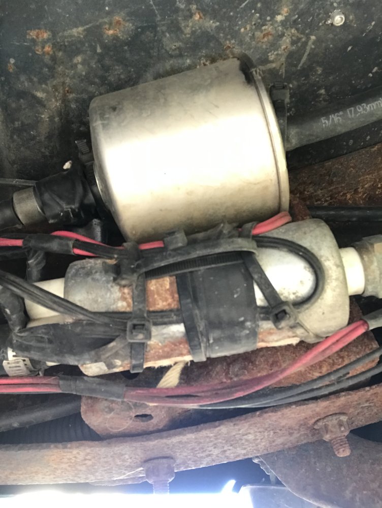

Im running this pump on my ‘94, stock pump assembly is still in the tank. the only issue Ive had is that below 1/4 of a tank it acts like its not getting enough fuel , still will run but must be more difficult pulling gas through the stock pump when the tank is low. I usually fill up at 1/2 tank, but on the trip to southington a couple years back I went clear to 1/4 tank and it didn’t have a issue. The frame mount pump Im using is a little noisy though, got it at a local speed shop, I believe its meant for efi applications in racing, Ive put about 4 years/10K miles on it this way. Theres 2 fuel filters since I didnt have a way to connect the efi fuel line to the pump, both lines are on a filter then the other barb of the filter has a 5/16” hose slid on in & clamped. The whole mess is zip-tied in place inside framerail. power to the pump is out of the underhood fuse block, a unused spot that is B+ “ignition on”.

View attachment 77908View attachment 77909
FYI, you should trim your rattails on the zipties shorter, like flush. They have a very nasty habit of slicing you arm open when you hit them "accidently". 10x worse than hose clamp ends.
The key is to use flush cut side cutters... I have several cheap pairs.
