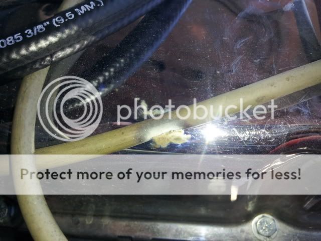

Found the reason for my back firing. Since my truck can idle now i figured i would let it run in the dark tonight and saw that one of my plug wires is shorting to my header causing the back firing. So guess I'm after some new wires but need ones with 90 degree boots. And also so far, looks like my mileage has got better but don't like the electric choke, doesn't open up all the way even after driving awhile, it is wired up correctly but will get the volt meter and be double sure power is still getting to it.

The wires will cost a bit plus going to either wrap the headers or get slip over wire protectors

Id do both really for different reasons but for now do wire boots
I'll get pics of the wires, almost all of them have gotten burned by the headers. Not out much on them though, only costed me $8 on Ebay.

Here's the wire that was arcing to the valve cover due to it making contact to the header, got it out of the way of things. Valve cover now had an arc marking on it.
