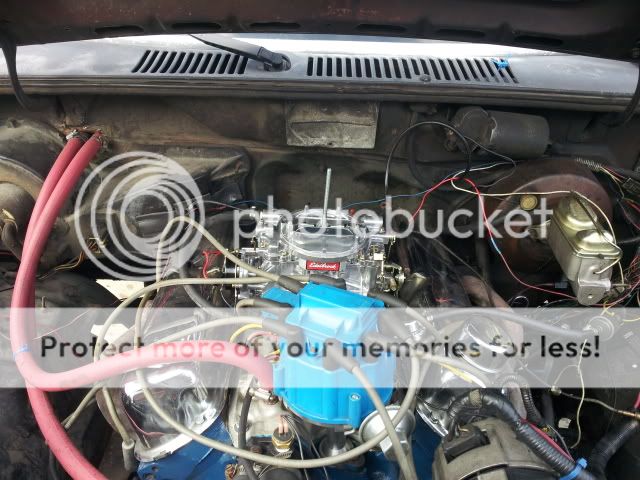

Got the carb on and drives so smooth, idles, etc...well with the money. Have to get a different air cleaner, my other one hits the fuel inlet.

Looks real good on their!! Iv always liked Edelbrock carbs and had reel good luck with them on my older trucks

Found the reason for my back firing. Since my truck can idle now i figured i would let it run in the dark tonight and saw that one of my plug wires is shorting to my header causing the back firing. So guess I'm after some new wires but need ones with 90 degree boots. And also so far, looks like my mileage has got better but don't like the electric choke, doesn't open up all the way even after driving awhile, it is wired up correctly but will get the volt meter and be double sure power is still getting to it.
