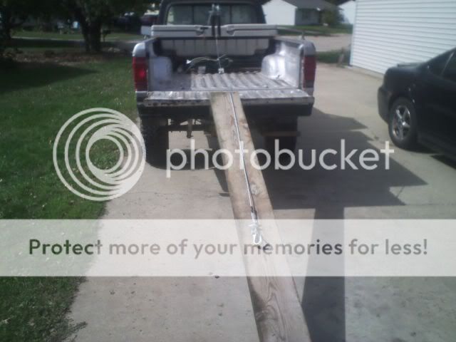

i think we need a demo video of how it works....
I can get a picture of what it is going to do. There is 25 foot of 800lbs. test cable on it and a hook that has a latch on it so as not to slip off. As you can see in the picture, I have the cable running down to a pulley. This is to not only keep the cable in the bed area but helps with when winching something into the bed it helps keep it parallel with it and also kept me from having to make a brace to hook to the bed to keep it from torquing. All the force went from being from the top of the pulley to the tail gate to down and the bottom of the pulley just buy simple changing its dirrection. This also is a safety thing too as since the cable is in the bed and if it were for some reason to snap, it would smack the inside of the bed and not fling everywhere.
I tested it on a 300lbs table saw we have (built in the 60's so its all steel and yes its craftman and has NO safety devices on it so if you cut a finger off, you deserved it then) with no wheels and pulled it like it was nothing.

Okay hope this helps those that are confused........

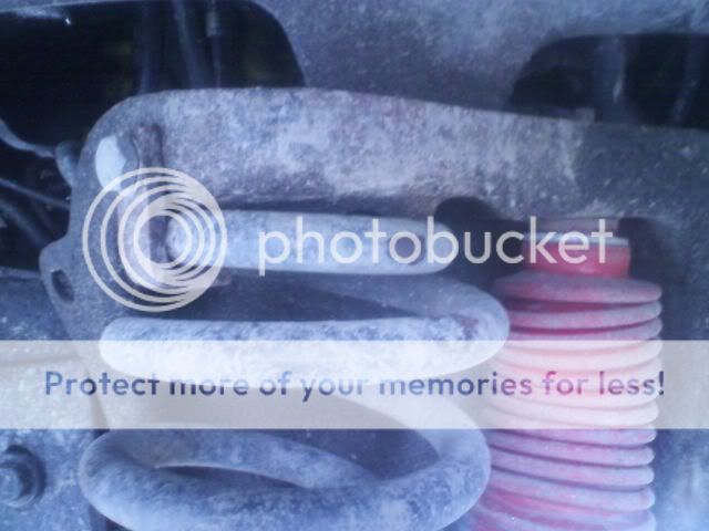

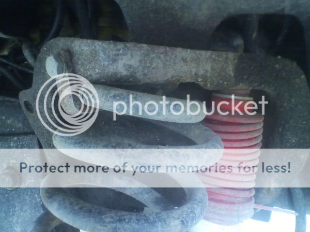

Well compress the front suspension fully a few times and this is what you get.....
The coil wanting to slip back.
dangerranger1983 build
So one BFH moment later (didnt take much hitting really)....
Going to have to make another J clamp or just get a hose clamp to hold it for now. This is why it is important to inspect your vehicle, and its more important to do it when you have done such mods to your vehicle too.
