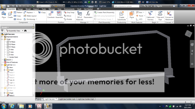

I want to build a light bar for the bed so that I can have more lights for the front, and a couple for the rear, but one that hugs the rear of the cab so that I can still have my tool box in the back.
Alright after thinking about it, this is what I have come up with. This will resemble what it should look like. Measurements are close to what I got from the truck and angles and some other stuff may/will change but giving you and idea....
Im looking at about 15 foot or so of square tubing that will be 1 inch and an 1/8 inch thick and the bottom parts will be made from 1/4 inch and will need 1 foot of that. If i do decide to add bars in the center of it, that will add to how much square tube that I will need. I plan on running 4 lights on top and maybe 2 pointing backwards.

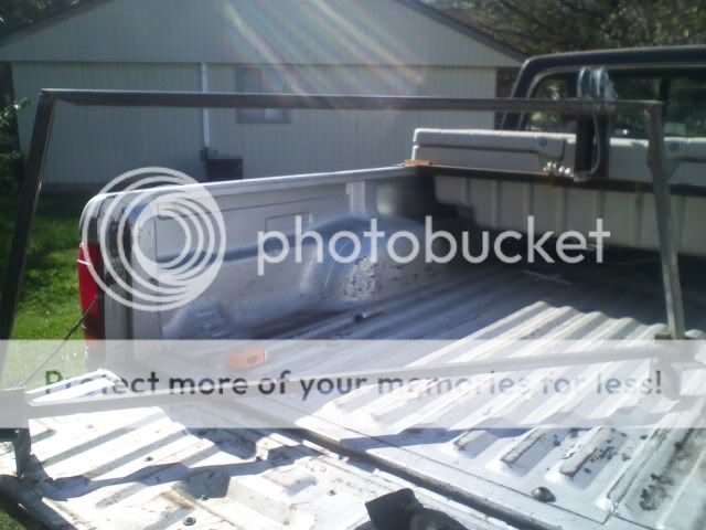

Okay here's what I got done in two hours before I had to leave for work.
Will hopefully have it done tomorrow but no lights on it but enough to drive around with.

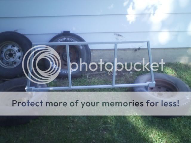

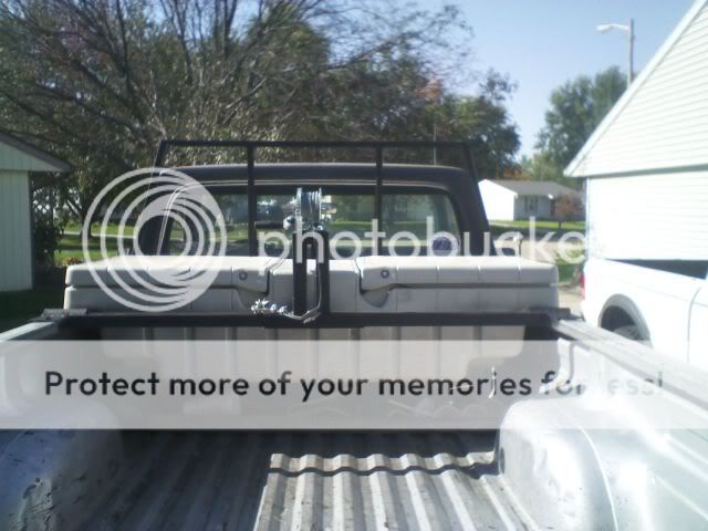

Okay got it done for now. Wont have lights on it for a bit but when I do decide on what ones I want and whatnot, Ill weld light tabs on it. Doesnt look exaclty like what I designed but went together better since I did plan it out.
The center bars are parallel to eachother and at 90 degree angles but due to the angled ones on the sides, it makes the optical illusion its not.

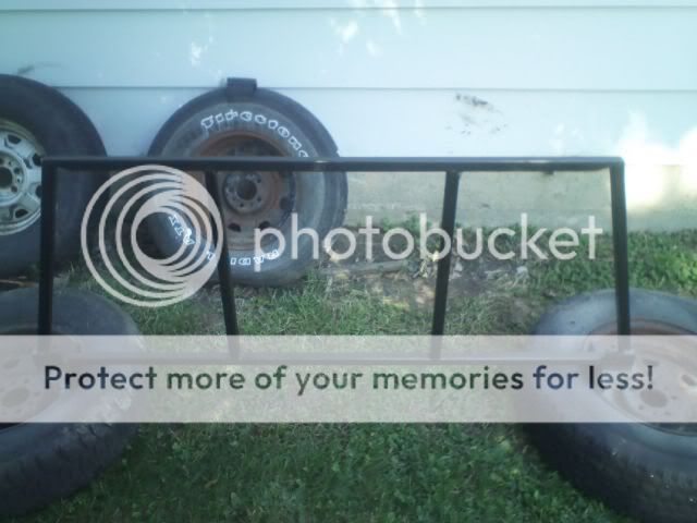

Metal

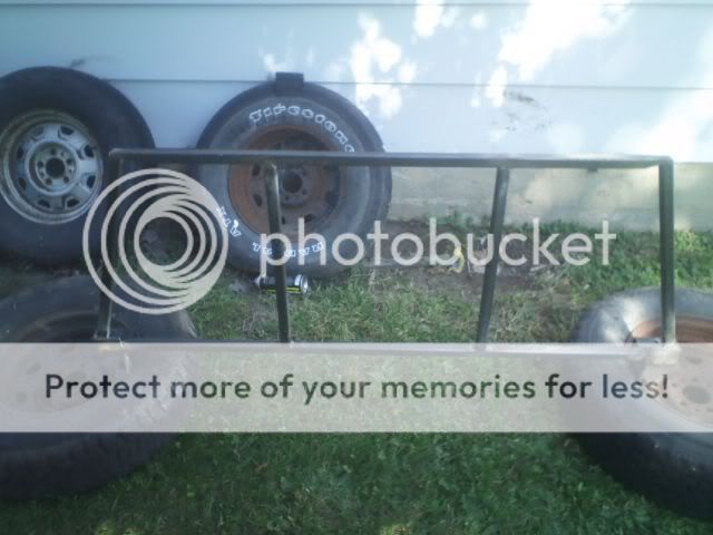

Primered

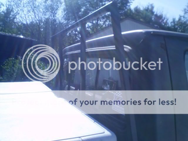

Painted
Baking in the sun

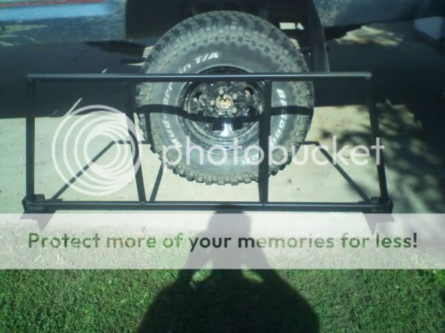

And mounted

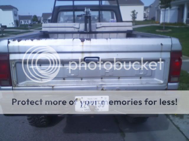

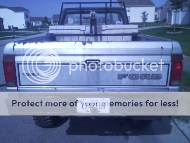

Got tired of looking at the back cover for the tail gate so I took it off. Some screw holes it was rusting out the tail gate.
Before
After
