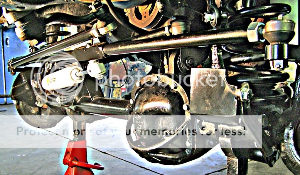

As far as doing this kind of swap, its not something you do over night. I planned mine out for almost a year before even laying a finger on my truck. I have a list somewhere on here Ill find it and post it just to show what I have done so far and what it has costed.
Okay found my list among the lists of may other people why have done SAS's.
Jeep Cherokee Dana 30 HP without the CAD $0
6.5 inch Jeep Coils $0
3.73 ring and pinion gears for the D30 traded AKA $0
Shim kit $24.59
CV boot $17.99
Pinion bearing $19.03
Long Arm Brackets $62.25
Ironman4x4 long arms $621.50
Stock Jeep Track Bar $25
Skyjacker Shocks $100
Steel $30
Custom brake lines $35
Brake $22 (LLT Warrenty)
Rear:
63 inch Chevy Rear leaves $100
Belltech 6400 Shackles $60
Hardware $30
Procomp Shocks $100
BF Goodrich M/T tires $800
New Rims $203
Mounting of tires $56
I think I may have missed a few things but I know that I have $2300 into it. My truck total is around $3000. For more info., click the link in my signature for my build thread.

As for the high steer, thats no lie. But the last thing I want to do is replace knuckles. Ill be happy to get my steering stablizer hooked up so day. Just waiting for warm weather so I can continue work on her.
Nice work to the truck....Cool to see you kept the oem coil buckets in your setup. I been thinking bout it off and on since I got another 1st gen but want to avoid welding.
