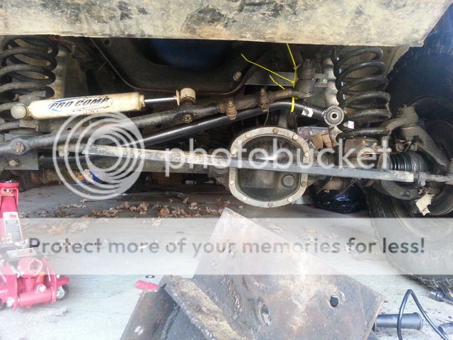

The heim does fit with its adaptors in the frame mount but its bolt is smaller, made for the axle side. The bushing bolt is larger and it is the size that the frame mount jokes are drilled for so I may have to do bushing on frame mount, no biggy.
And a double check off the books, both are 8.8 grade.
Hmm imo the frame is the side that receives more of the deflection when the axel drops. But it may not matter if the suspension doesn't travel excessively.
Everybody I know has the heim on the axle.

Mocked up and ready for the ballistic mount. Getting pissed though, been two and a half weeks and only had a "it's been shipped" email from them using fedex.

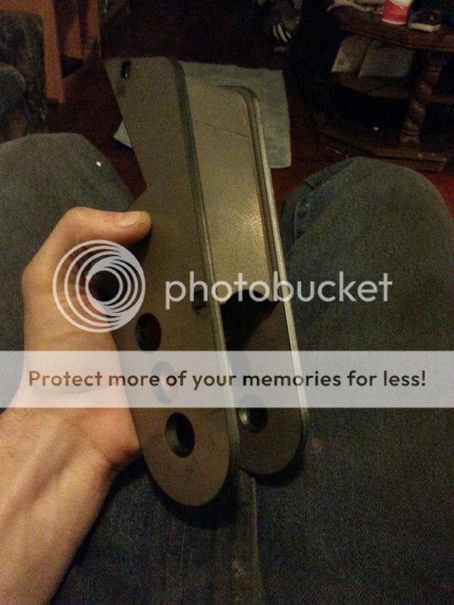

The mount arrived, just have to tack it together, get the mount I'm welding it to modified, mock everything up and burn and bolt everything in.
dangerranger1983 build
Awesome! That's a beefy bracket!
Not bad! It's bigger than my ruff stuff bracket. But that's the exact design I was going to build. Then I went with the ruff stuff one cuz I got lazy.
I was going to do ruff stuff but it didn't drop enough. This is made of 1/4 laser cut steel.

I can't remember if the RS is 1/4 or 3/8 but I broke it first trip. I reinforced it with 1/4" plate and bolted it on and haven't had another issue.
