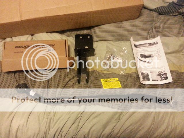

It came! But all I have is a picture of a box because I'm at work so I have to wait another 3hrs and 15min till I get off.
Sweet! Was it a ruff stuff Tack arm?
Rough country. Cheaper and came with a mount that I might be abke to use with some mods.
Question is, does it matter which end the bushing or heim is on m I know the instructions say to put the bushing on the frame mount but the factory track bar bushing is on the axle? Also why did it come with one grade 8 bolt and the other is grade 5?
Hmm I would put the bushing side on the axel personally. And get another grade 8 bolt.
How wide is that bracket? Would it accept that heim with bushings?
