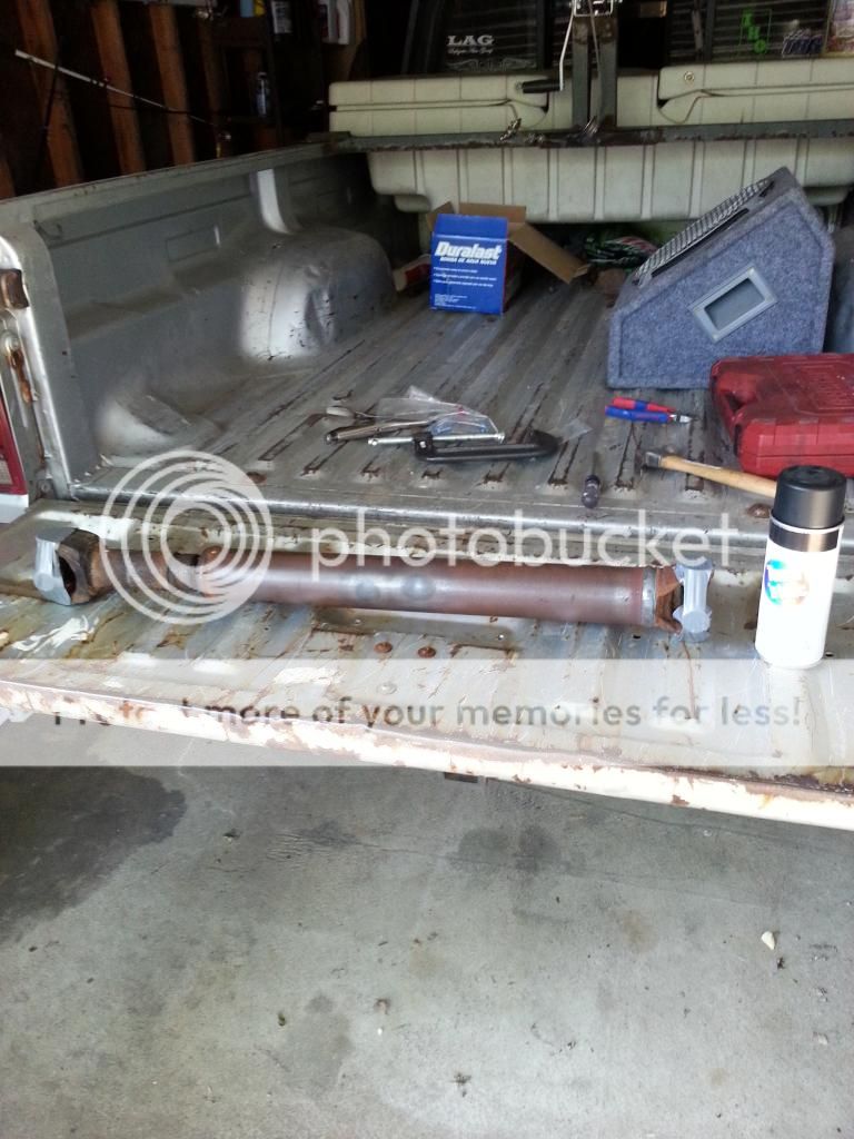

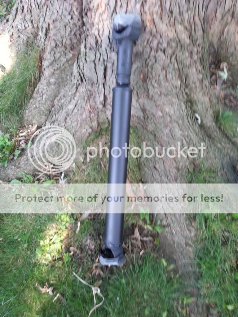

Shortened and painted. You can see where it had to be heated up to get it to be straight again.
