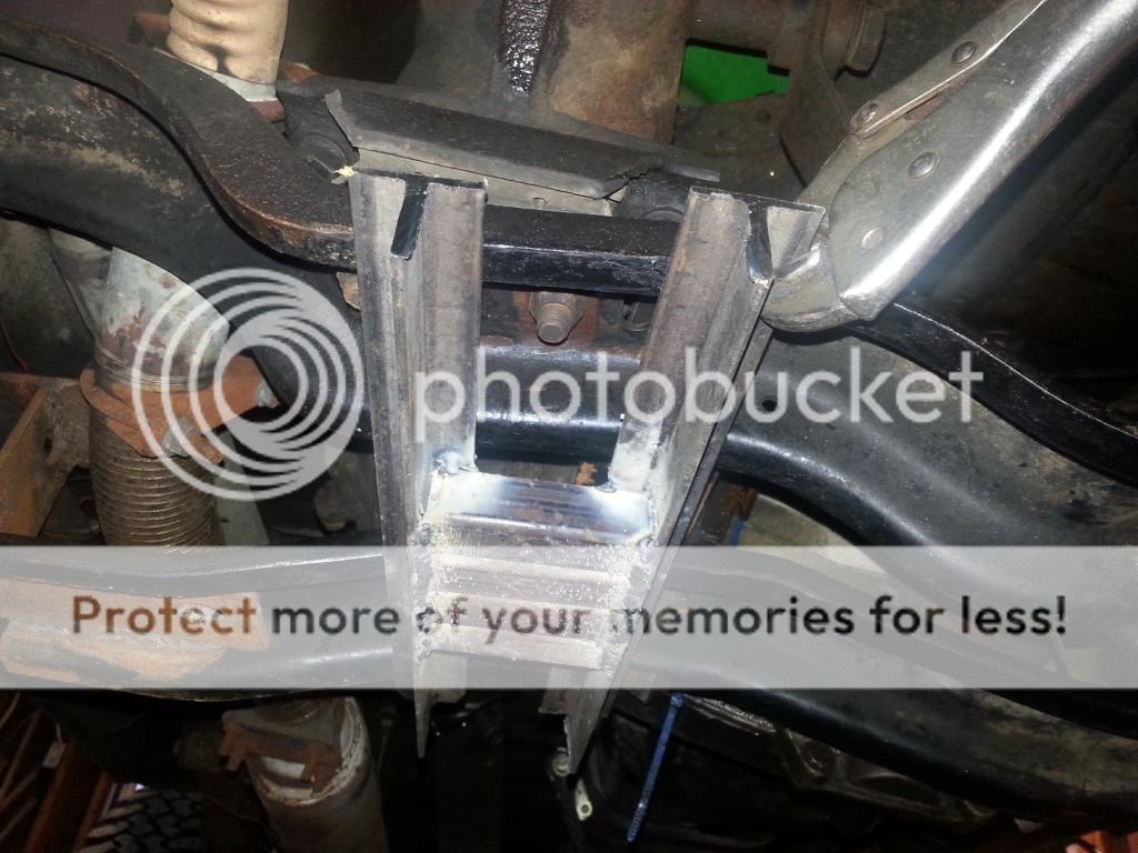

Found motivation to work on the truck but ran out of welding wire but here's what I have so far to hook the front and rear trans xmembers together so that I may cut part of the front one out so that I can have room for the drive shaft.

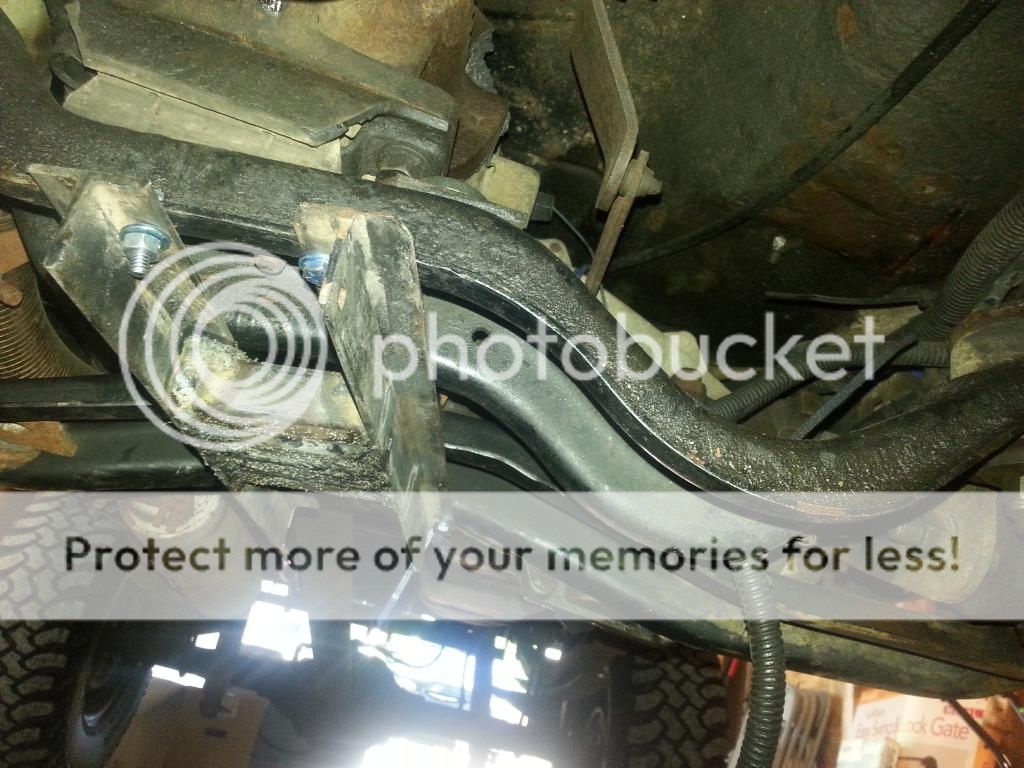

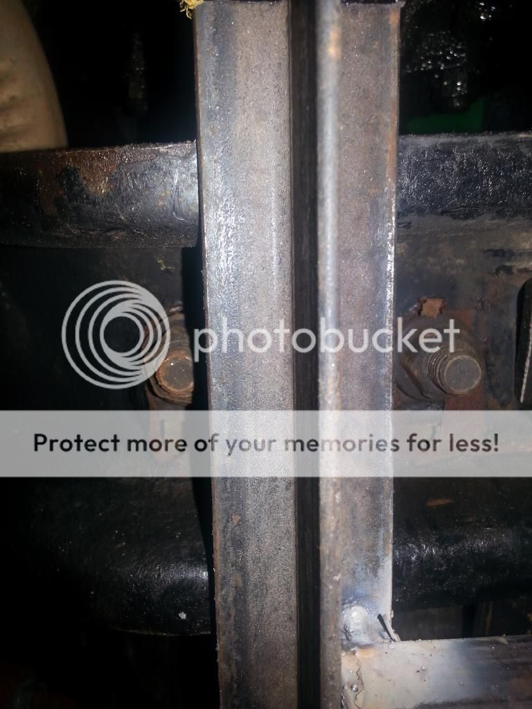

Mostly installed, just a few more things to do before cutting the U part out of the front trans xmember.

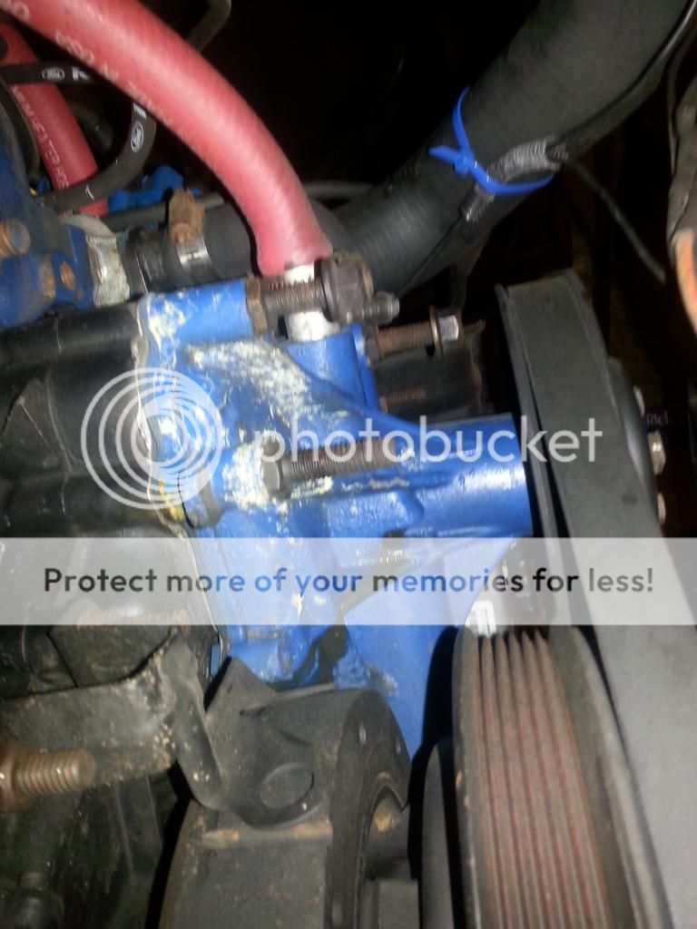

I'm not a happy person right now. Two year old water pump and it is leaking out the weep hole enough to have caused my fluid level to go down enough that it caused my truck to have vapor lock because the intake couldn't keep cool. Had to wait 45 minutes and have Jello from a buddy to get it to start up again.
So my plans are to get another water pump, install my temp gauge, install a thermostat with a lower temp rating to where it will open sooner, about 185, but not have my fan turn on till 195 ago as not to have my fan running all the time but the fluid will circulate more often and only need cooled when it get to that temp as it goes into the rad. Also going to drill a 1/8 inch hole in the thermostat, as suggested by Ranger SVT, to help with any trapped air that may get in there but also circular things as well. Plus going to add a carb spacer to help insulate direct heat the intake has to the carb. Plus on top of all of that, get the 4wd done.

Just called AutoZone to see if my water pump could be brought in to be replaced because it had a LLT and I painted it and just saved myself $40. So now I have to get the old one off.
