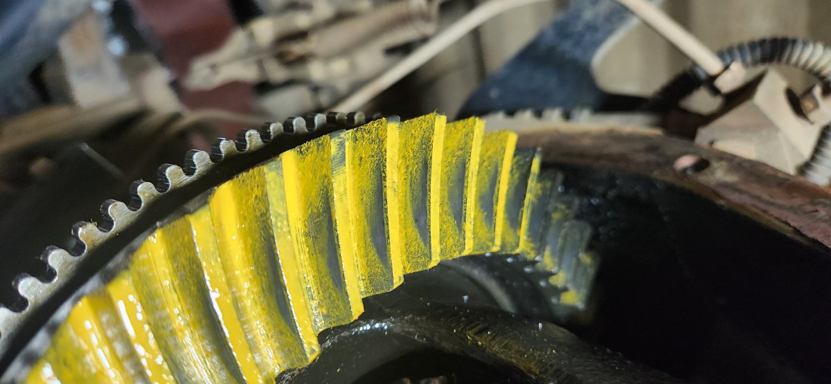

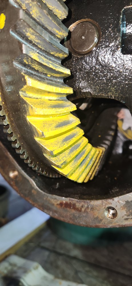

Hi everyone! I'm trying to get the correct gear pattern on my new set of gears for my Dana 44 rear end, and since it's a PITA, I would like your input about the patterns I'm getting.
Please see files attached.
Dana 44 gear pattern acceptable?
Is this runnable or I really must add shims to the pinion?
I would be happy with pinion depth. But maybe shim the carrier a tiny bit to get more depth of engagement. How is your backlash?

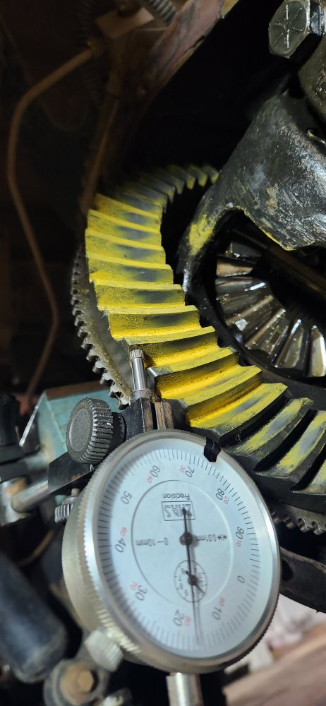

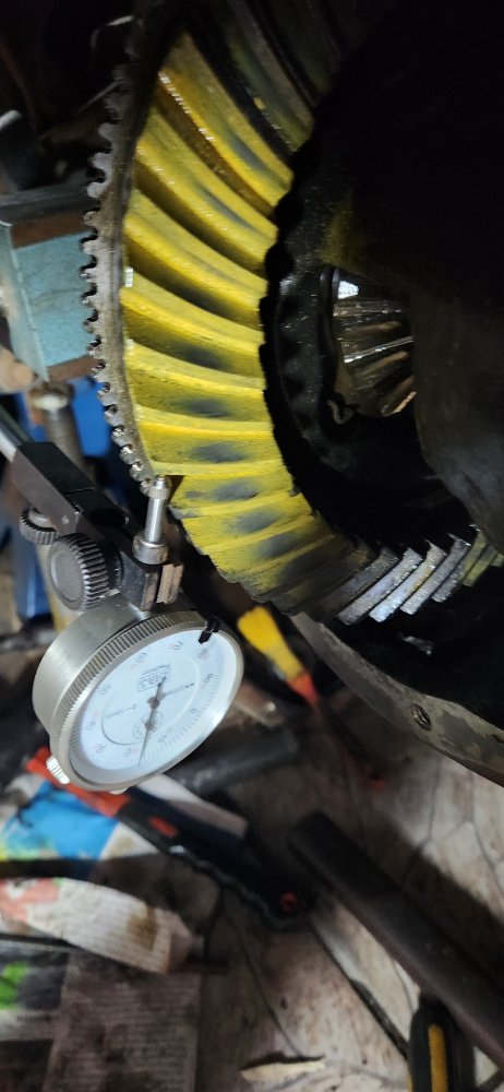

Backlash is at .0044. Spec says 0.005 minimum. I'm already a little bit too tight in backlash.
I would try adding more to the pinion shim, just to see where it goes. Maybe .008" or so.
I put an 008 pinion shim and reset backlash to 007.
Is this acceptable?
  • Dana 44 gear pattern acceptable?
That's nice and deep and even, I like it
