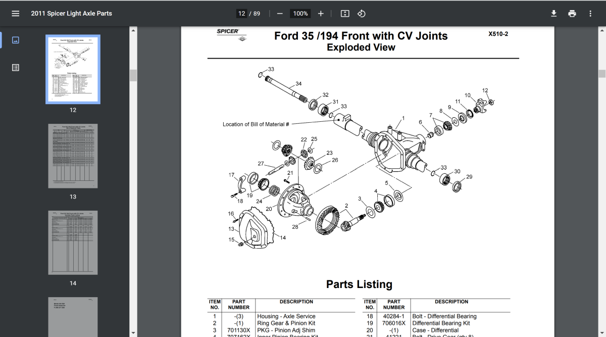

Through TRS forums I found the Dana/Spicer part catalog https://www.therangerstation.com/tech_library/pdf_documents/X510-2.pdf

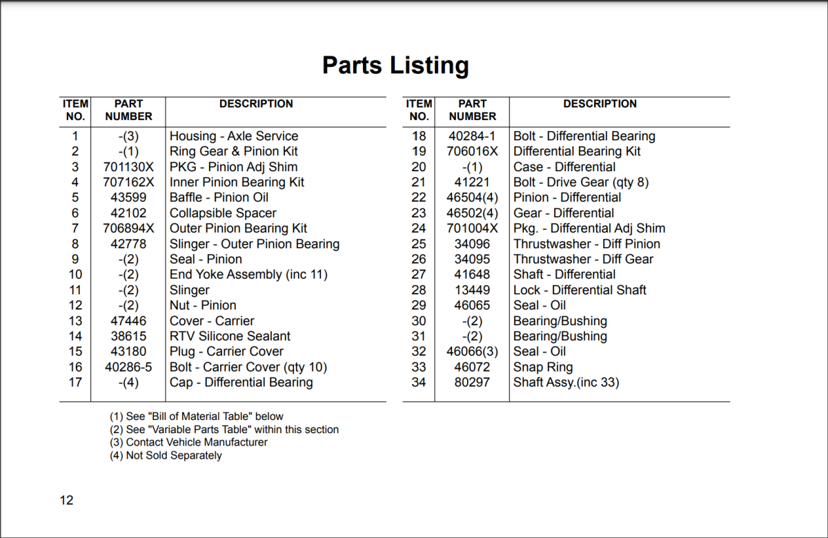

The part I am looking for is number #31 on the diagram on page #12.
Then in the Parts Listing it has (2) that directs you to the Variable Parts table

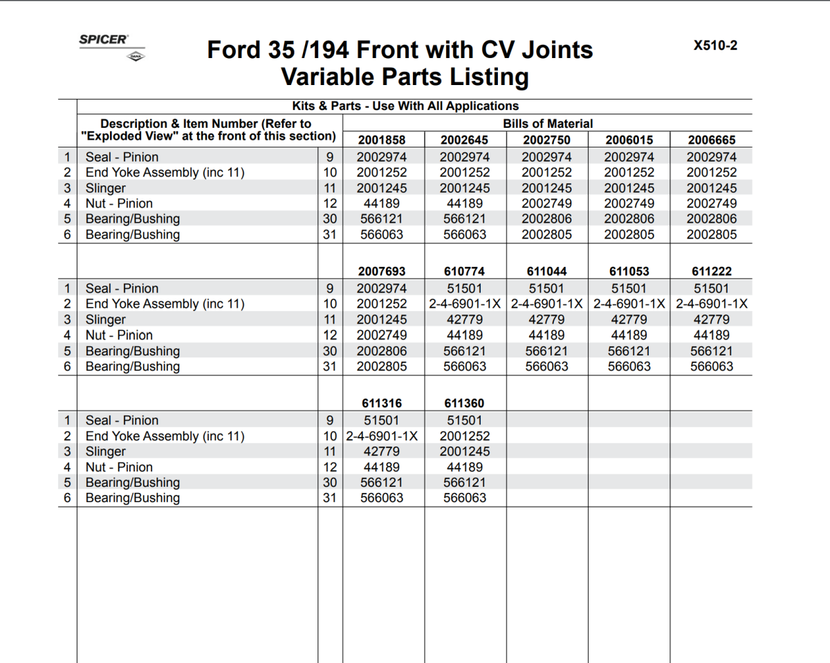

In the Variable Parts Table is where my confusion lies; how do I determine which "Bill Of Material" number refers to my specific axle?
I tried looking on my axle itself and I found 3 codes, but none of them look anything like what's on these tables.

search the part #s in posts 3 & 4 above
