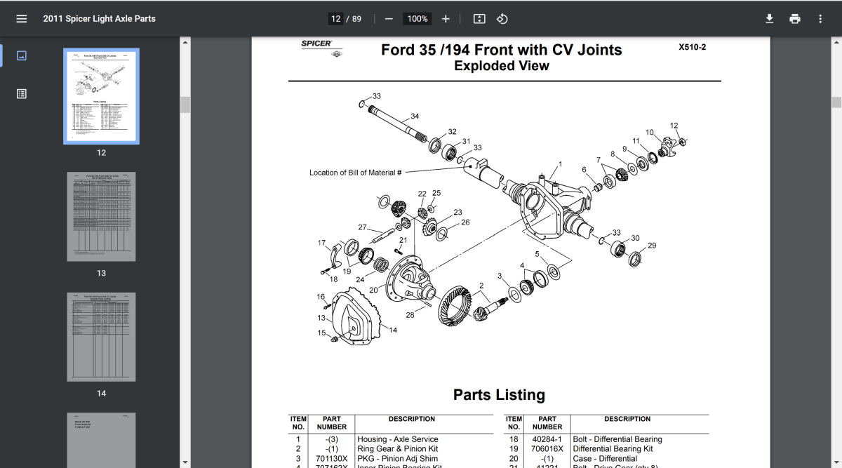

Through TRS forums I found the Dana/Spicer part catalog https://www.therangerstation.com/tech_library/pdf_documents/X510-2.pdf
The part I am looking for is number #31 on the diagram on page #12.

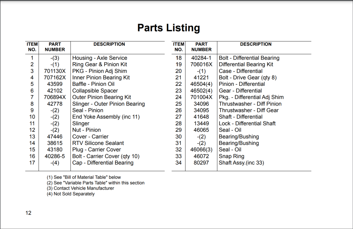

Then in the Parts Listing it has (2) that directs you to the Variable Parts table
In the Variable Parts Table is where my confusion lies; how do I determine which "Bill Of Material" number refers to my specific axle?

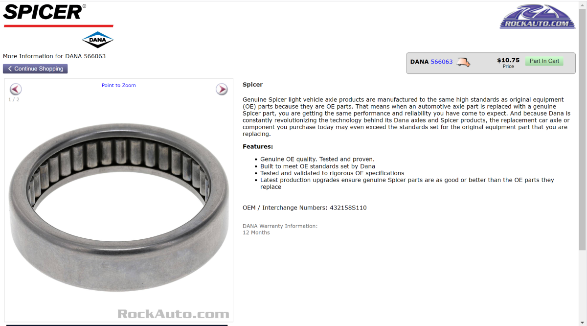

Looks like most used "31", 566063
Only other one is 2002805 which is synthetic bushing and not available

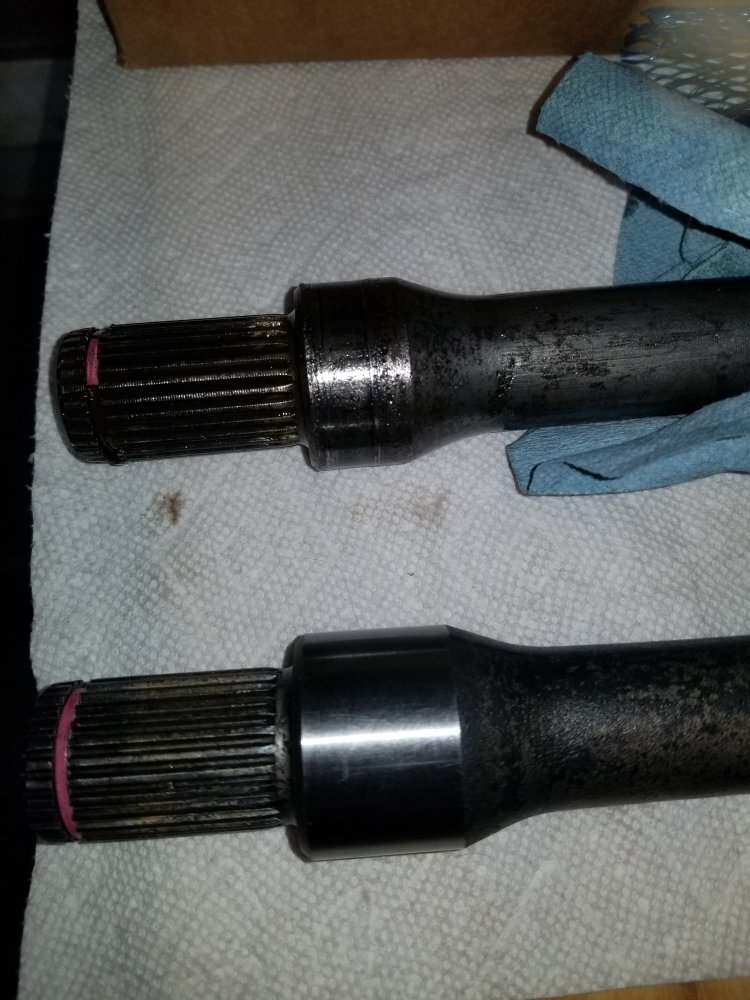

There we go. Old shaft top, New shaft bottom. Hard to see from the picture but you can see the lines i the top shaft from the bearing
yikes,
is there something in the tube restricting lube flow?
manual says 80-90 hypoid gear lube, 3.6 pints.
yikes,

That axle race looks pitted, usual cause is grit/debris getting in, did the bearing rollers show pitting as well?
Lack of lubrication gets that overheated rainbow effect but usually smooth
