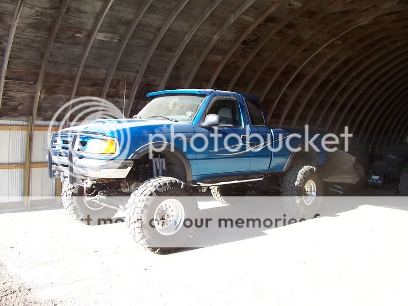

Thought I'd add a bit of an update to the longest fricken' build ever... :nopityA:
Here's a pic of how it sits as of today:
It's 31" to the bottom of the frame rails in the front. It's a bit higher than I would have liked, but the cutout flares still need to be put on so I will lower it after if I have enough room in the wheel wells.
Still to be done:
-Make a proper steering and trac bar setup from DOM
-Put on the 14B disc brake kit
-Finish off shock mounts
-Make a transmission crossmember that ties the radius arm mounts together
-Build exhaust
-Get an alignment
-Put on cutout flares
-Install 5.38's and Detroit rear/Lock-right front
