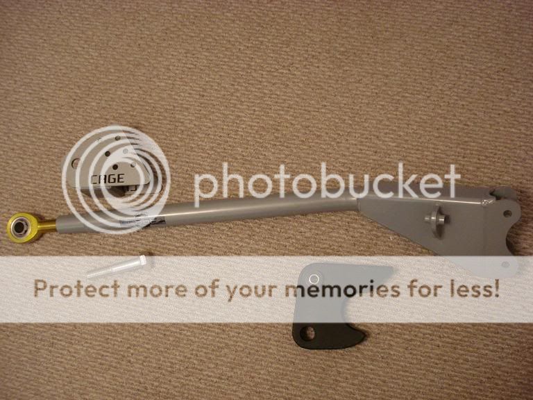

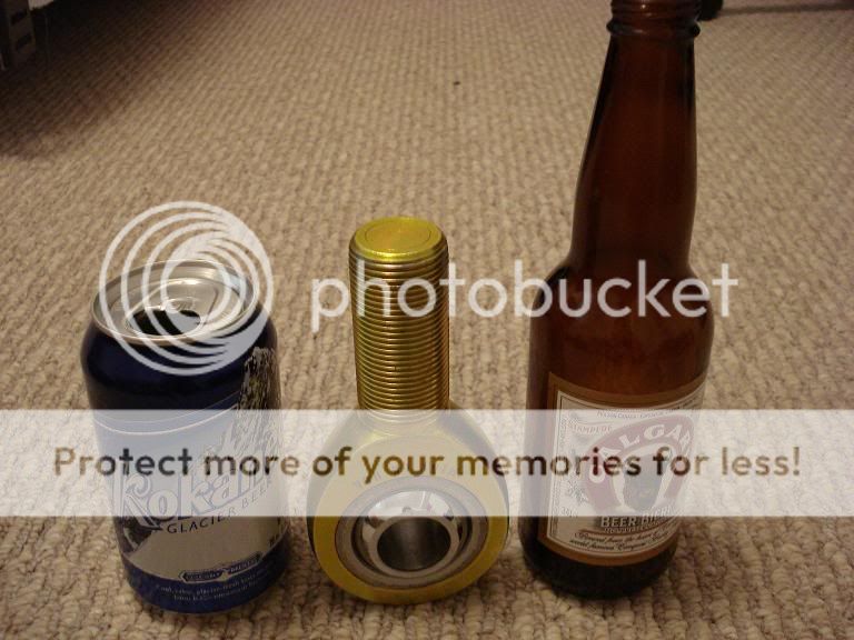

Cage arms finally came in! These things are fricken' huge. They came in at 65lb each with rod ends and fasteners. Some pics...
Can't wait to get them on! :icon_welder:

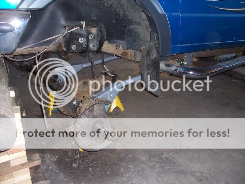

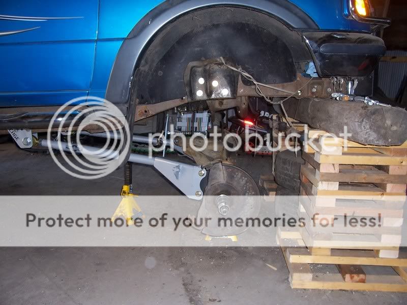

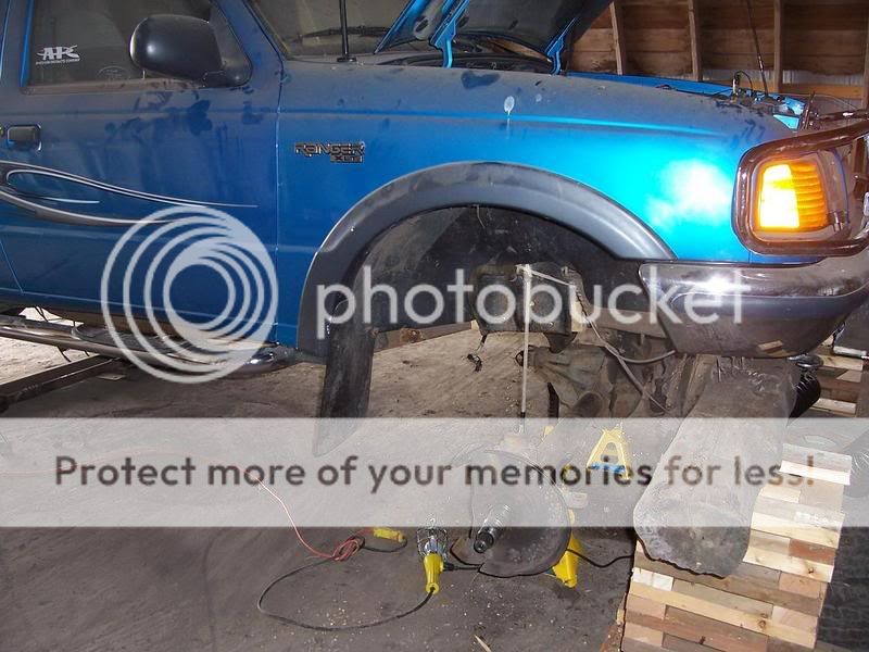

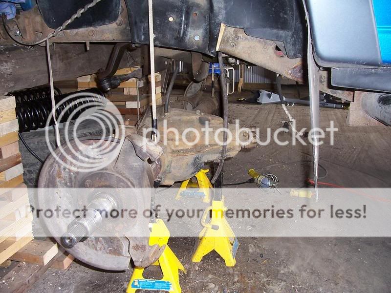

Here's some more of getting the 60 mocked up and set at ride height so I can figure out where to mount the radius arms on the frame. I also spaced the coils out a bit temporarily with a 2x4, just for mock-up. I'll build a spacer to go in there later.
Whats your height gonna sit at from spindle center to wheel well? Mine's gonna end up around 27", running 35's first and eventually 37's.
-andrew
just something to think about if you are running 38s on a 14 bolt you are going to be draging it everywhere because the diff is so big i would go to 40s or shave the rear alittle
-andrew
I don't really know, I've never measured it. I'll have to check next time I go to the farm.
As for the 14 bolt, I don't think I'm going to shave it just yet. It's only a few inches larger than the old 8.8, and for what I'll be doing with the truck, it's not that big of a deal. Not to mention, I've already got huge gains by swapping out that mud/snow plow that we know as a ttb.

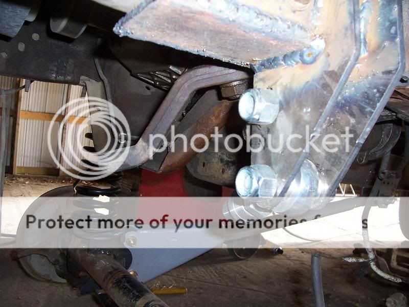

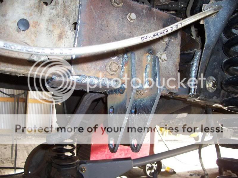

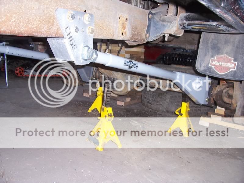

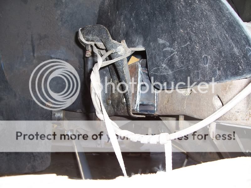

Pics of the trac bar and other goodies:
The top rod end goes to the engine crossmember, and the bottom is for the trac bar. I used the steering box bolts, the bolts from the engine damper, and I'll also be putting a couple of beads on each side to help distribute the load. It also still needs to be removed, cleaned up, and painted.
