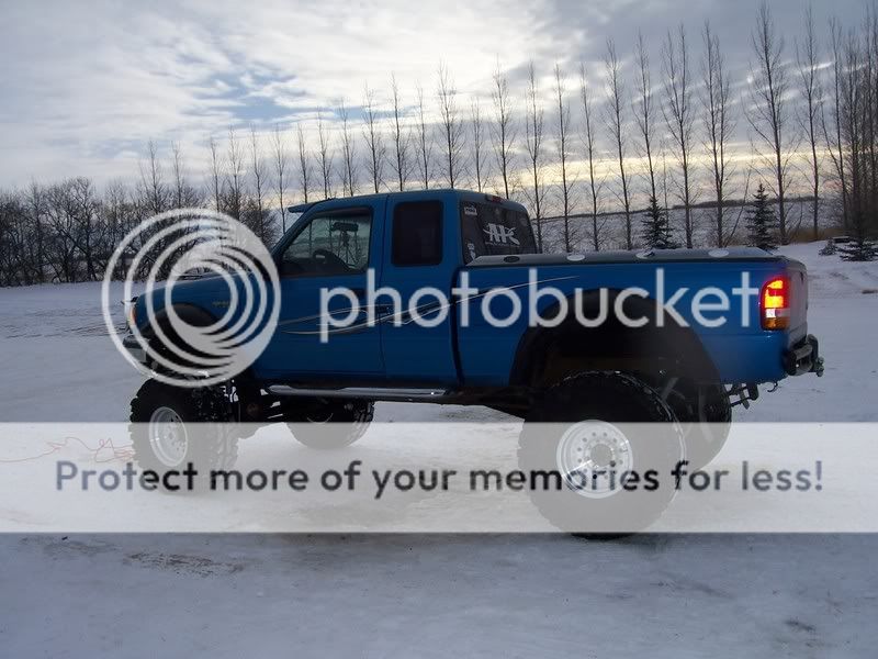

Well, the truck is finished for the most part. I'll be going in for a wheel alignment and a new exhaust system hopefully tomorrow or on tuesday. There are still some random parts that need to be painted(like the steering), and I need to put on the mudflaps in order to be road legal. It's also pretty obvious that I'm going to need to build an antiwrap bar for the back. The wheel hop is BAD, even when I'm not on the throttle much. I like the shackle type antiwrap setup, and I have lots of room for it. Lockers and gears will be put in after I get some miles on the new setup, hopefully by mid January.

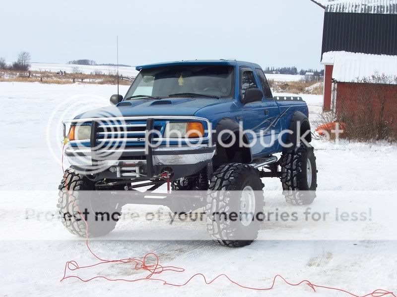

The steering

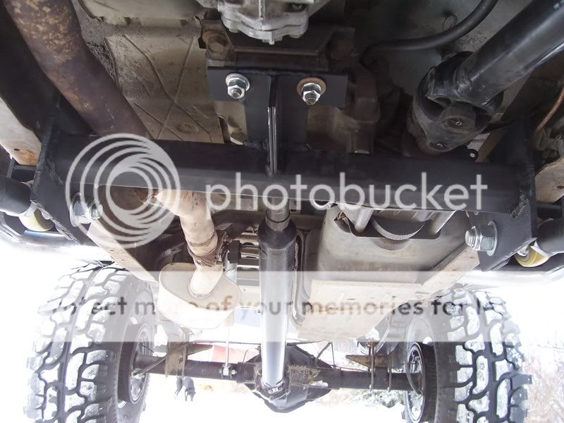

Crossmember to stop the nasty frame flex

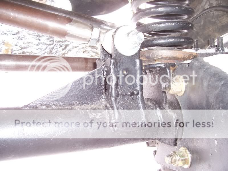

Finished axle track bar mount and RA setup.

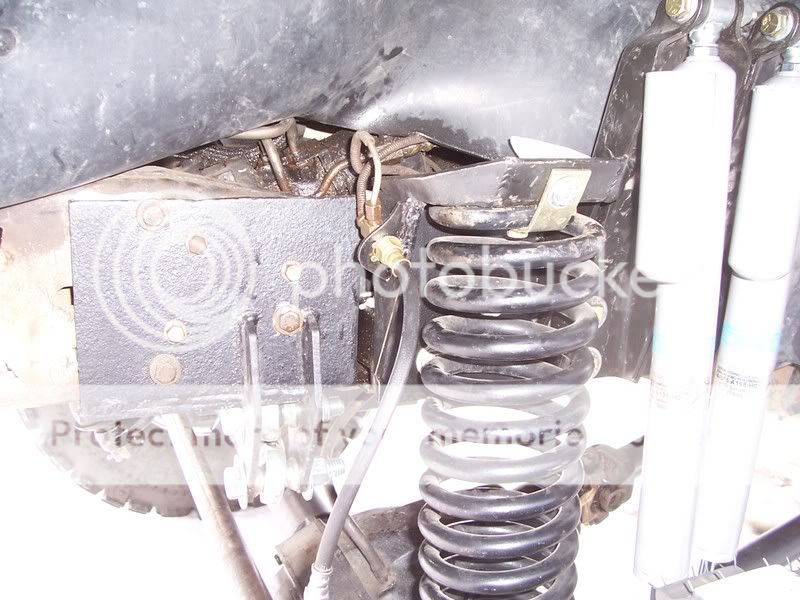

Finished frame-side track bar mount and upper coil bucket.

is it just me or is it leaning on the passenger side a little bit?
otherwise looks killer, lose the thornbirds and you'll be golden:headbang:
It's just the ground that it's sitting on. When it's on level ground, its actually about an inch low on the driver's side(like every other ranger). :icon_twisted:
The thornbirds won't be around for long.

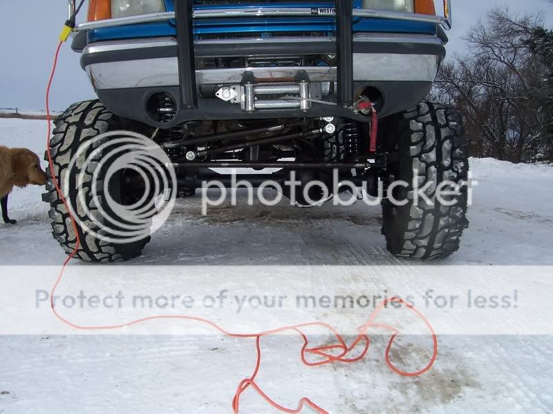

could you post up some pics of the trac bar setup? it looks like you have a link running across from the trac bar mount maybe as a brace? any way im interested in some more pictures of it if you got em. thanks
There's a rod end there, but I haven't been happy with any of the mounting locations. I would prefer to go across to the other frame rail for support but the steering box sector shaft and nut are in the way, and below that is too low. If I'd mount it back more, the stupidly large engine crossmember is in the way.
Eventually I may lose the engine crossmember in favor of something a bit more compact, like some thick walled 2x2 or 3x3. Now that the TTB doesn't rely on the crossmember, I don't think it's as necessary as before. The winch mount in the front also helps to tie the frame rails together anyways.

and so as of now the extra rod end is not being used? could you just run it to the engine cross member?

That's right, its not being used. The crossmember is fairly far back, and the rod ends would be at max angle in order to just barely hit the edge of the crossmember. It just doesn't fit well enough for my liking.

Just ordered a rear truss from BTF. Should work perfect to add the antiwrap setup to. I don't think I'll be doing any hard wheeling until that's on. Without it, things will break. The axle wraps down in reverse bad enough that I can feel and hear the yokes hit. :eek:
I also found out after the alignment that the rear housing is slightly tweaked. Looks like I'll have to replace it with my spare, which is going to be a bit of a PITA. There's no sense gearing/locking/trussing a housing that's pooched.
