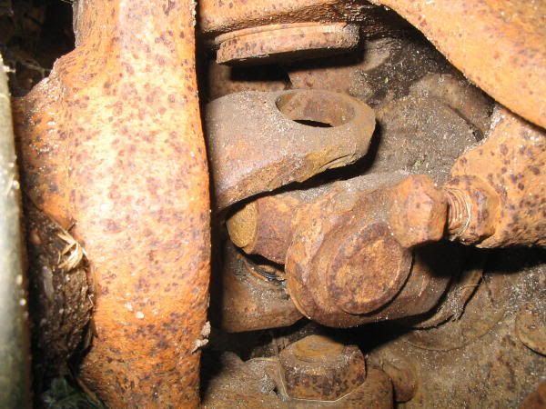

Well last Labor day we knew that I broke an axle joint in the DeRanged Mudder. When it happened I was sure it was much worse, I yelled out the window "broken diff". When we got it out of the mud we saw it had a broken joint. "Oh, is that all". I finally got time to work on it. I pulled the axle and installed a new joint. The axle would not go back in! I shined a flashlight in to the axle tube and saw that the side gear was halfway down the hole. "Oh, That can't be good".
I haven't found a large piece of the main pin, It must be up between the pinion bearings.
I don't have any spare parts so I'm done for a while. I will have to run the 'frog instead.

I'm confidant that the 44 can hold up in this truck, just not with a Trac loc.
I can't afford a good locker much less a D60.

I've seen an HD44 hold up to a built 460 with 38s. I know that the little 44 will hold up to a 351c and 33s. The trac loc is just too weak. I just need to figure out what to do next, Open? Lunchbox? Welded? If I could find a good deal on a GOOD posi and gears I would go for it.
