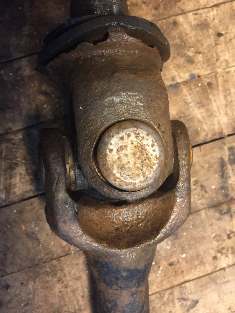

Well the right axle is fully welded, here’s the driver side I just pulled out.
52284
As you can see, the clip is still there, but the hole is egg shaped and the cap is flopping around loose!!
Was out last night for a test run, about 10kms from home I came across a water crossing about 3-4ft deep. About 500ft long. Locked the hubs for the first time since putting the right axle(and bearings) back in. Went through np, turned around and came back through it then when the wife bypassed it I went through a third time. Unlocked just the drivers hub and Went another 300m and heard a clunk, clunk, clunk from the front end. Unlocked the right one and headed home with no sound. There’s a paved road we have to cross so while waiting for the wife I jump out and locked the driver side and pulled ahead 3ft where it locked up solid with a metal on metal clang. It even sprung the truck backwards when I hit the clutch. Drove home unlocked, no noise. Got to the garage and locked it up to test. Low, reverse, low, forwards and back, no sound??? Went to bed. Jacked it up today and all I can find is the loose cap....

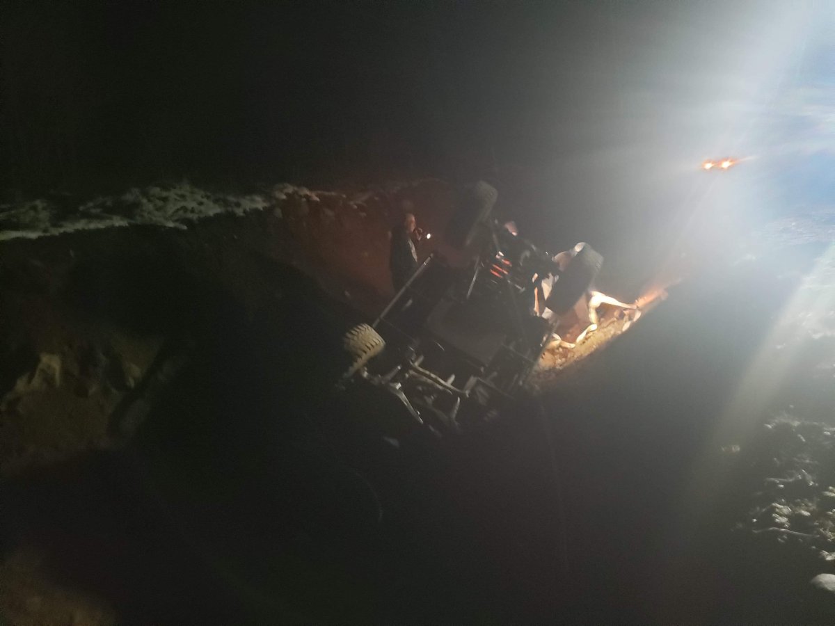

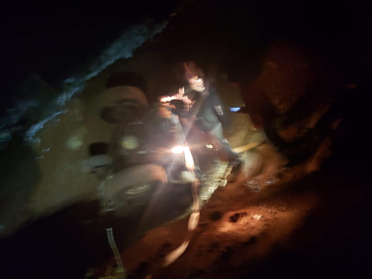

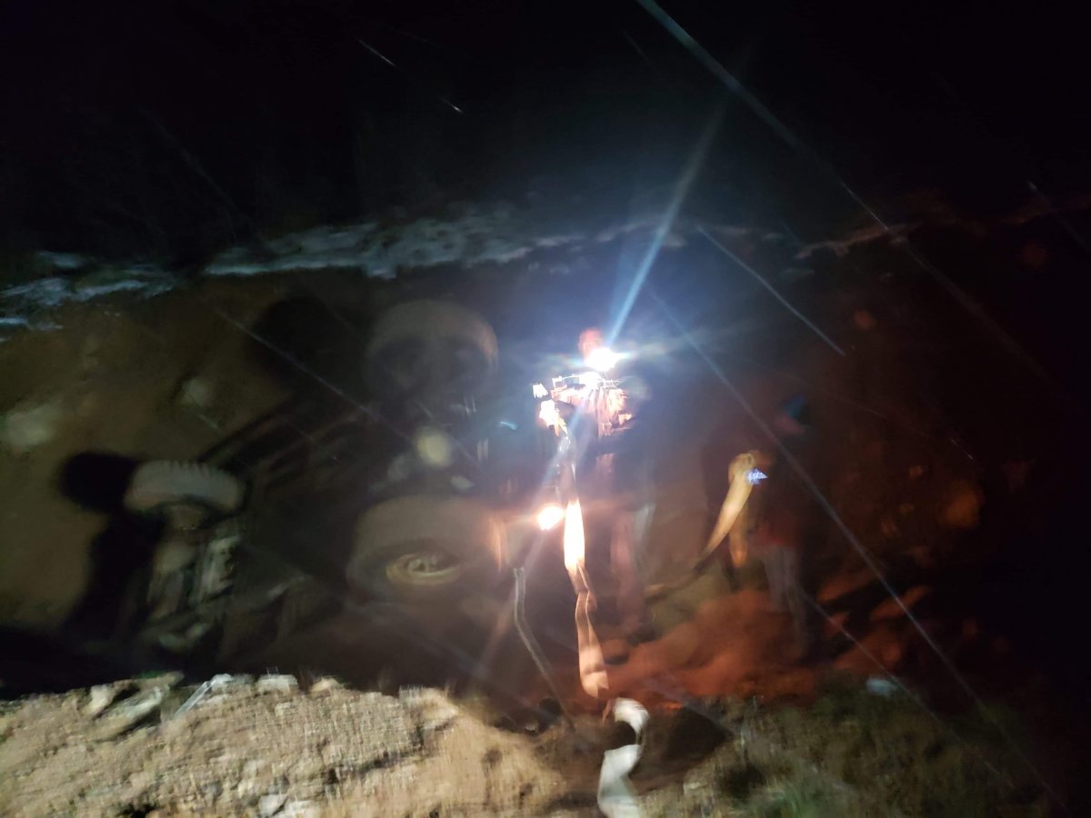

Well ****... again, too much throttle and not enough common sense. Rolled her AGAIN!
Showing off, jumping 8-10’ in the air, went into a ditch upside down. Hurt my leg and the chainsaw came from the backseat and got me in the head. The 21 year old hottie broke her front tooth too damn it.
Me and the “when in doubt, throttle out”, damn it!’
Leg is really sore too.
