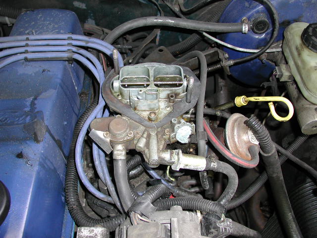

I had used the D port head with an older O port intake and carb, but it had to go due to the way it was set up with emissions...and the fact that it was a POS...I went with the Motorcraft 5200 as in the pic below...this was off an 78 Mustang II with a D port 2.3...worked out very well...the pic is of the original head I had without the roller cam...but it had a mild racing cam put into it...did actually make a slight difference, but the bottom end was the 2.0 and it wasn't good...the hose sitting in front of the EGR was to carry off the foam that was building up due to blow-by...it worked for a bit...:)
