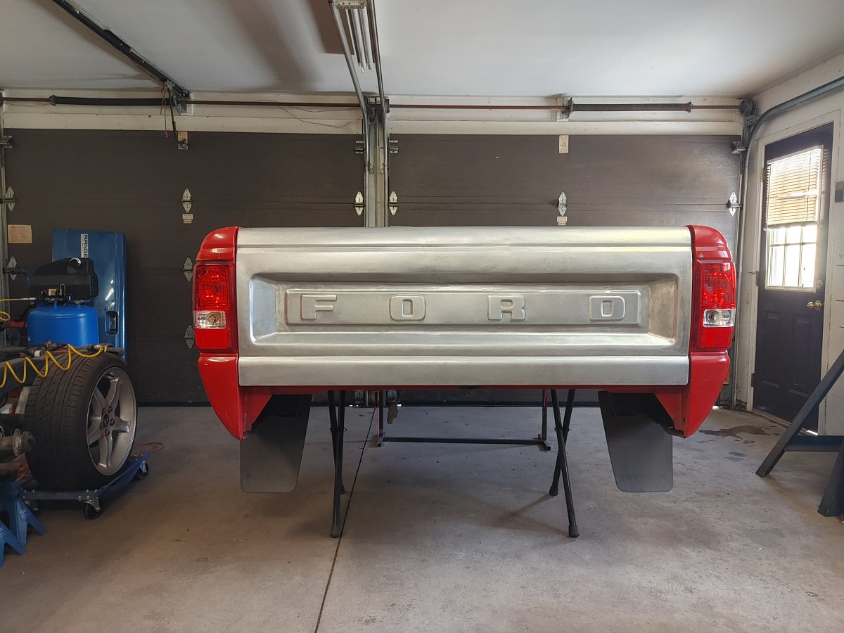

Working on a custom tailgate for my ranger where the older gen Ford stamped skin is grafted on a newer gen tailgate. Ive seen it done by a couple members on here before but the first time I saw it was on Pasquals Sema show truck. Loved it as soon as I saw it and figured Id make a thread on how I do it. I also have some videos coming Il update the thread which go in detail on the process. Anyways below are some teasers.

I was thinking....vise.....extendable to carry more stuff....or some sort of stairway or ramp system to load a quad or dirt bike.....
But...this is good. Not common for these.

Thank you! I always liked the old style tailgates
Finished off the metal work on this tailgate, Il start bodywork and paint closer to the summer.
