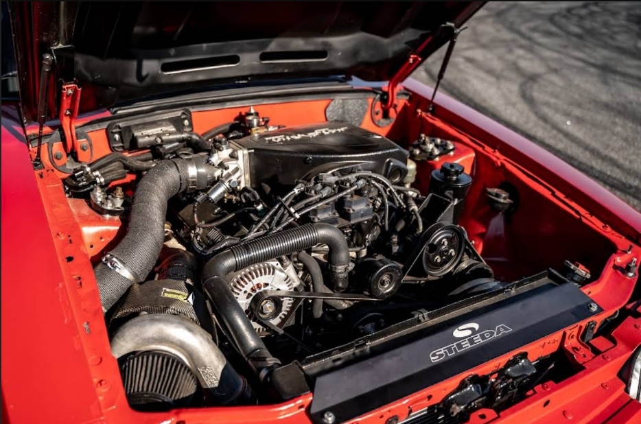

i see some of the advantages of what they did. But the why I'm missing when there is a million other options.

Picture posted on YouTube by steeda.

Turbo does as turbo dooooz
Forest for the trees....
Exploder Accessory drive, water pump, alternator, coil packs, looks the same as a explorer ecm, power steering pump.... looks like explorer ac pump
Mechanically about as close to a bolt in swap as you can get, you dump the garbage TFI distributor and gain a tuneable somewhat modern EEC, you get a very compact accessory drive setup and they still have decent flowing heads.

@adsm08 how did you ever figure out a 97 4.0 power steering pump worked with a recirculation box? How do I determine what power steering pump I will need with a 92 fox rack exploder wise?
Use any pump you want.
