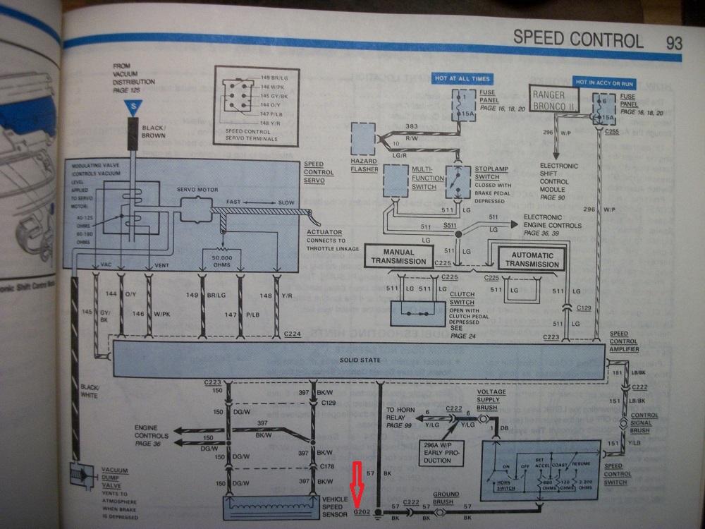

Noted that "grounds are good"; specifically check G202 which is shown in the pages included. Make sure that the Lt Green brake input wire at the cruise amp is operating right: +12 volt brake on, and it HAS to have ground when the brake is off.

1988 EVTM cruise control pages follow; good luck!
