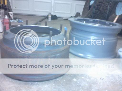

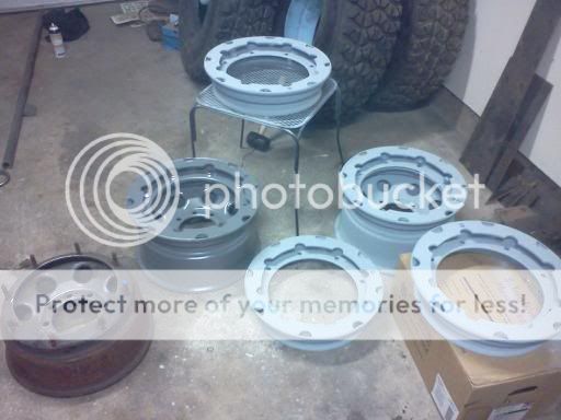

Wish I had access to a blasting cabinet and a paint gun, sure would speed the process up, takes a bit of work to go from start to finish on the wheels, the shipping company lost my o-rings and valve stems so i am waiting on those.

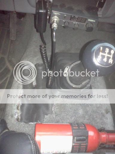

Put a boot on the doubler shifters, not fancy but it will keep out the heat and the noise.

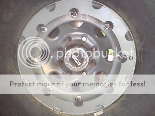

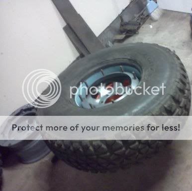

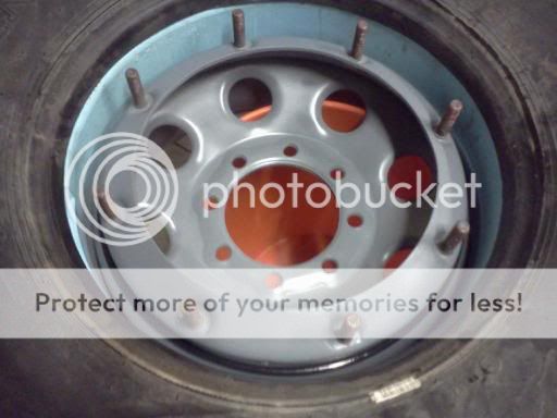

finished the wheels up and got them assembled and aired up
Crawlin's Build Thread
I went with lightweight pvc inserts over the magnesium or rubber runflats that are used on the Humvees but the tire and wheel combo is still quite a bit heavier than my old 33"s on black steelies.

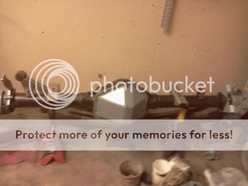

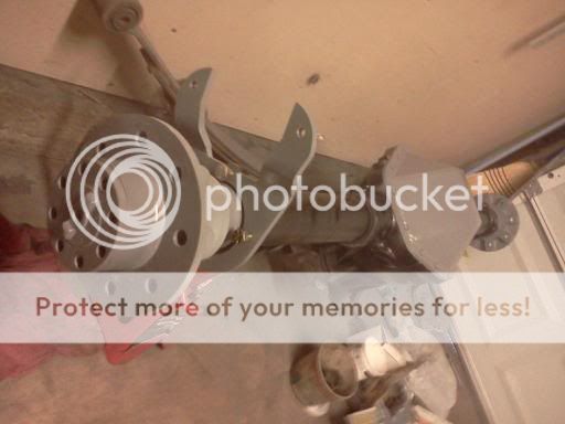

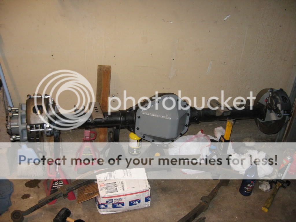

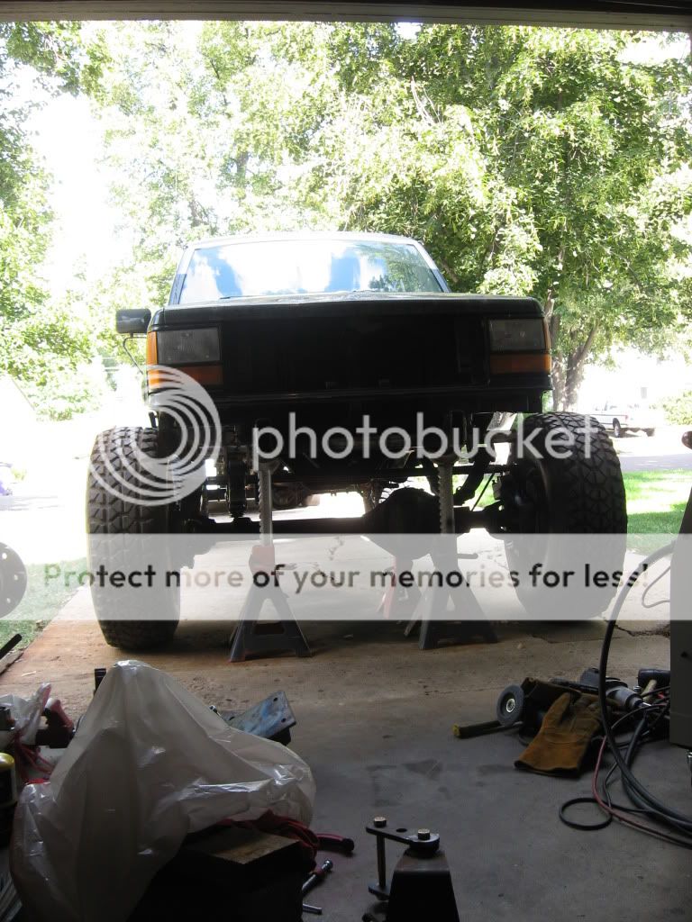

Then I focused on getting the rear axle ready to install, my plan is to have the SAS done by next weekend and roll it in the garage to do the rear axle and body work.
Axle primed

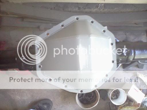

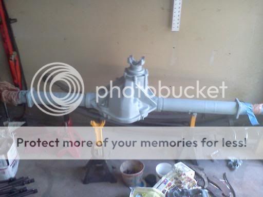

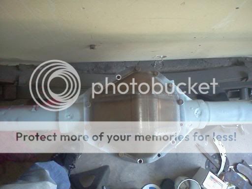

Shaved diff cover to match housing.
Laid down some paint

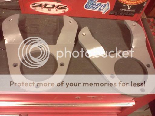

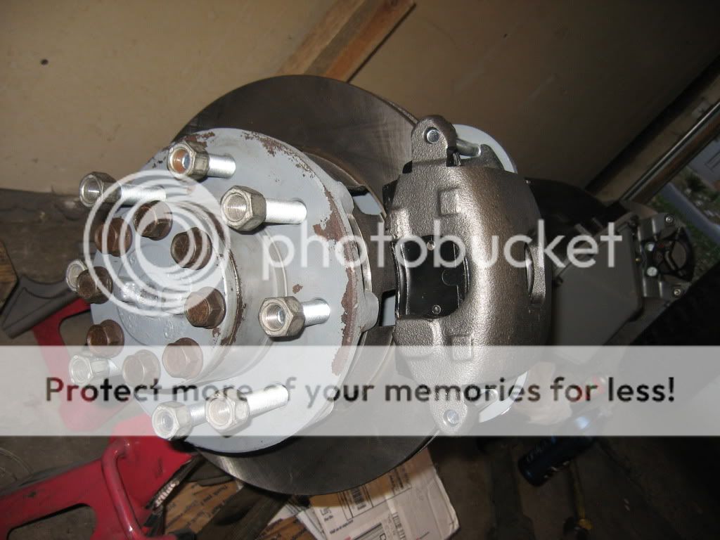

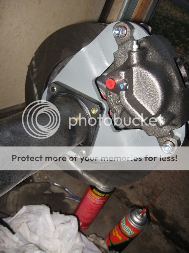

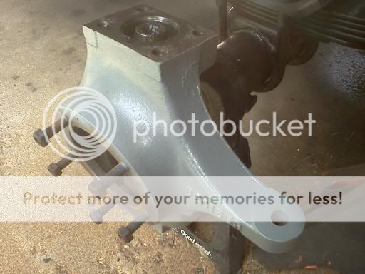

new ruffstuff 14B disc brackets
still need to install studs and brake parts

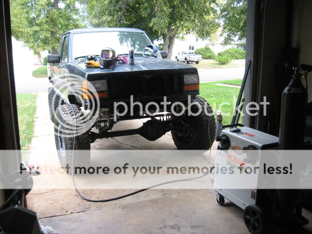

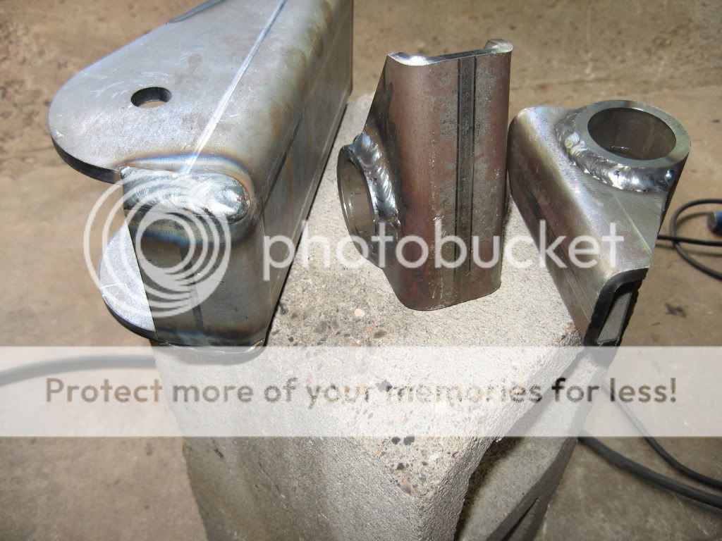

started boxing in the frame, ran a new crossmember/spring hanger .250" DOM, and did some plating

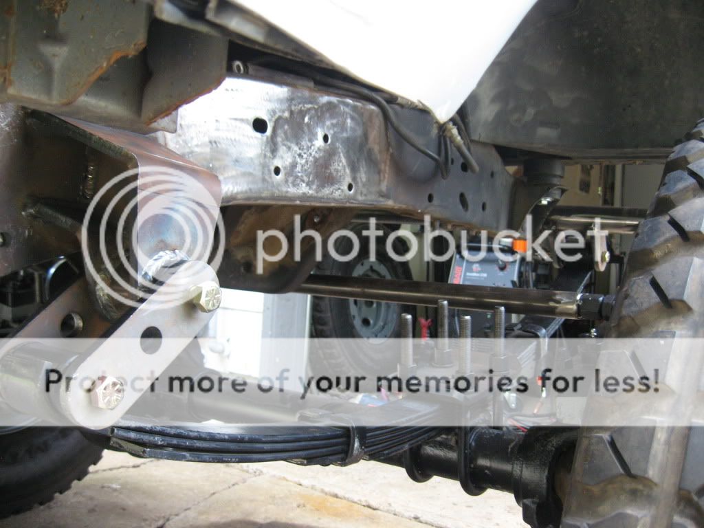

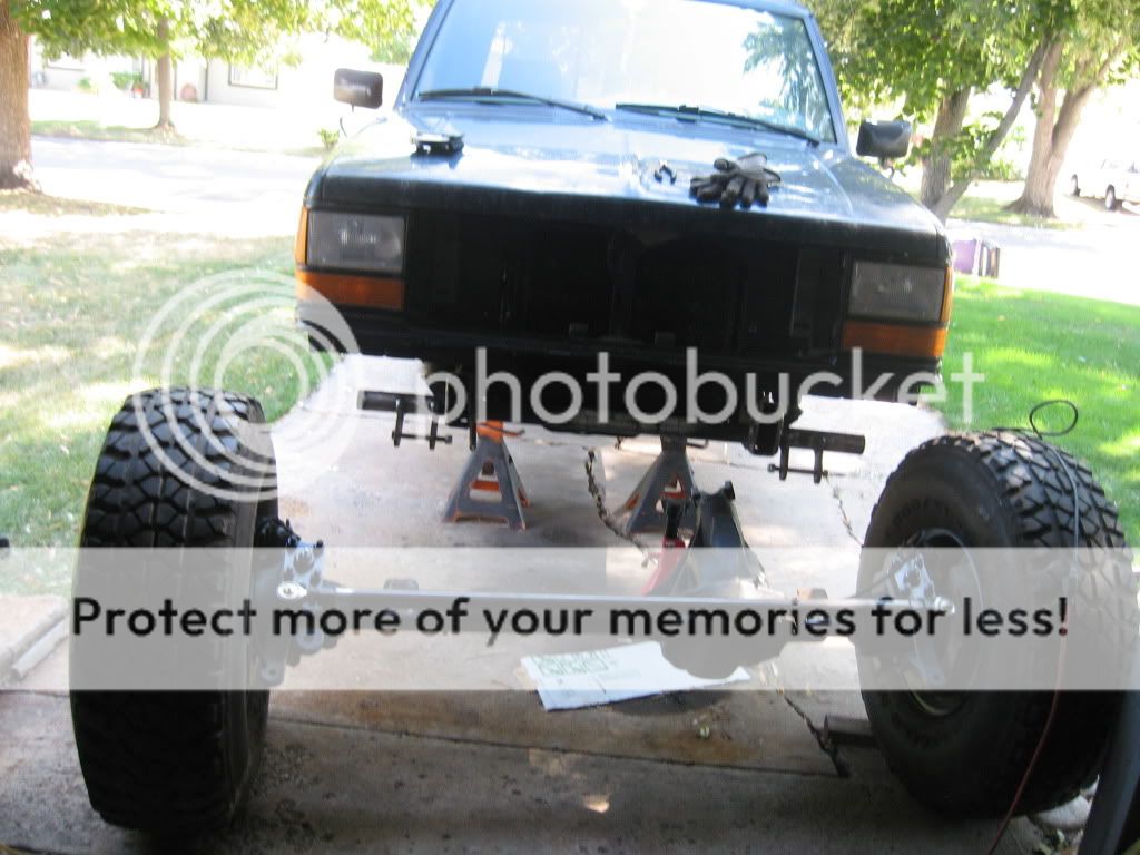

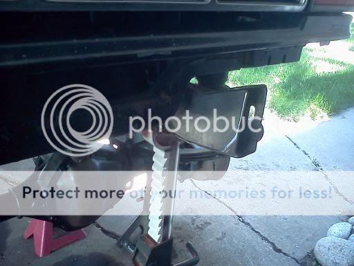

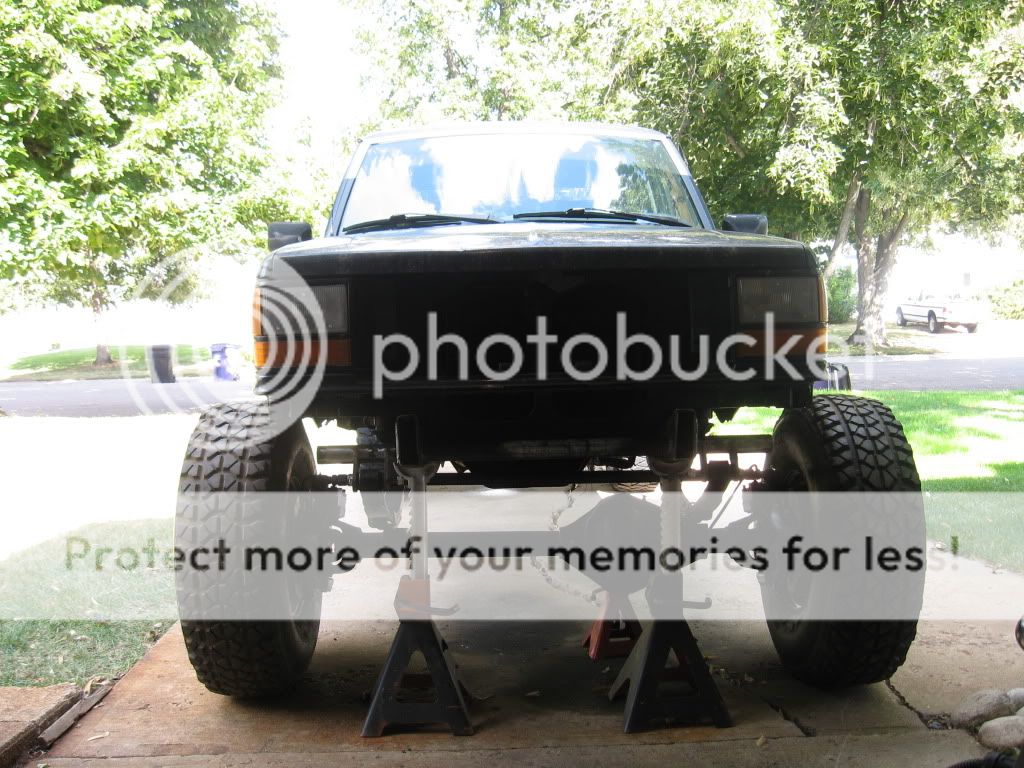

the front axle has been moved forward quite a bit, I will need to either move my steering box or maybe use a Yota box, etc. Doing this sounds like a bit of a headache, piecing together a box/pitman arm setup, reaming the arm, making the frame mods.I'd like to go with a single ended ram full hydro setup if I can piece it together relatively cheap, we will see. I pulled the front axle out to move the shackle hangers, looks like I will have to get creative with the cab mounts because it is going to be pretty tight in that area. I have some ideas to strengthen the spring hanger as well but I will wait untill I have the axle permanantly in place to do that.

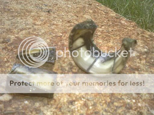

id just install the u bolts then cut them after. that way when you take the nuts off it cleans the threads. ive always just used an 4 1/2 angle grinder
Yep. That would be the easiest.
Sent from my HTC using Tapatalk

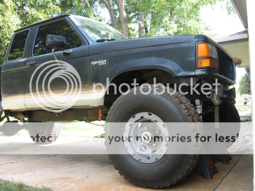

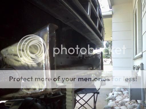

Front axle is in, I had to cut off the middle cab mounts and fab new ones.

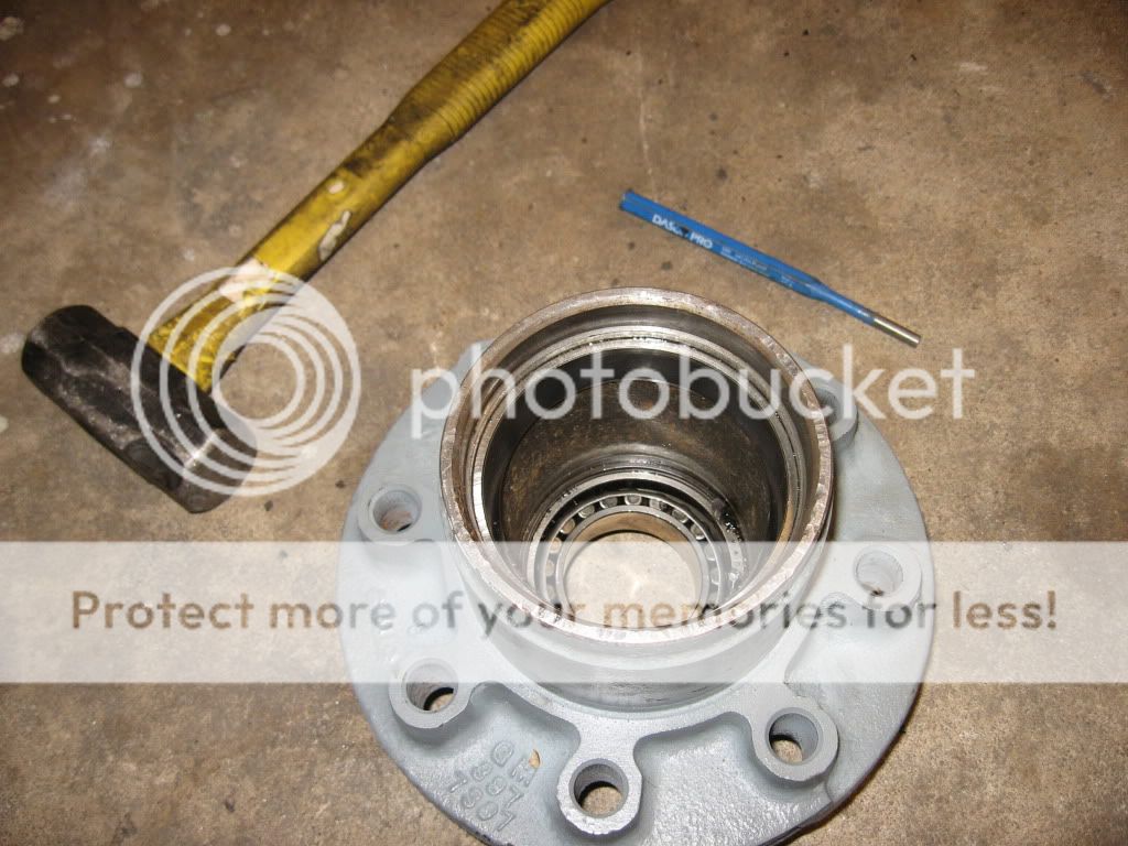

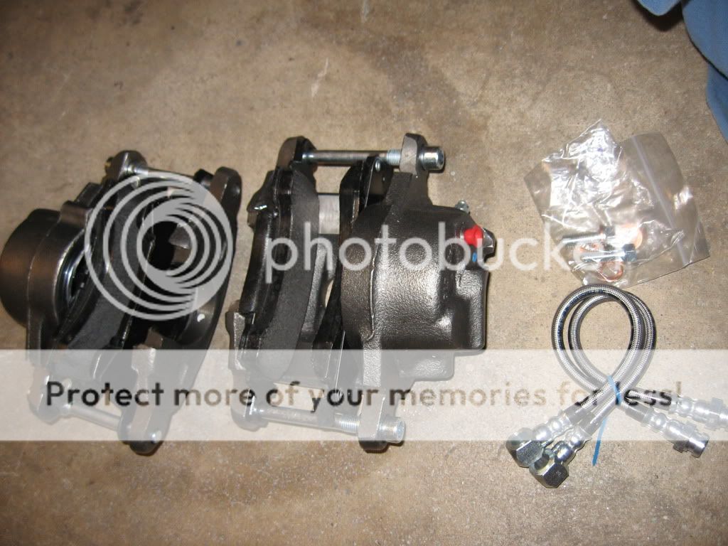

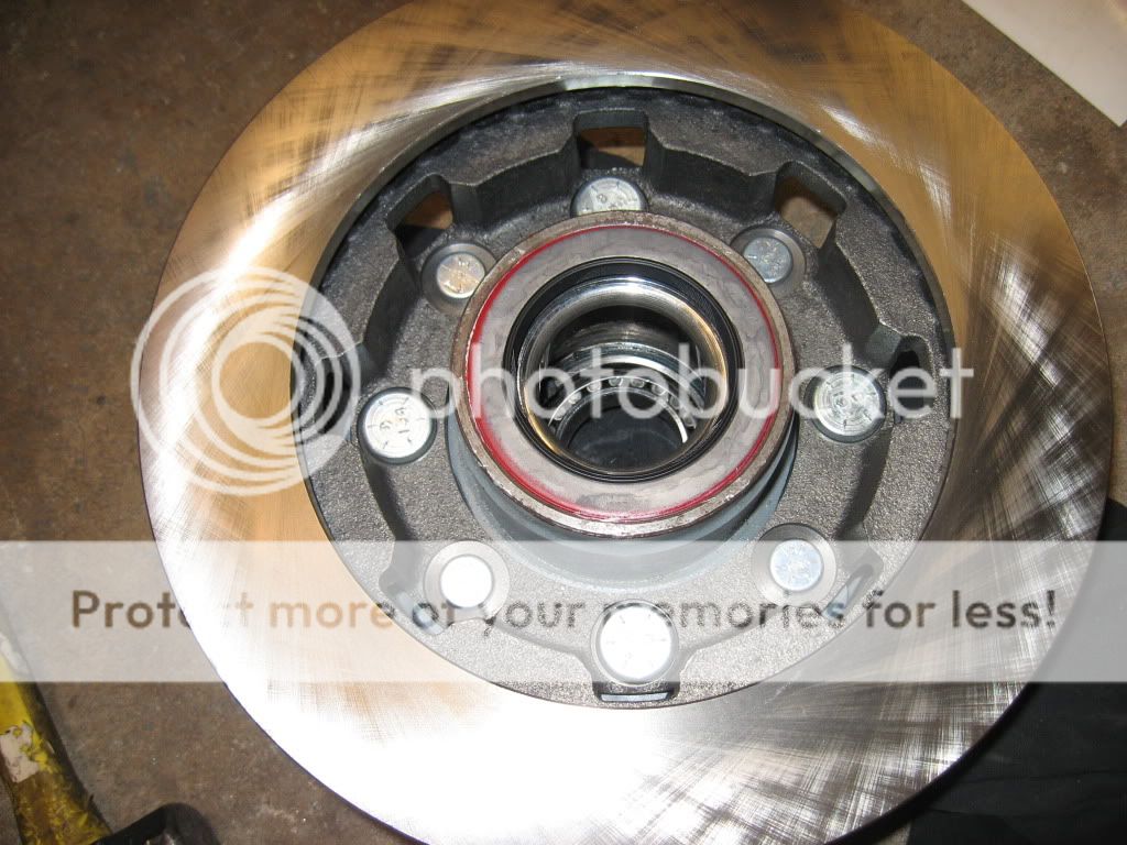

Installed new bearings, races, and seals in the 14B hubs, also got the disc swap finished.
Installed new studs, set wheel bearing preload, put the shafts back in and just need to run the hard lines and the axle assembly will be ready for install.
