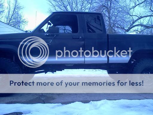

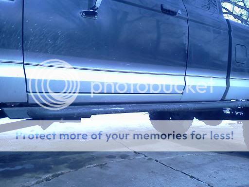

little update, I yanked the sliders off, they hung a little low for my liking, then I cut the rocker panels out through the fender, will redo them when I get some materials. Gained alot of clearance.

This is right after making the cuts I had to pull the front fender back in so it didnt hang down/out like that.

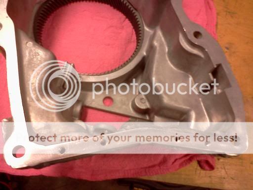

Front case welded inside and out, then machined flat for a good seal. the plates were about .150" too tall before would have caused problems.

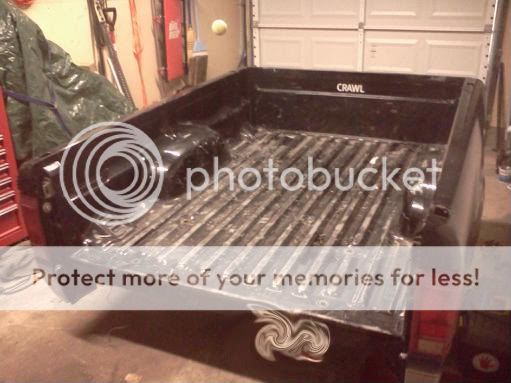

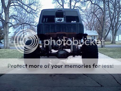

pulled the bed to make things easy, going to relocate the axle and do some choppin:icon_welder:
