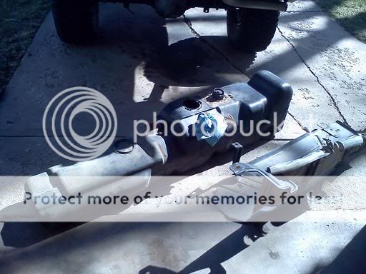

dropped my 30ft long gas tank and 20+ lbs of skid plate out from the truck

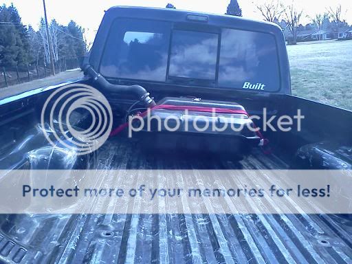

the newer BII tank is in, no leaks.
ye olde submarine gas tank:shok:
temp hold down untill I make some straps. only put 4 bed bolts back on as it is coming off again shortly

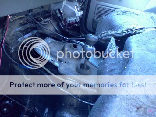

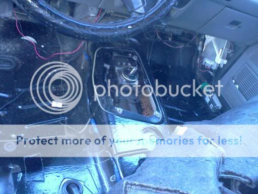

Sorry for the slow updates, trying to do a little every day to stay on track. I pulled back the carpet and started mockup, going to have to notch the trans tunnel a just a little bit. Also these OE knobs are kinda bulky and rub, Ill have to bend the shifter rods apart or use something different. No heims yet so no linkage pics.
