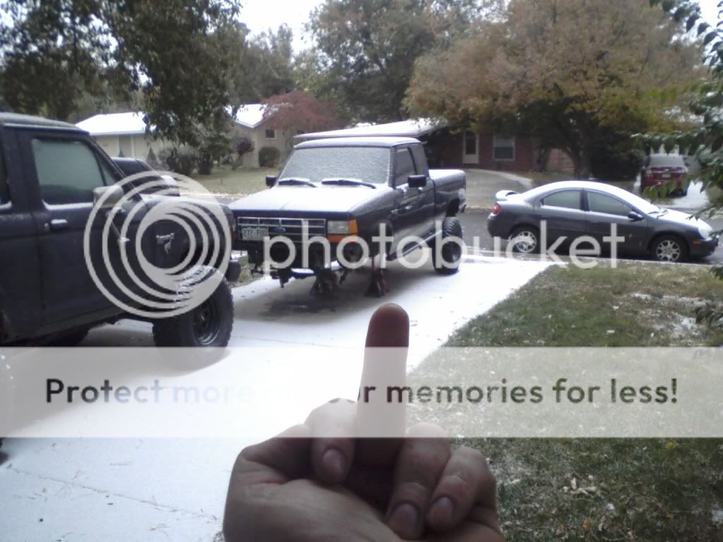

Finally getting to some much needed front end work. Lots of nice surprises including the weather.:pissedoff:
need to get a MAPP gas torch today to help with stuck radius arm bolts. The lower radius arm stud inside the drivers side beam snapped off and now rotates with the lower bolt.:buttkick: Im gonna try the sawzall approach to get it off, and luckily I have a spare set of beams I can use that already have duff pivot bushings installed.

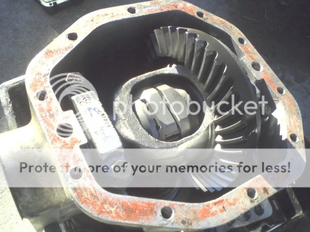

Locker installed, I was going to do it myself but couldnt get the carrier out without a spreader. Took it to the shop that set up my 8.8 (front range driveline) awesome work at unbelievable prices been nothing but happy with these guys. There is usually some cool drag cars and buggys in there to check out too. And as all the threads on the bottom of the center chunk were stripped i installed helicoils all around, I had a scary moment when threading in one of the helicoils it got caught about halfway on a shard of metal in the threads and bent the tang making it nearly impossible to back out. After some choice words and a very careful ten minutes with the pliars it was out. I redid the threads and put a new one in its place.

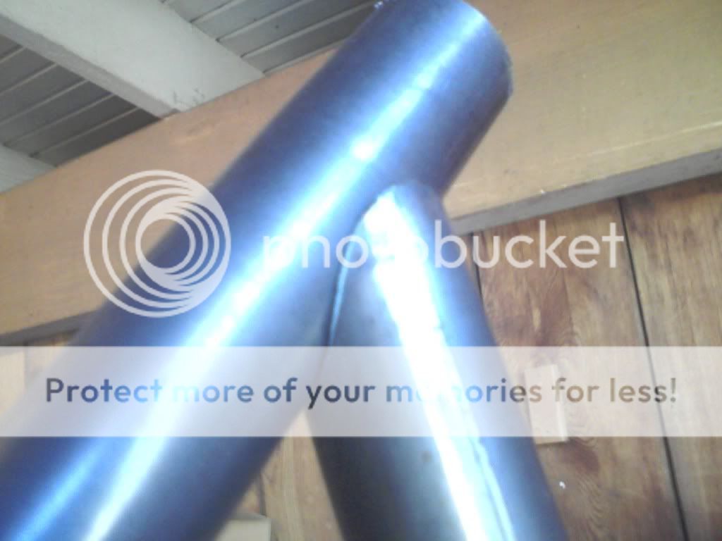

So I finally got to work finishing the radius arm setup.
materials used 1/4 steel plate
2" 1/4 wall DOM tube
grade 8 bolts
first I cut the threaded end and what would be welded into the DOM tube then made a cut again where the 2" tube would just squeeze into the stock arm.
