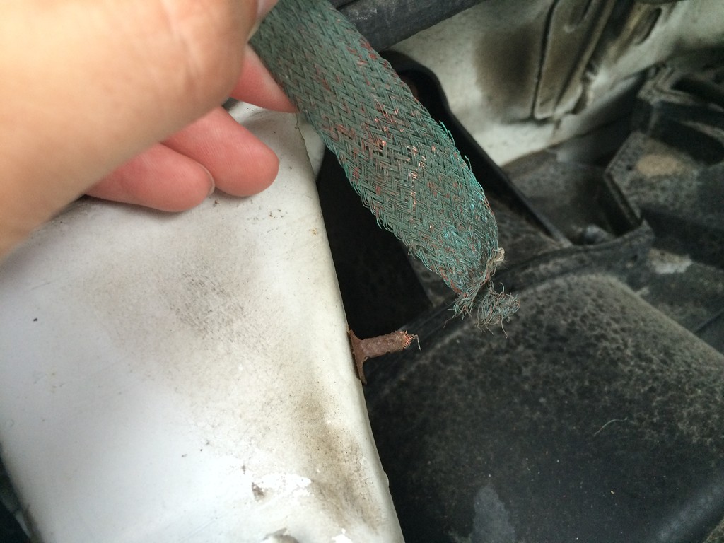

I also found what I believe to be broken copper braided grounds. This one connects the hood to the body around the engine compartment. I found two others on each side of the vehicle, on the frame. All are broken. I'll fix all of these too by soldering new thick wires between the contacts after removing the broken copper. Can these cause problems if broken? I have noticed at least one broken before on the hood.
I'll try to fix all of these wires, and any more I find next weekend to see if it fixes the blown 30 amp PCM fuse issue.

The grounding strap on the hood is there to prevent radio frequency interference. The truck will work perfectly fine without it, but you may here a little more noise coming through the speakers.
The ground straps from the frame to the body can cause many issues, including, dim/ non-functioning/ always on lights, static discharge every time you touch the door handle, instrument cluster malfunctions, power windows/locks slow or inop., etc... They should be fixed, but they generally don't cause blown fuses. Dead shorts cause instantly blown fuses. I don't have a wiring diagram for a '97, but that 30 amp fuse most likely powers more then just the PCM. Get a wiring diagram and follow the circuit. It will lead you to any and all places your short can be.

I inspected all the wires I could find, and I believe I found the culprit that started it all. The wiring harness to the speed sensor in the transmission has an issue where the two wires were both partially cut/ripped near each other, and both also have some fluid (I assume tranny) running down them, so I believe this sensor was shorting out, which explains the weird transmission hard shifting, and the check engine light also would very briefly flash during these episodes. I cleaned off the wires, and wrapped them in waterproofing tape, and so far the issue has not come back. I ordered a new wiring harness to replace the old one, as the wires are cut almost to the clip so it would be hard to splice new wires in. I'm not sure why it has a small leak there either, perhaps I should just replace the entire sensor along with the harness.
