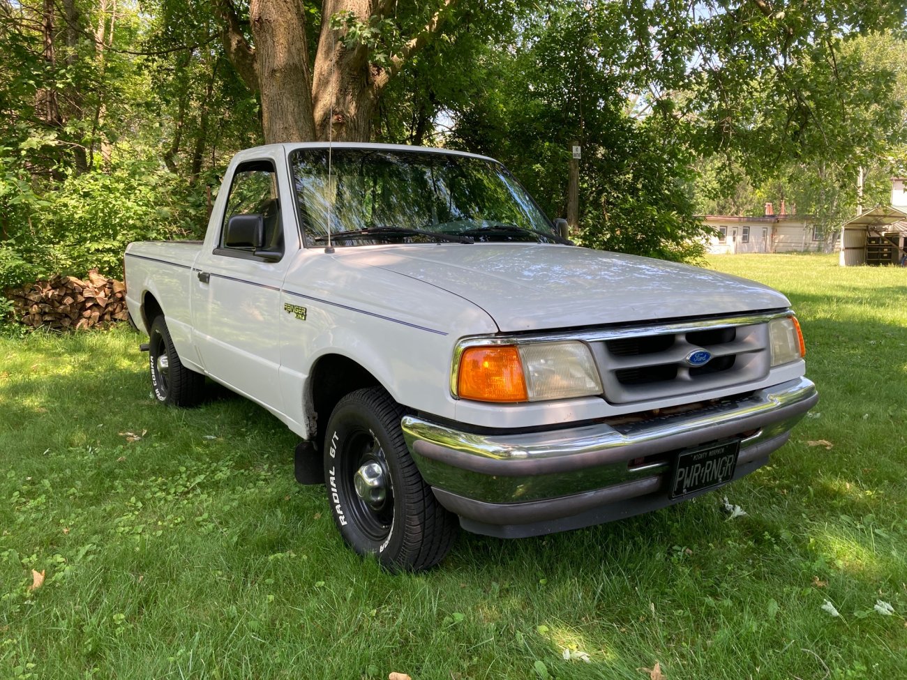

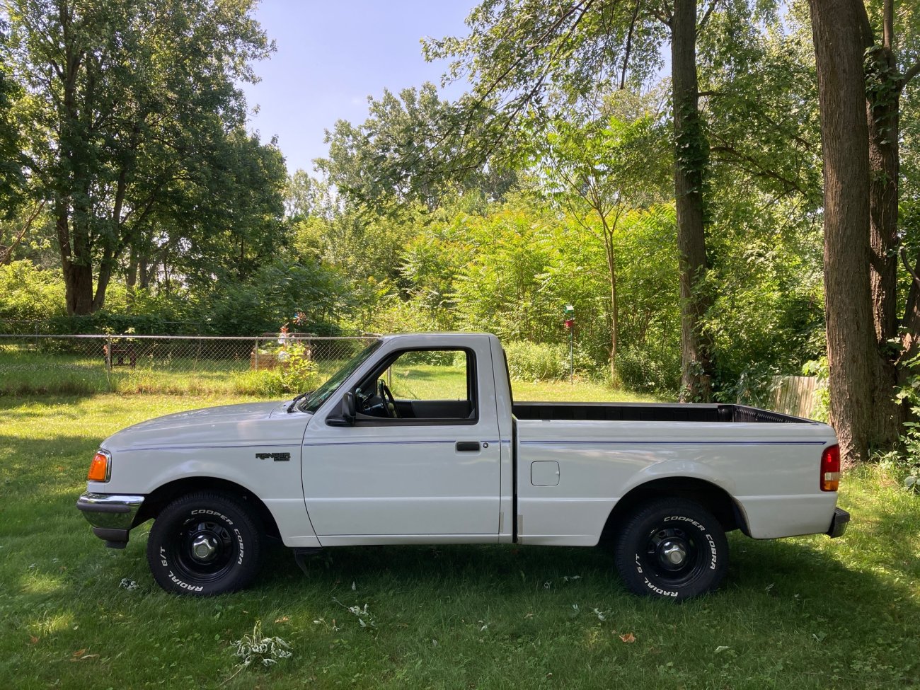

The fuse blew once while driving which stranded me, and kept on blowing (on crank) on the half a dozen or so replacement fuses during troubleshooting after I got her pulled home when I was dealing with that years ago. The truck sat untouched for 2-3 years at a horrible shop that kept putting it off, then after putting in a new battery and alt at a better shop I towed it to (the one that most recently worked on it), she came back to life without blowing the fuse but it still had the issue in hot weather going over bumps etc. I drove it for years, trying various things to fix, including replacing grounds, etc. Very strange! I'm grateful it seems to be fixed now, as I love driving this truck. I've put more than she's worth into her over the years because it's special, and I expect it will serve me well for many more years to come. I even put full coverage back on it because of how horrible some of the drivers are in my area (and too many deer). I attached a few recent photos of her.
