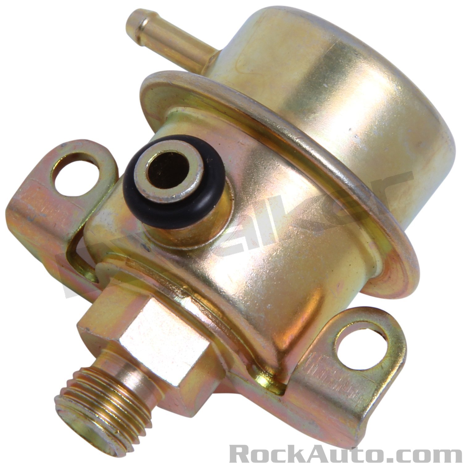

@93ranger4.0l , since it starts on starter fluid, 35 psi on the fuel rail is too low for the 4.0l OHV:
• check for leaks
• fuel pressure regulator
• injectors
K weres the regulator 2 i think it's a leaky injector
Regulator is on the fuel rail.
Is it under the throttle body
IIRC on the driver's side near the back. Between the upper and lower intake.
It'll look like this:
The threaded part will have the fuel line on it. The o-ring part goes into the fuel rail, and the smaller fitting has vacuum.
Often when they go bad they'll leak fuel into the intake via the vacuum line. A leaking fuel injector would leak fuel into the intake on that cylinder. Pretty similar symptoms.

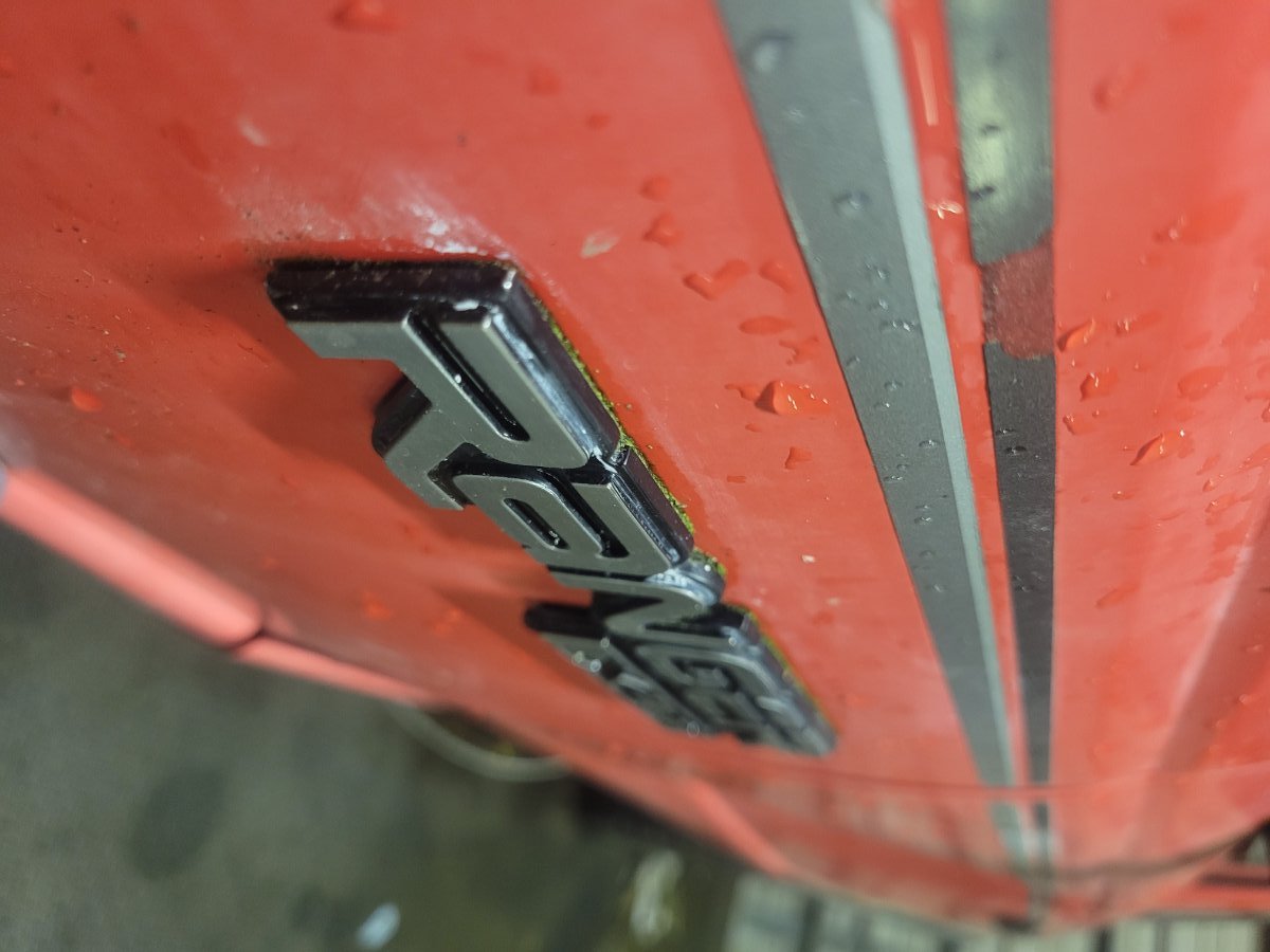

some one said that is a really good picture
