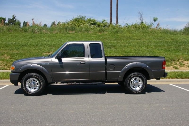

Has anyone tried to put a Gen 3 Coyote and 10spd in a 05 and up Ranger?
There is a guy on youtube who did it in a 89-91. But not much info on it from what I remember. It should be about the same as a 4.6
Definitely need to do some hacking to cram one of those things in a 98+ ranger. Never seen it done but would be neat.
