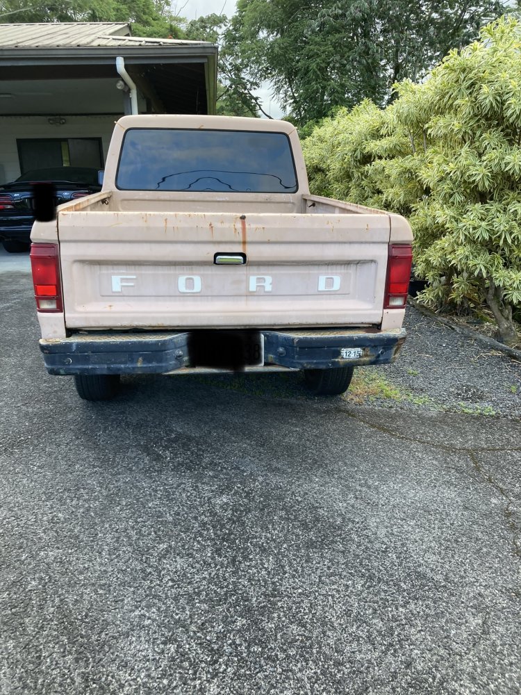

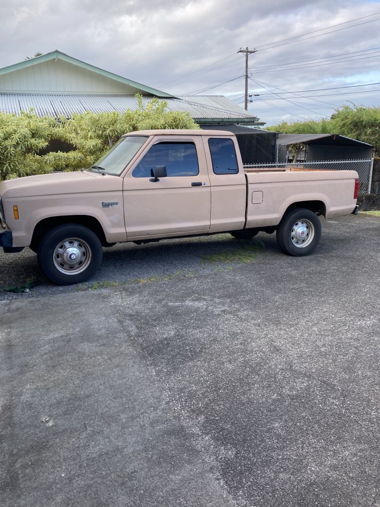

First time poster but I’ve been lurking around for a while lol. Decided to make a thread to document what has been done to the truck. I purchased the truck in may from my friend after I bugged him almost daily for a year. The truck had been sitting in a garage and hadn’t moved for a few years.

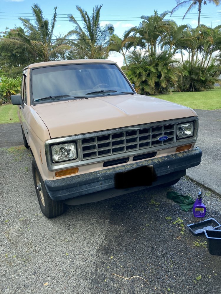

It’s an 88 ranger custom with 5 speed, 2.9 v6, 4wd, Ac, and 44k miles. Original owner was an older gentleman and my friend bought it off of him. I even found the original bill of sale in the glove box along with other original documentation. Prior to me purchasing it, my friend had changed out all of the injectors to aftermarket ones off amazon because the truck was running rough. Well after he did so, the truck idled better but it drove horribly. I just assumed it was from the truck sitting for so long and the fuel being old. The old gas from the tank was removed and it was filled up with Fresh gas and also changed the fuel filter. The truck still ran like crap so I ended up purchasing a set of rebuilt Bosch injectors off of eBay and now she runs nice and smooth. Here she is after I wiped her down with spray on quick detailer and super cleaned the rims.

Replaced headlights with leds (wanted a period correct look but even with h4 conversions and hids the spread of light was horrible. Not a fan of the looks but the have a nice clean cut off and produce a lot of white useable light)

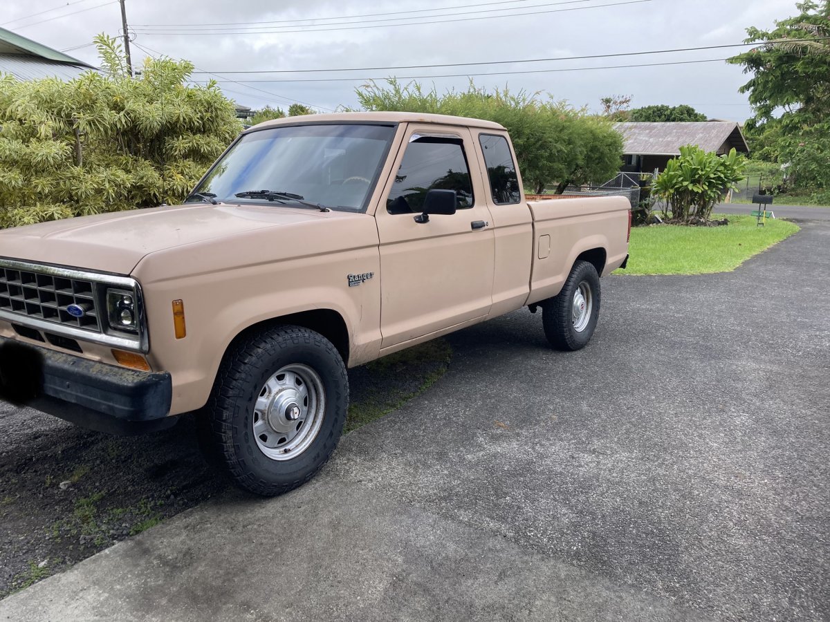

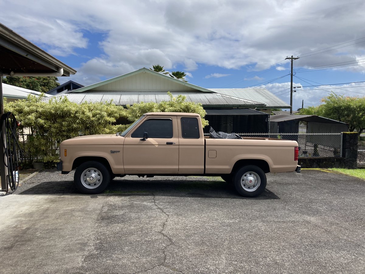

After driving the truck for a bit one of the tires began to leak air from the sidewall. They were all old and dry rotted. Checked Amazon and ordered 4 Goodyear AT tires size 235/76/16. Looks alot better than the old 205’s

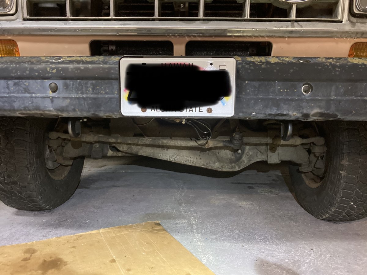

Because there are no tow hooks or recovery points on the truck, I removed the front chin spoiler on the front bumper and added a set of tow hooks to the frame. Also ordered a receiver for the rear of the truck.

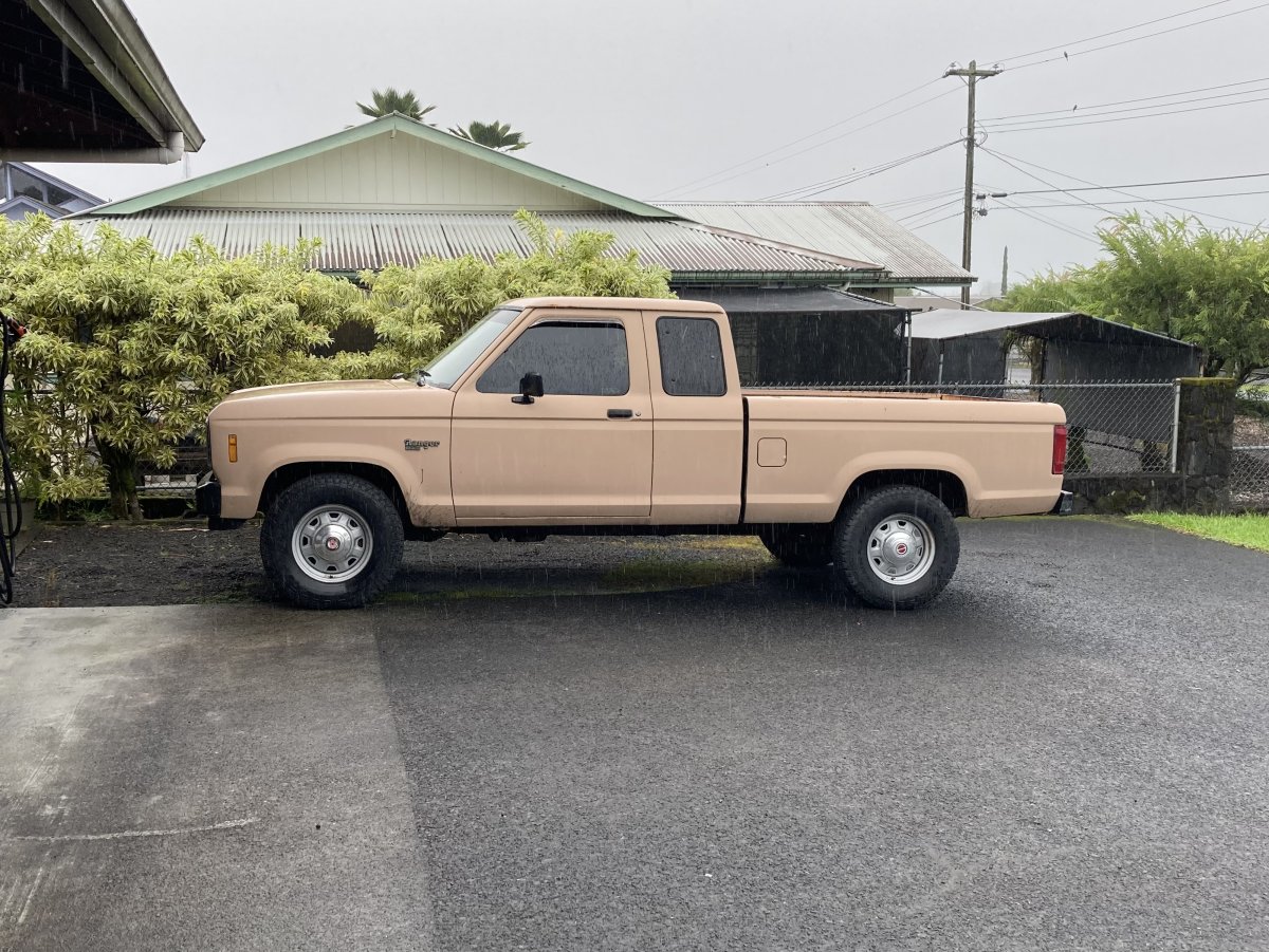

I also ordered a set of rough country leveling springs, adjustable camber bushings and new super lift shocks but im
Unsure if I want to do the lift right now. I’m kinda digging the look of the truck as it is. I’ll be sure to update the thread as I slowly do things.
That's one clean looking truck... I'm not a fan of the headlamps either. I would suffer through the performance of the sealed beam headlamps and add a set of old school DOT driving lights... if they can be had.
If you dig the looks of it now... leveled will look even better.
The factory wheels look awesome... Just a nice clean factory look. I'll admit... I'm a bit jealous... but not about the 2.9L. Just keep your eye on the temp gauge... they don't like to get warm.

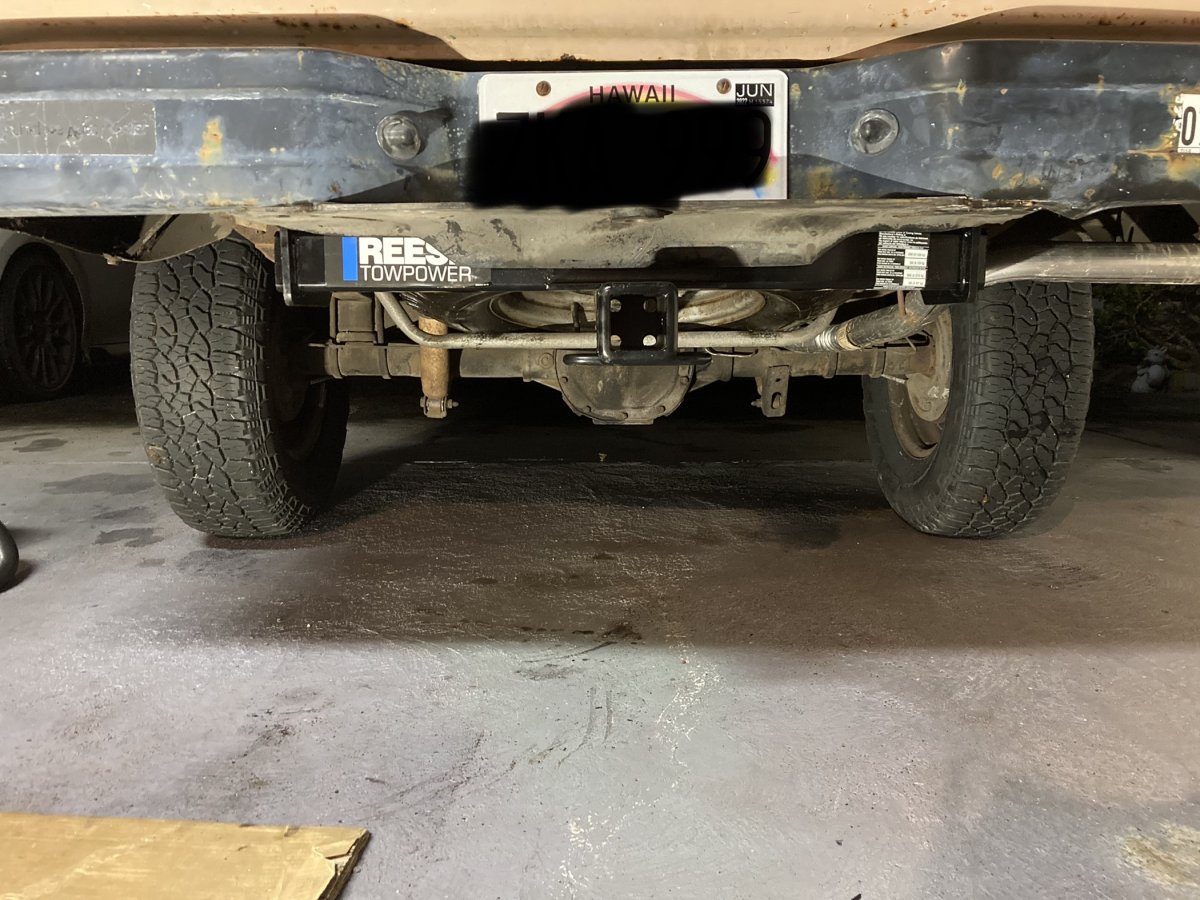

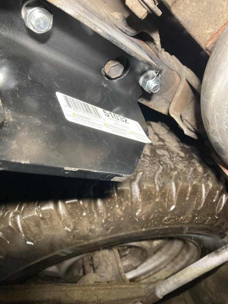

Got my Reese receiver installed tonight. I did have to drill two holes but other than that it was a pretty simple install.
You have to drill a hole for the bolt closest to the spare. Also if you install this receiver you need a 19mm open end to access your spare because of the lack of space.
