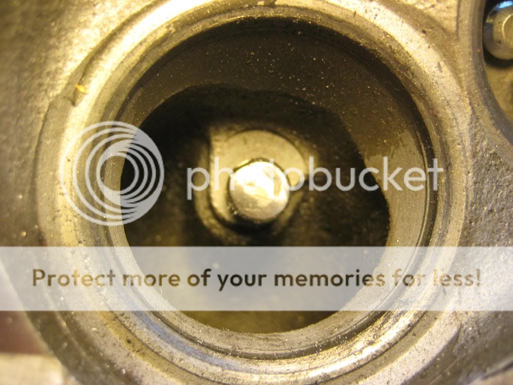

I just went for it, the ports as stock are UGLY and restrictive, very lazy looking at least on my '85 head :), here's a before pic:

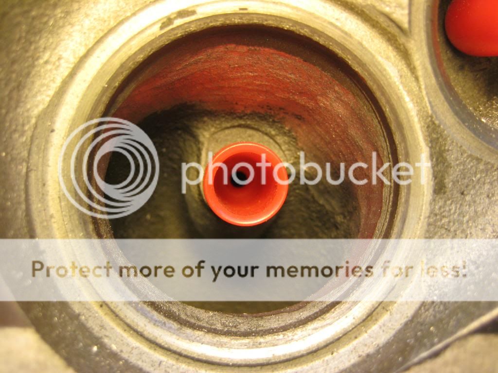

Here's one of the "after" pics I think:
These heads are known for having worse ports on the intake than exhaust, so spend more time on that side. If you look carefully you can see I smoothed out that lump, and the valve guide post thing, and spent more time and effort on the outside of the bend radius than the inside.
Thanks for the pictures! The Volvo b2300 motors also have same problem when it comes to air flow and the head.
